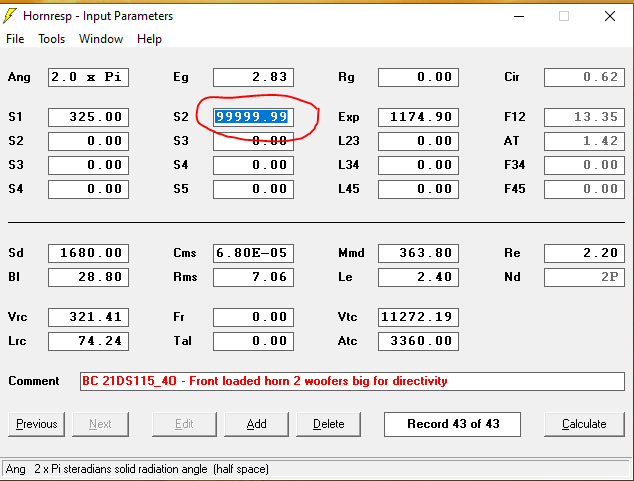

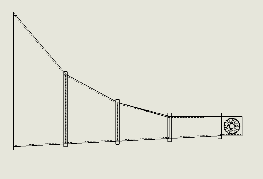

Is there a way to simulate larger horns than Hornresp normally allows?
If I want to use an area larger than 99999.99 sq cm is there a way to do that?
Can I change units to meters in some setting somewhere to get around this?
Or can I get rid of the decimals to use larger values?
I know it might not be common or even reasonable to build horns this large but I think from an academic point of view or just from curiosity "what if", it would be very interesting to not have this limitation!

So you want a larger mouth than 10 square meters? 102 square feet? For real? That would give you nearly ripple free response to under 20 hertz anywhere on the ground. With a little ripple you could do 10 hertz. Inside a building 5 hertz with a little ripple.
I have been looking at a in room corner horn that approaches the 102 square feet limit. Would be nice if the limit was a little larger.

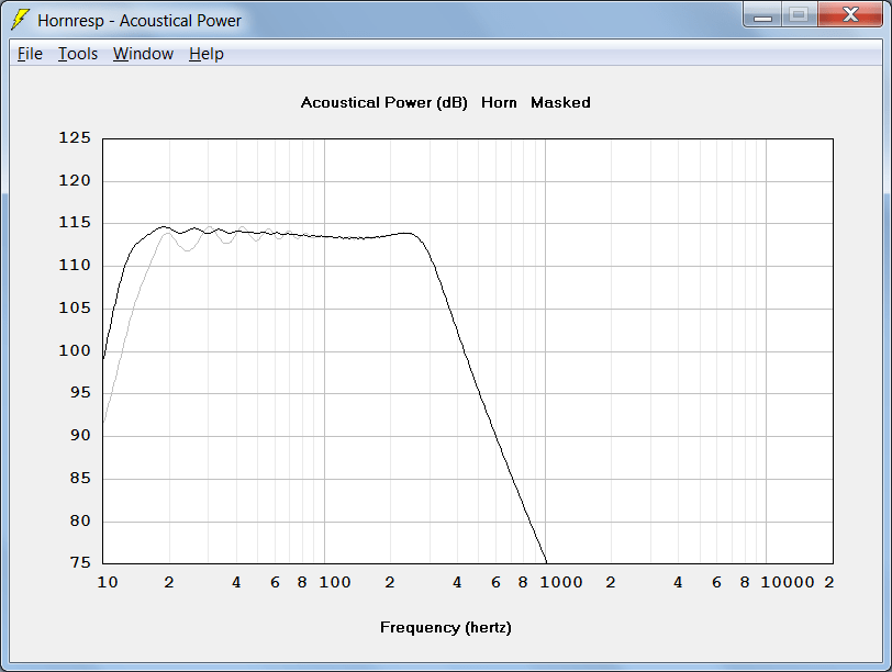

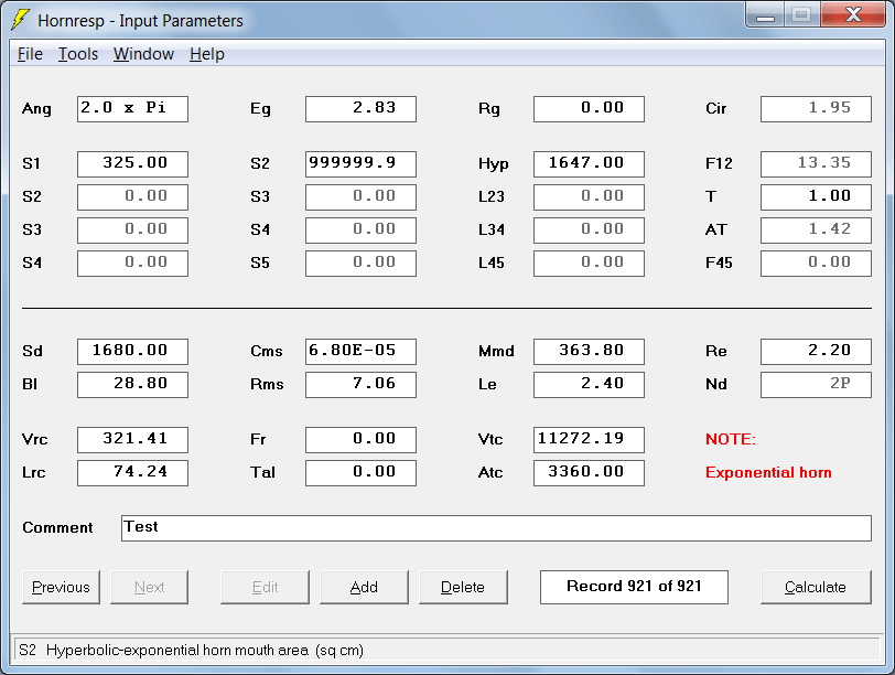

If the flare type is Hyp or Lec then S2 can have a maximum value of 999999.9 cm^2, meaning that the mouth area can then be up to 100 square metres or 1076 square feet.
For your Exp example (the same as for Hyp with T = 1), the difference in power response with a mouth area of 99999.99 cm^2 (grey trace) compared to 999999.9 cm^2 (black trace) is shown below.
Apart from S2 for Hyp and Lec single segment horns, it's not going to happen.

The compression ratio for your example with two drivers is greater than 10:1, which is really too high for a practical low-frequency horn.

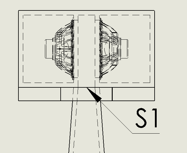

Ah! Thanks a lot for this input!The compression ratio for your example with two drivers is greater than 10:1, which is really too high for a practical low-frequency horn.
Do you have any tips or formulas for how to calculate a suitable compression ratio for a given driver in a given situation?
My plan was to mount the woofers in a force cancelling configuration creating a pressure chamber between the woofer before the air pressure enters the horn.
Is this a good idea? Am I simulating it correctly or do I need to add something to take into account the effect of the chamber between the drivers?
I'm not sure if I really want to create it physically. I would mainly like to see what kind of size it would take to get directivity down to 20 - 30Hz...So you want a larger mouth than 10 square meters? 102 square feet? For real? That would give you nearly ripple free response to under 20 hertz anywhere on the ground. With a little ripple you could do 10 hertz. Inside a building 5 hertz with a little ripple.
S2 = >1/3 of Sd.Ah! Thanks a lot for this input!
Some thoughts here: My approach to bass horn designAh! Thanks a lot for this input!
