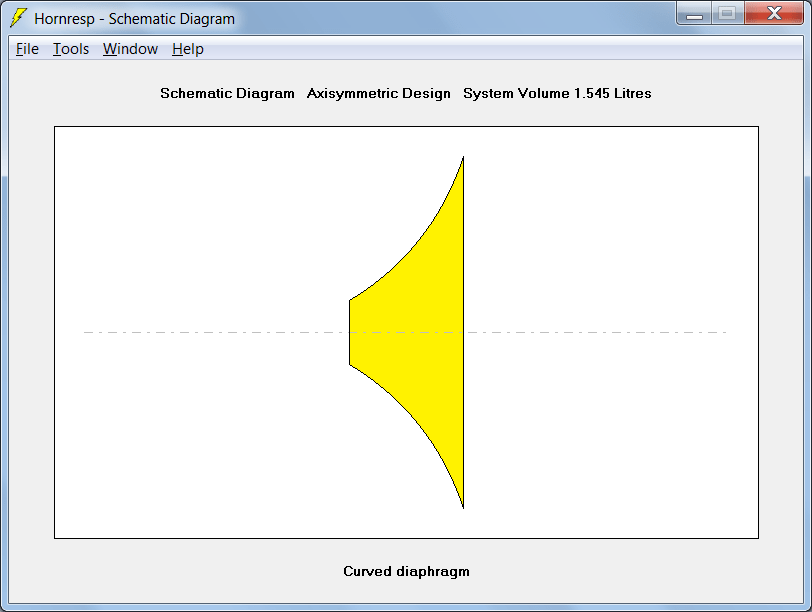

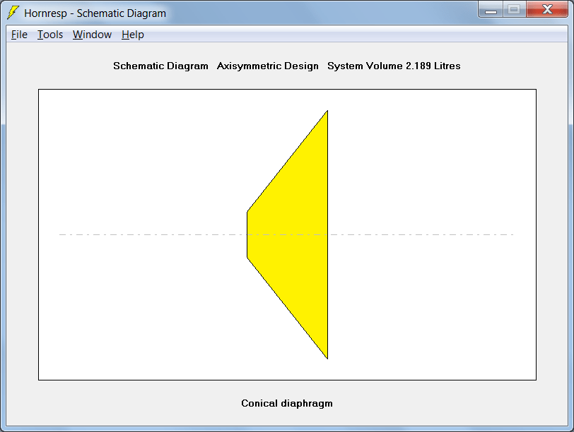

If the driver front air volumes indicated in yellow in the attachments are pressurised, then the straight surface of the diaphragm in Attachment 1 is going to deform at a lower pressure than the more rigid convex curved surface of the diaphragm in Attachment 2.

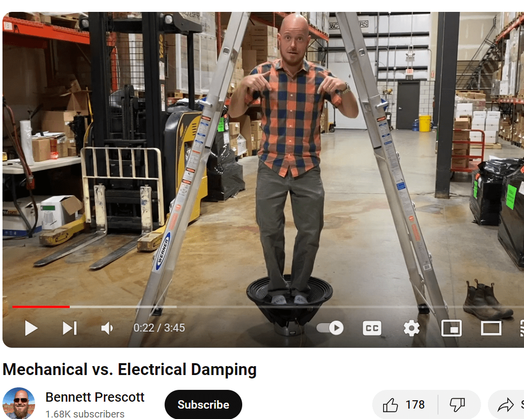

Yes, standing on the "paper cone" tells a lot about the sturdiness of a solution. It should crumble, but it doesn´t. And when you touch it by just one finger, it looks like it CANNOT withstand any serious force. But then you think what amplifiers they use for it, and you think even more this can´t be true.
On the IPAL coil and cone, there are certainly forces in excess of 1000N pushing at times. You would say former has to disconnect from the cone, the coil must slip or the cone has to go in half, or something has to frikkin give. No. It holds for milions of repetitions. Wow. Just WOW.

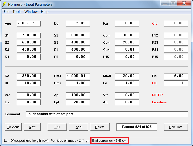

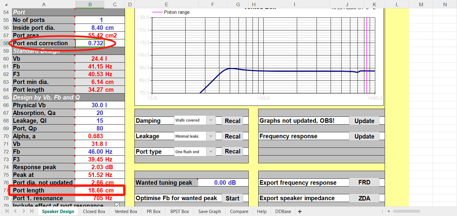

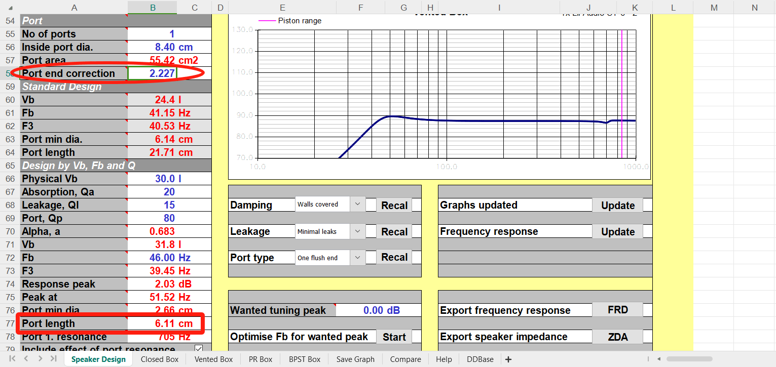

In Attachment 1, because Ap and Lpt are used Hornresp knows that a 20 cm long port tube having a cross-sectional area of 100 cm2 is being specified, and so an internal unflanged end correction of length 3.46 cm is added automatically.
Thanks David, but... I am getting a bit confused here.
I actually thought, as stated in another thread. that the mentionned end correction at the bottom (the 3.46cm in your example) was already calculated/integrated/comprised in the port length specified in Lpt.
See the thread i am taking about here : https://www.diyaudio.com/community/...p-and-end-corrections-for-port-length.382053/
So, to make things clear once and for all : when constructing the cabinet, should the port's physical length be 20cm or 23.46cm ?

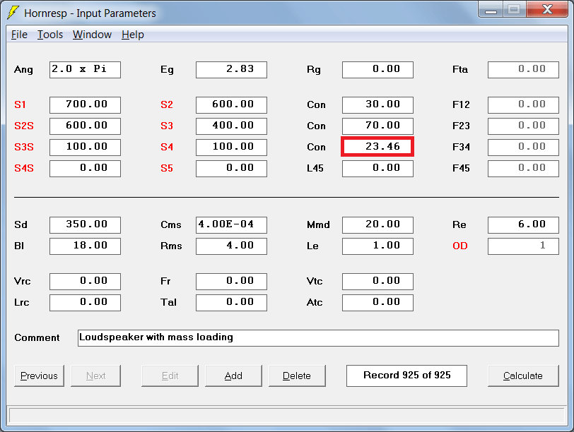

Unflanged end correction = 0.1952 * Pi * [port tube radius] = 0.1952 * Pi * 5.64 = 3.46 cm
In Attachment 2, Hornresp has no way of knowing that horn segment 3 is to be treated as a port tube and so no end correction is automatically added. An end correction of 3.46 cm has been added manually to L34 (20 + 3.46 = 23.46) so that the results for the two designs are effectively the same when compared, as shown in Attachment 3.
Note that it is only necessary to add a correction to the internal end of the port tube, as the radiation impedance is taken into account at the external end.
Ok, so now lets say that I want to do a rectangular slot port, with the internal bottom and side panels acting as three of the port's sides.
For what I've heard in many places including this forum, a slot port in this case should be physically much shorter because the side and bottom panels already act as an extension of the port.
Such a difference can be easily seen in the example in the two attachements taken from Unibox, where all numbers are strictly the same, except for the port, where in one the port is a round tube flanged at one end - with a K of 0.732, and in the other the port is supposed to be a slot port with K of 2.227 we can see that diffence in port length is quite substantial.
So do you have a specific formula that should be applied in hornresp to calculate port end correction in the case of such a slot port, or should I just use the length of the last section of my MLTL as mentionned in hornresp as the true physical length of my port (--> meaning here the length of the fourth panel of the vent, the one that is not a cabinet side or bottom) when building the cabinet ?
Sorry to bother you with this David, but I can't seem to find any clear and definite answer to this question anywhere really, and I have been wondering about this for quite a while now.
Many many thanks !
