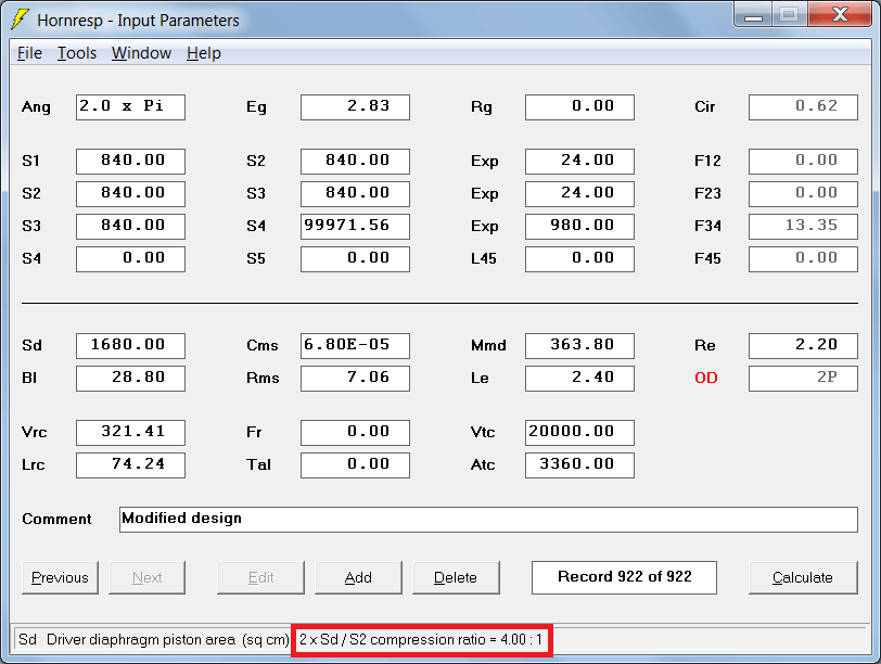

Do you have any tips or formulas for how to calculate a suitable compression ratio for a given driver in a given situation?
Don't exceed 4:1 if the horn system has a cone type driver. The actual ratio used will depend on what you are trying to achieve with your design.
Am I simulating it correctly or do I need to add something to take into account the effect of the chamber between the drivers?
See the screenprints below for a possible alternative design.
Vtc = Effective air volume between the driver diaphragm and the front plane of the driver, determined using the Driver Front Volume tool.
(For the example below the driver front volume is assumed to be 10000 cm3, meaning that the total for the two drivers is 20000 cm3).
Atc = Sd * 2 drivers = 1680 * 2 = 3360 cm2

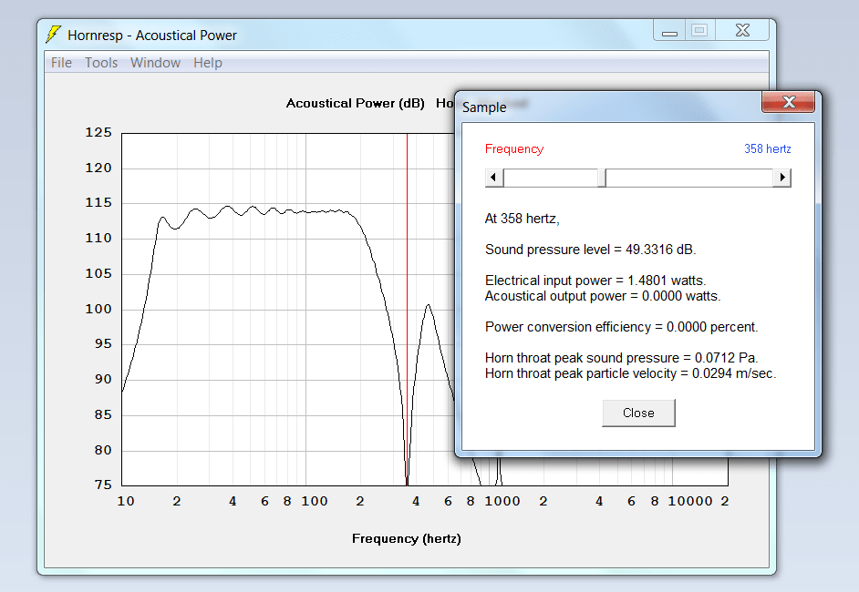

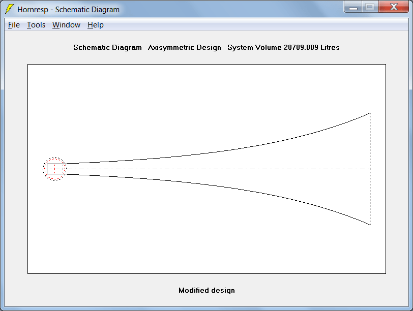

The power response for the alternative design is shown below.
The null at 358 Hz is due to the driver offset of 24 cm being one quarter wavelength long at that frequency.
At 358 Hz:
Wavelength = 34400 / 358 = 96 cm
Quarter wavelength = 96 / 4 = 24 cm

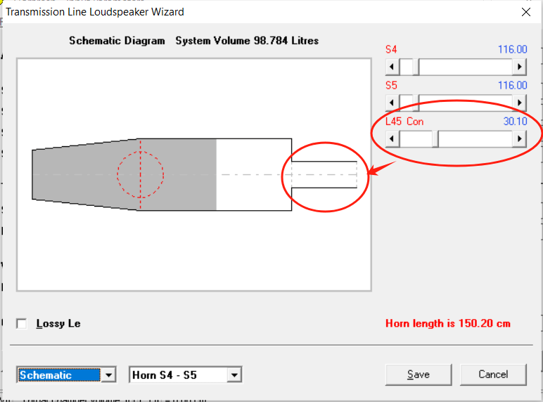

Hey there y'all folks,
It's been a long time since last time I posted in this forum.
Meanwhile I've been experimenting quite a bit with MLTLs.
Of course I've been modeling quite a few MLTLs configurations in hornresp.
And there is one point that I need to check with David McBean - and eventually with anyone else here that would like to share their own inputs :
1) If I model an MLTL with an offset port - typically a round port in the shape of a tube, there is a port end correction to be applied - for a typicall such port that end correction is generally 0.732 - and indeed hornresp applies an port-end correction, and it is stated very clearly and precisely how much correction is applied. And so the lenght of port (Lpt) that is given in hornrest takes this into account in its calculation and therefore the given Lpt in Hornrest is the exact physical length that the port should have when assembling the cabinet so that the response can match what was modelled in Hornresp, right ?
2) Now if I model an MLTL just using the "Mass Loaded" configuration (using the input wizard for example) then I get - in the hornresp-generated box diagram - a box with a port at it's very end... Ok BUT what is assumed here, as a port/vent type ?
I get the impression that it is a neutral "K" number - say like a 1, and that it is then to each one of us to apply the correct port end correction "K" number depending on the type of port each one want to do - because K for a round port is 0.732, but K for a slot port with three sides of the port being the internal faces of the cabinet is 2.227...and that generally means quite a difference in the actual physical length of the port.
So is my assumption correct, or not ?
See the attached picture as an example : this model uses the Mass Loading type in hornresp.
If I want this port to be a round port (yeah ok, sticking out or plugged in the end of the cabinet, but here just for the sake of the example !) do I need to apply a 0.732 end correction to the given 30.1 cm length
Now if I want to do a slot port do I need to apply like a 2.227 end correction to the given 30.1 cm ? Or Not ?
