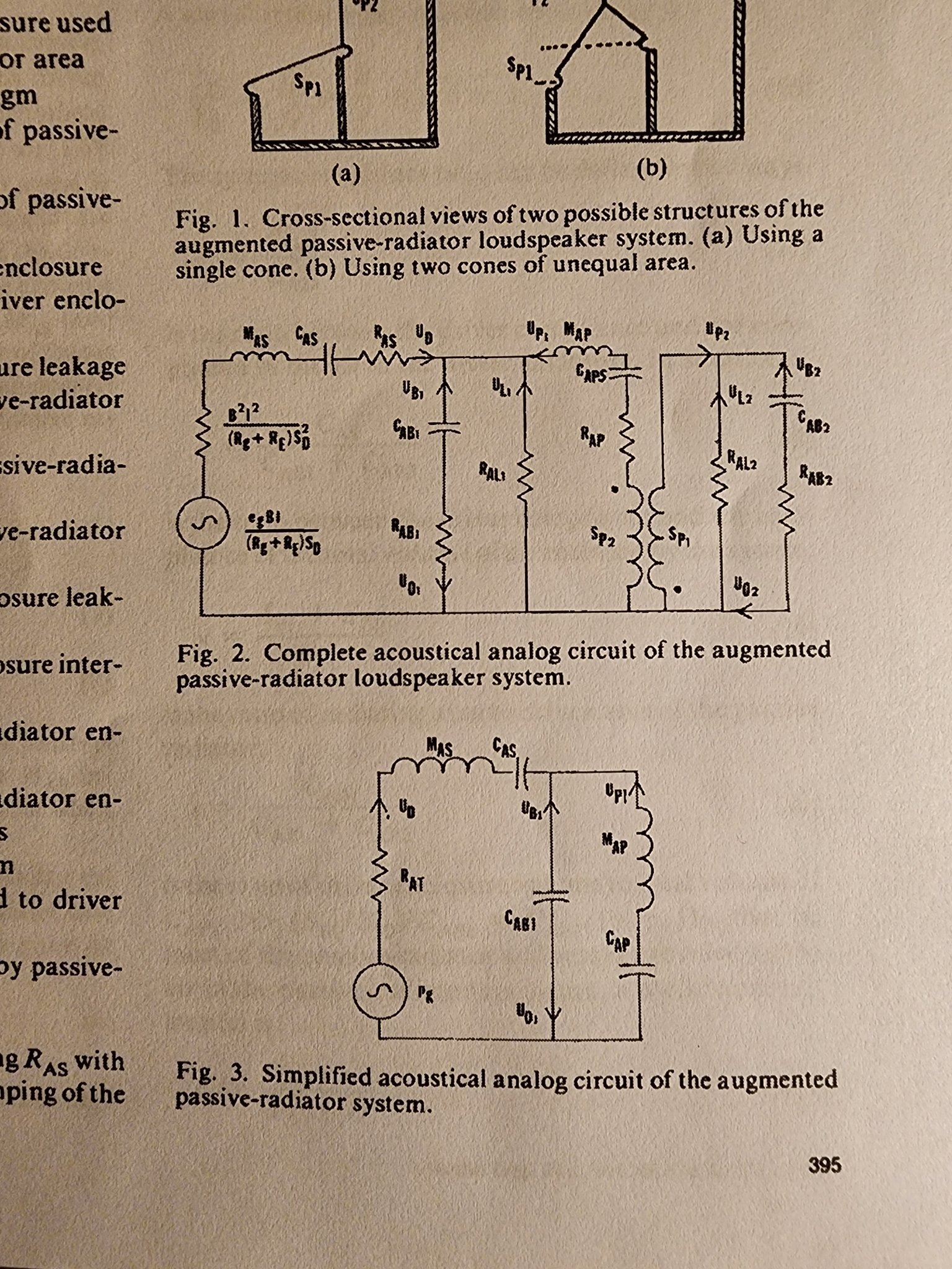

Hi @David McBean . I had some facebook discussion with Brian Steele and he mentioned asking you if there was a way to model Augmented Passive Radiator designs in HornResp? He did mention this was discussed and dismissed in the past as being very difficult. I'm researching the design for the InDIYana 2024 competition (so just for fun!) and I'm trying to learn how to model these enclosures. There are AES papers by Thomas L. Clarke showing the acoustic circuit for these designs (see screenshot), so I'm attempting to teach myself how to translate that into a circuit that can be modeled in LT Spice or something similar. I'm completely new to this kind of analysis, so I thought I'd reach out to see if you'd reconsider looking into this? Regardless of your answer, thanks for HornResp, and all your contributions to our hobby / profession!

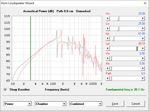

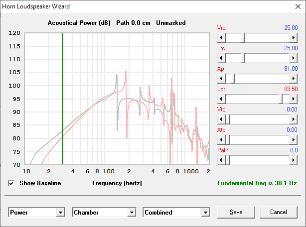

... and, after adjusting Lpt in the Hornresp sim accordingly to match the calculated value for Lpt,...
