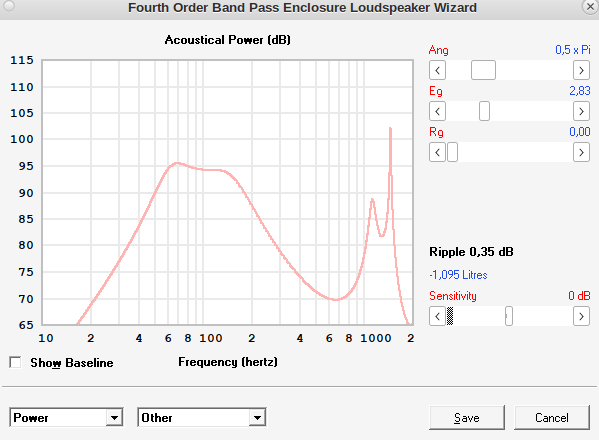

In some cases the automatic bp4 calculator creates negative volume.

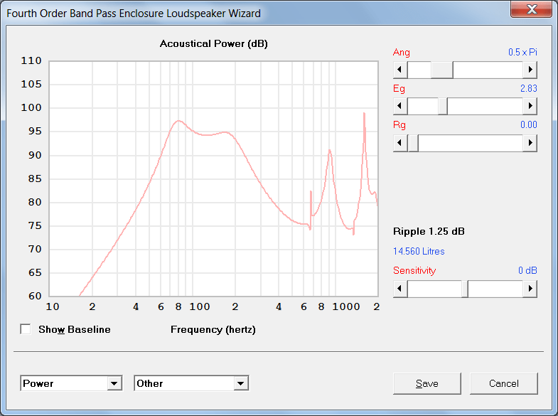

Hi rertrobaer,
Thanks for the feedback.
The formula used in the Vance Dickason method to calculate the volume of the rear unported chamber is:
Vr = Vas / ((Qbp / Qts) ^ 2 - 1)
Where:
Vr = Rear chamber volume
Vas = Volume of air that provides a restoring force equal to the driver's mechanical compliance
Qbp = Q of bandpass rear chamber
Qts = Driver total Q

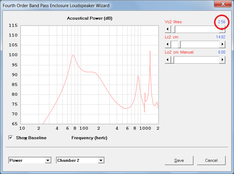

In your example, for a ripple of 0.35 dB and a sensitivity of 0 dB, Table 1.26 in the Vance Dickason Cookbook gives Qbp as 0.8333.
The value of Vas for the driver you have specified is 0.90 litres, and the value of Qts is 1.035 (shown rounded to 1.04 in Hornresp).
This means that:
Vr = 0.90 / ((0.8333 / 1.035) ^ 2 - 1) = -2.56 litres
In other words, if Qts is greater than Qbp then the calculated value of Vr will be negative.
Interestingly, simply changing the calculated value from negative to positive seems to produce reasonable results, as shown in the attachments. To prevent invalid values from occurring, as from the next update the absolute value (in this case 2.56 litres) will be used instead for Vr.
Kind regards,
David

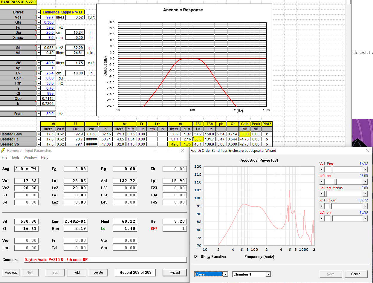

Just in case anyone's interested, I believe the equations from the LDC to calculate 4th order BP systems assume zero losses. I've got a couple of equations that calculate frequency response for bandpass alignments (using lumped-mass modeling) and they basically give identical results for bandwidth and F3 points when Fr and box losses are set to zero (Fr being the vent resonance frequency for the rear chamber, and 4th order BP systems don't have vented rear chambers). Hornresp seems to assume zero box losses as well, so the FR shown by the Hornresp sim should be pretty close if not identical to what's predicted by my equations. Hmm, maybe it's time for a test sim to find out... 🙂
Reactions: Kravchenko_Audio

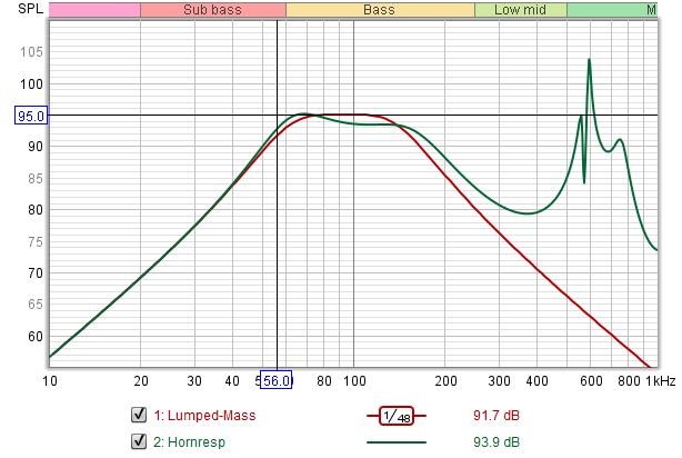

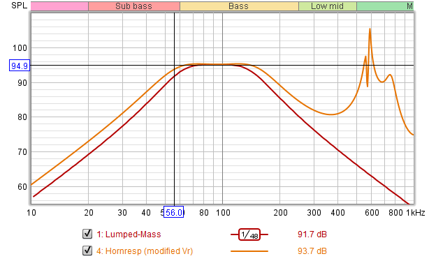

Here's a quick comparison - my old BANDPASS.XLS workbook uses lumped-mass modeling. Results are basically identical to what the equations from the LDC predict. However, the Hornresp sim's calculated response suggests that Fb is set a bit low, or something else is off. Hmm....
Yes, I know the volumes are slightly different between the two sims, but the differences are minor and have little effect on the frequency response.
Based on some experience I've had with some bandpass builds, I suspect that the Hornresp sim might actually be more accurate.

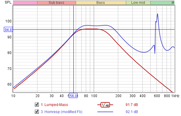

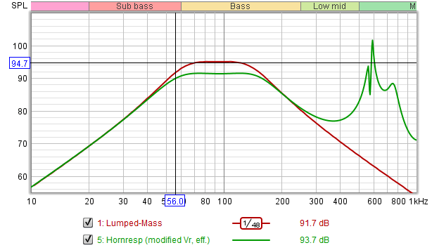

Here's a comparison of the predicted FRs. I aligned them along the slope at lower frequencies.
While the lumped-mass model produces results that matches the info in the LDC (i.e. gain, F3h and F3l), it's been my experience that the wider passband predicted by the Hornresp (and the non-flat response that's a bit biased towards lower frequencies) is the result of building a 4th order BP alignment using the LDC information.
Here I modified Fb in the Hornresp sim to flatten the passband. The sim's passband is still wider than that predicted by the lumped-mass model.
...and here I modified Vr (i.e. made it larger) in the Hornresp sim to flatten the passband. Again, the sim's passband is wider than that predicted by the lumped-mass model.
Finally here I shifted the FR for the "modified Vr" sim down by 3.8 dB. Now the slopes line up.
Again, based on the experience I had with two builds (see http://www.diysubwoofers.org/projects/home/inf10bp/ for example), I think the Hornresp sim is the more accurate of the two, and if that's correct, the LDC method may need to be modified, or it should just be considered as a starting point, with some subsequent adjustment required after running the wizard.
