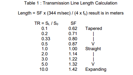

I think this information from Martin's paper can be used to determine the required taper ratio to achieve a particular Fb, given L (step 3 in the process I gave above).
Basically, work out SF, using SF= L*4*Fb/c (where c = speed of sound)
Then use the table to determine the nearest taper ratio that matches the required SF.
Even better would be to do a curve fit for the table above, and then use the corresponding equation to work out TF for any SF.

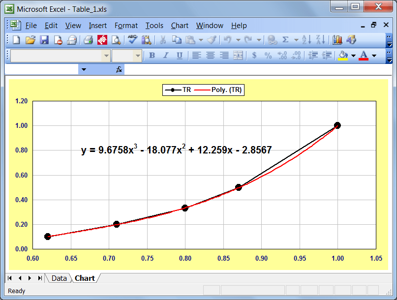

I did that for just the tapered data when I first read Martin's 2021 paper, and came up with the following:
TR = 9.6758 * SF ^ 3 - 18.077 * SF ^ 2 + 12.259 * SF - 2.8567

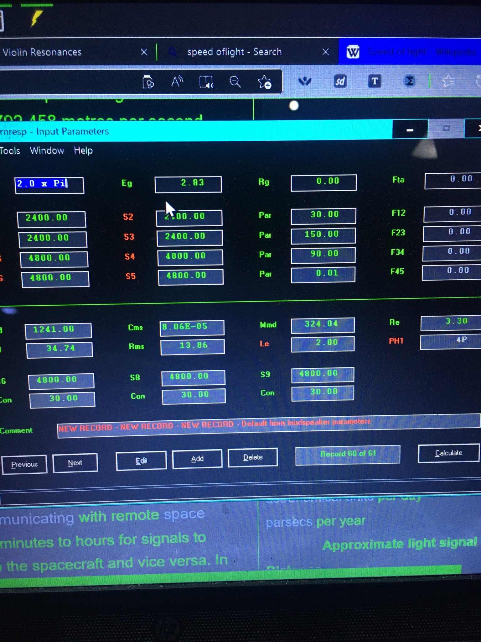

question🙁for anyone)
(not to interrupt and certainly secondary to the current discussion)
what is the point of offset driver mode if not using 0.3490658?(pi/9)?
π÷9 = 0.349
this entry point promotes Helmholtz resonance. having the driver entry perfectly at this point facilitates the harmonics with double and triple the wavelength of the fundamental, especially when the TL has
2 folds (3 sections),
which causes reinforcement of the fundamental through harmonic subtraction. the reinforcement is perceived as the difference between the double and triple wavelength and thus our ear hears an additional 'ghost' fundamental, or rather a boost of that frequency. the frequencies in the box are not 'fighting' each other but rather coalescing on every node in the TL. it's like the Tacoma Narrows bridge, resonance became so strong the entire structure started waving. this is ideally what one would want, smaller-scale, in a TL
this is the only concern ,’ taper ‘ is just a diluted mess of infinite stepped reductions than only need to take place as fold points in TL
Hi Bw,
Brian currently uses 0.341 for the offset ratio but I would be happy to change it to Pi / 9 if it means that we have a better theoretical basis for the value chosen, and Brian agrees to the change. I have tried both values, and in practice it makes no difference to the results either way 🙂.
Kind regards,
David
Reactions: Booger weldz
