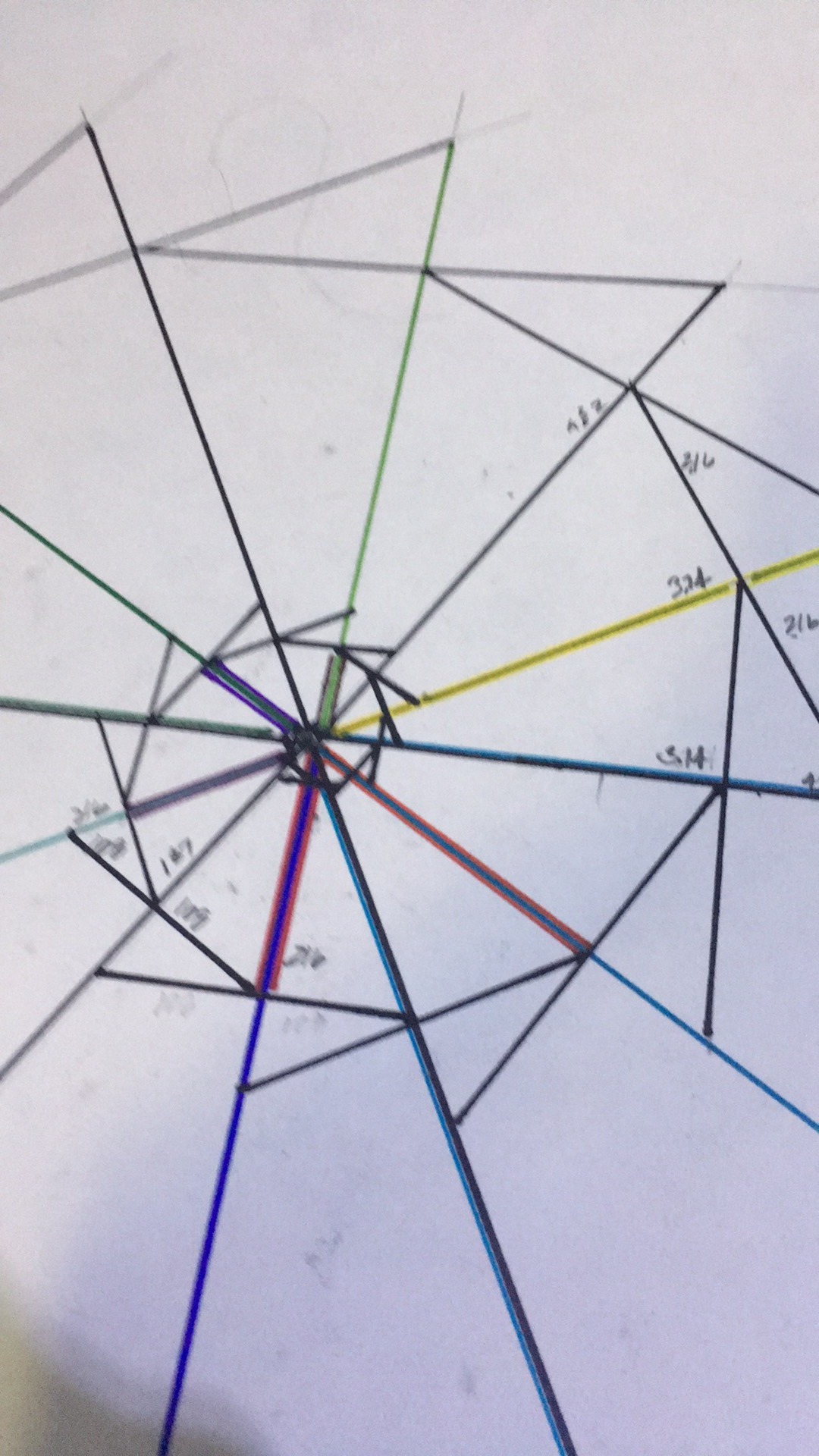

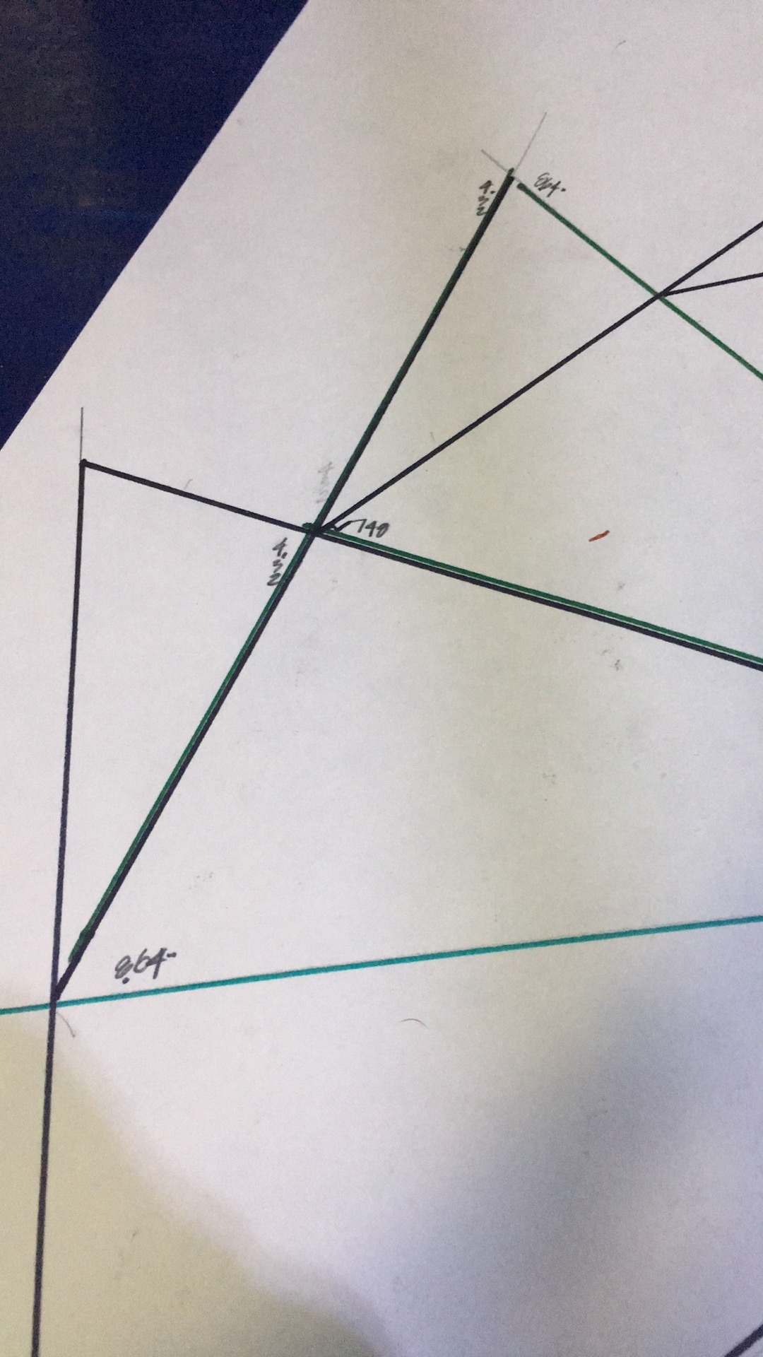

1496/864/1728 abc
(same c as e a= mC^2)
1496 is the astronomical unit …
sqroot of 3• 864)^2 plus (864)^2
is (864x2)^2.

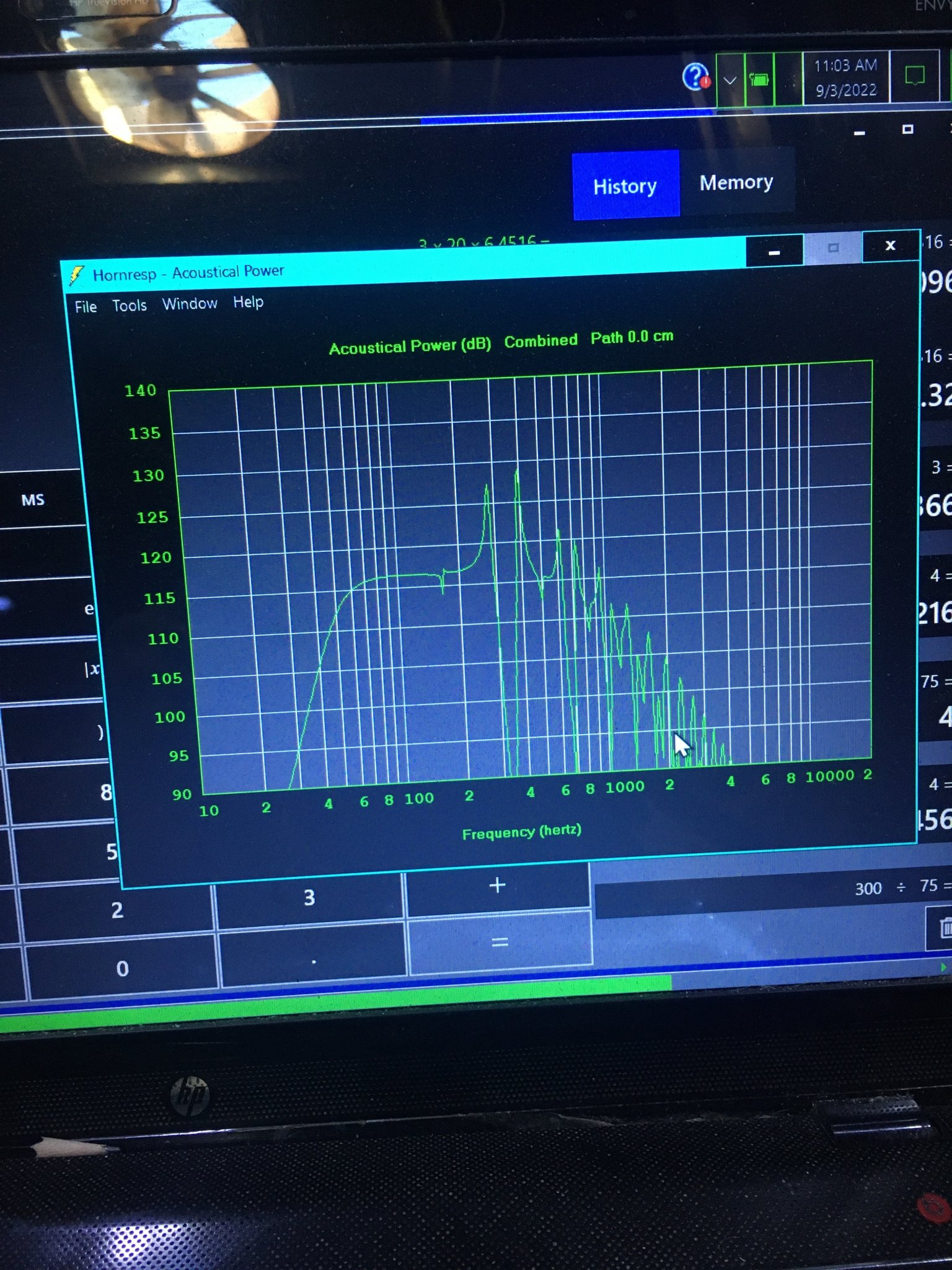

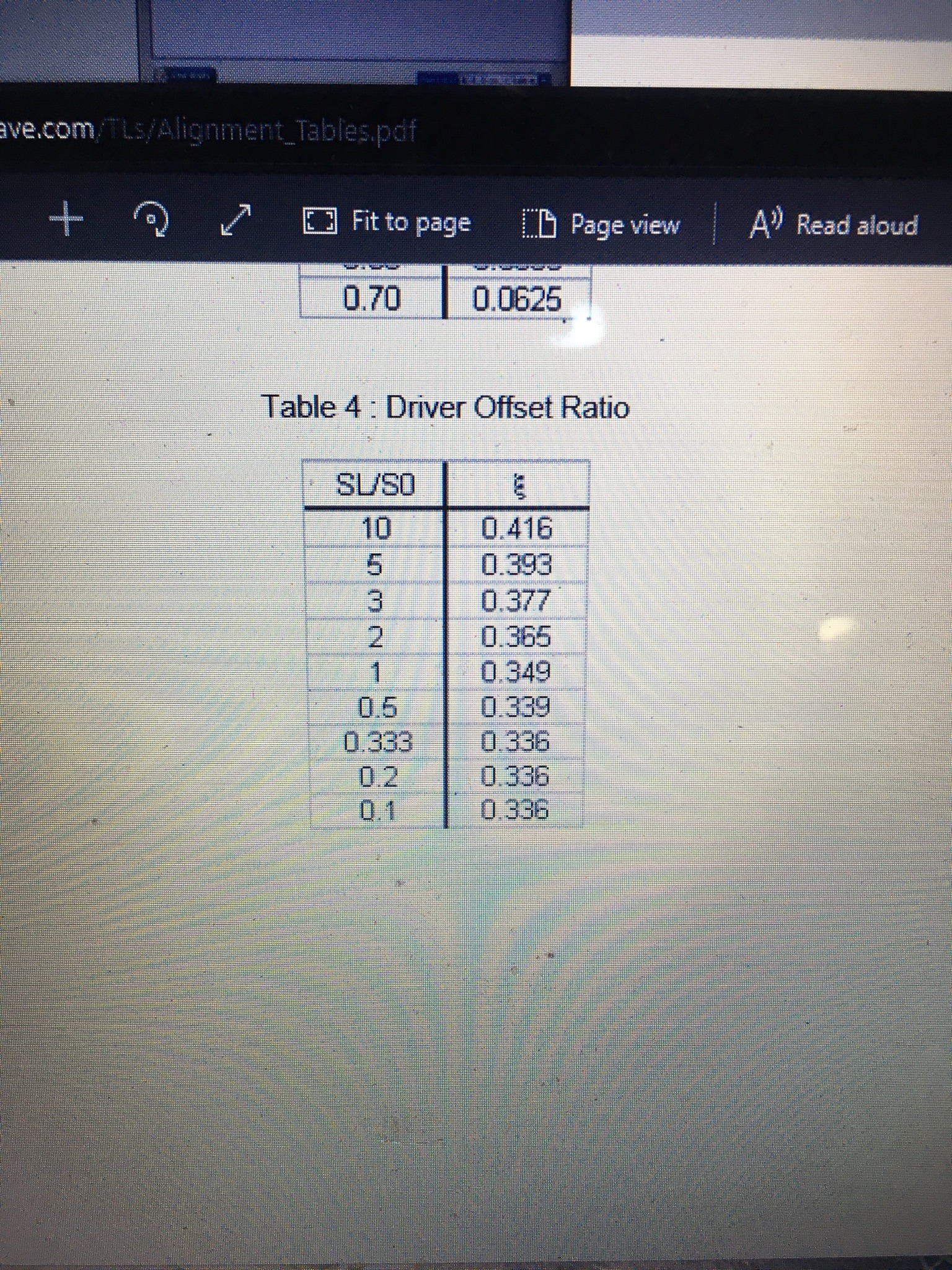

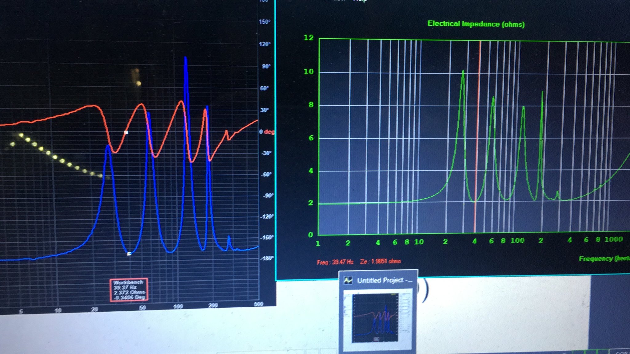

Yup, that would be excellent.If I understand correctly you would actually like to use the equation L= 6*v*100/(4*Fh) - EC in Step 4, where EC is the end-correction that results from the calculated value of S3. In effect to predict the resulting EC before it is calculated 🙂. I have coded an algorithm to do this and it seems to work fine for both non-tapered and tapered transmission lines. It results in slightly shorter transmission lines as expected, but the values of Vb and Fb are retained. Will this meet your needs?
No, there is no scientific basis for that. The use of 0.341 is just a ratch, an approximation, that seems to result in a better nulling out of the first harmonic than using 0.33. In fact, I won't be surprised if a more accurate location would be 0.33 plus the end-correction (or some computed part of it), LOL.Also, are you happy for the offset ratio value to be slightly changed to Pi / 9, as suggested by Booger weldz?
If you've got an algorithm for working it out (mentioned in post 12,938), I suggest we use that.The theoretical end-correction for S3 unflanged is 0.61*R3.
The theoretical end-correction for S3 flanged is 0.85*R3.
Are you happy to still use 0.8*R3 as the end-correction, where R3 is the radius of S3?

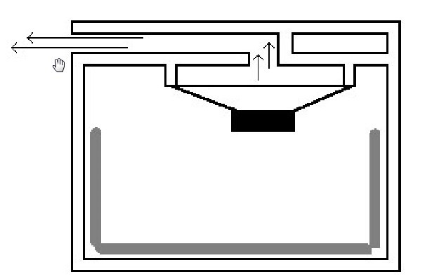

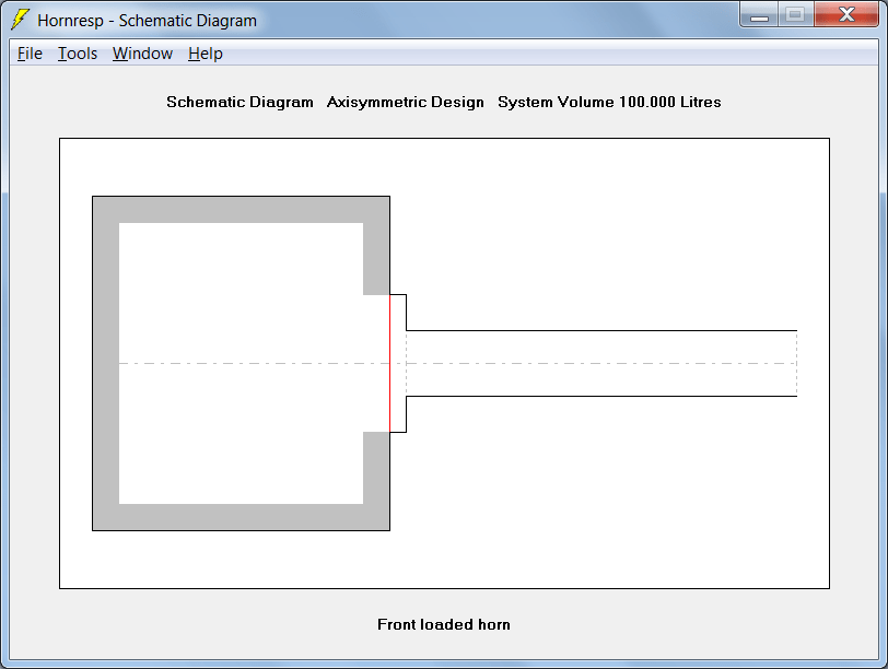

Looks to me like a 4th order bandpass with very small front chamber!Looks like a kind of closed box and front loaded design with a very small outlet in stead of a flare like
in a horn..

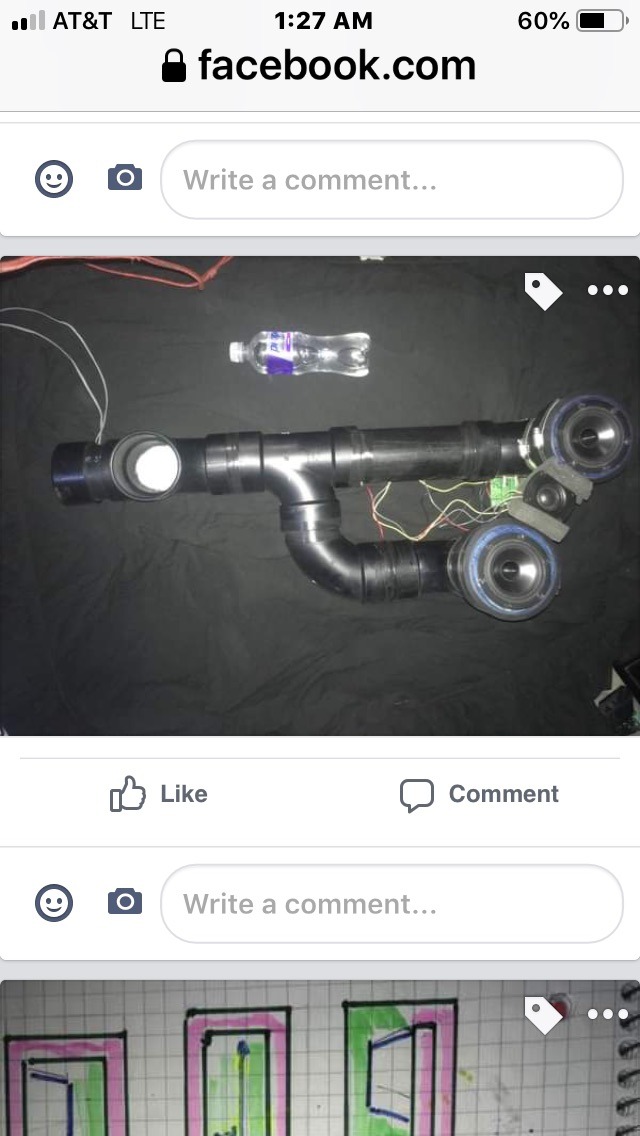

ready to construct an ‘adjustable’ entry TL to locate this for ‘real’ if a satisfactory method is suggested? sleeved abs/PVC pipe in sched40 3” and 4” are within 0.00x “ of OD/ID and umm6 can grab the results ?Yup, that would be excellent.

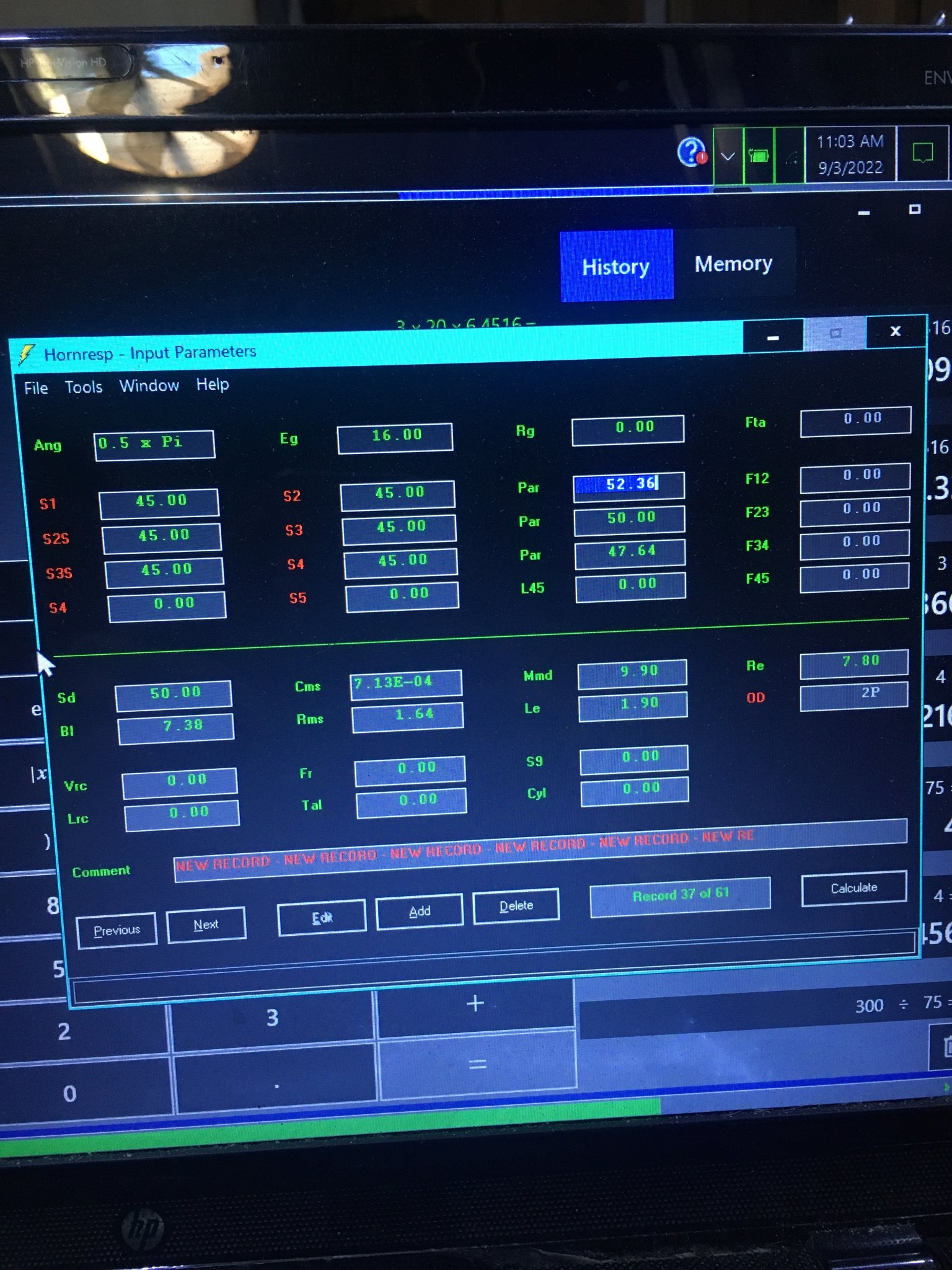

Unless you can think of a good reason not to, I would like to use L12 = (L13 + EC) / 3 rather than L12 = 0.341 * L13 to calculate the driver offset. Interestingly, the new formula still gives an offset ratio very close to 0.341 in all cases (both tapered and non-tapered).The use of 0.341 is just a ratch, an approximation, that seems to result in a better nulling out of the first harmonic than using 0.33.

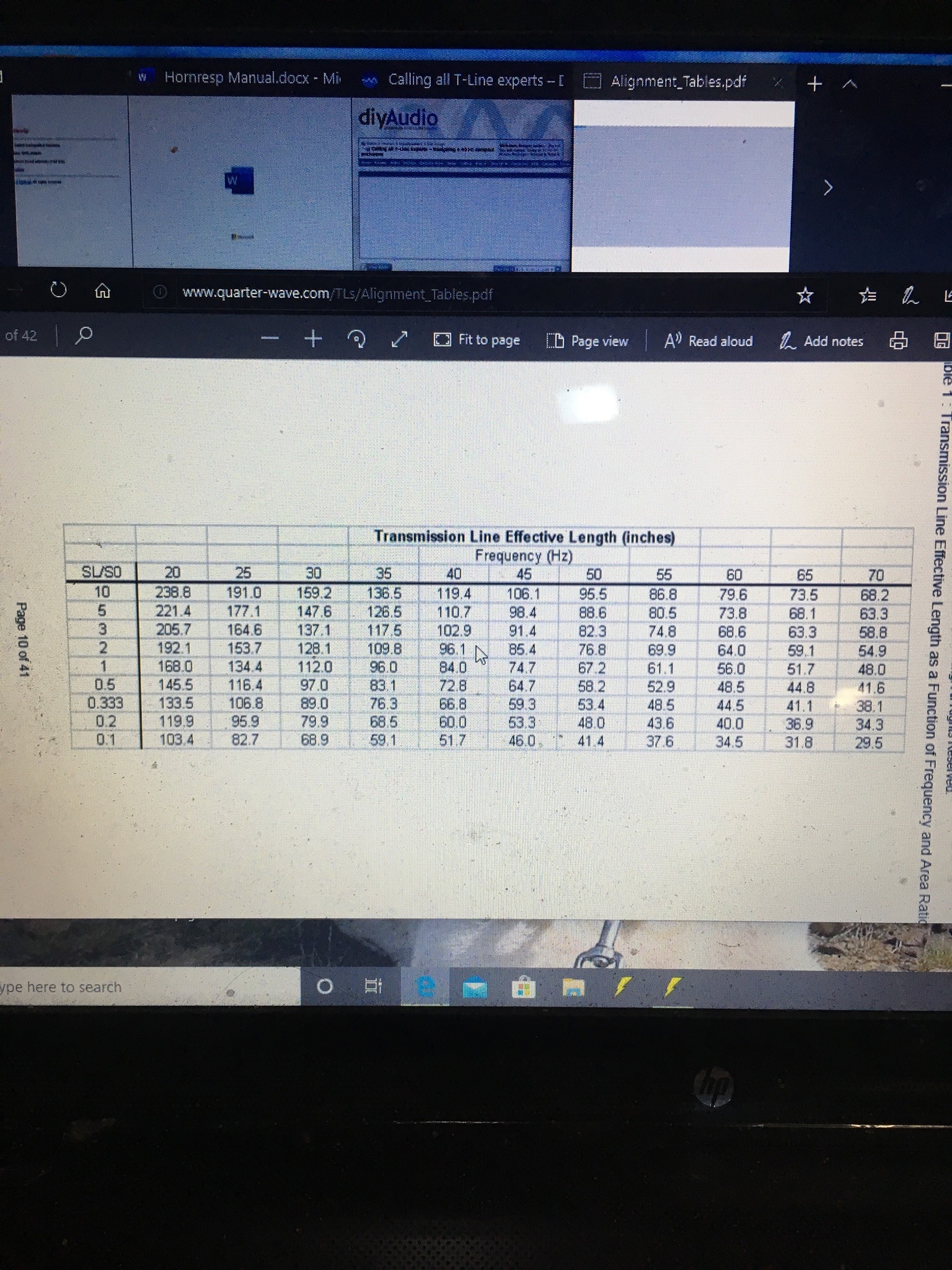

Sanity check of new algorithm:I have coded an algorithm to do this and it seems to work fine for both non-tapered and tapered transmission lines.
If:
Vb = 87 litres
Fb = 26 Hz
BW = 10
Then the new algorithm calculates:
Fh = 260 Hz
L13 = 193.93 cm
S3 = 89.72 cm^2
EC = 4.53 cm (for S3 of 89.72 cm^2)
OR = 0.341
Given:
L = 6 * v * 100 / (4 * Fh) - EC
Then:
L = 6 * 344 * 100 / (4 * 260) - 4.53
L = 193.93 cm
Because the value of L is the same as that of L13 calculated above, it means that the algorithm is working correctly 🙂.
Any remaining small differences between the required and actual Fb in a tapered system are most likely due to the
S1/S= ROUND(0.0046*BW^3-0.1483*BW^2+1.6776*BW-4.7182,1) mapping formula not being exactly correct.
Brian, are you happy for your method (with my minor tweaks) to be released as it now currently stands?
Hi Kees,Looks like a kind of closed box and front loaded design with a very small outlet in stead of a flare like in a horn..
That's what it looks like to me also.

Looks good to me....Unless you can think of a good reason not to, I would like to use L12 = (L13 + EC) / 3 rather than L12 = 0.341 * L13 to calculate the driver offset. Interestingly, the new formula still gives an offset ratio very close to 0.341 in all cases (both tapered and non-tapered).
Yup, looks fine to me. I'll have to run it through a bunch of sims with different drivers to confirm, but it looks fine at the moment.Brian, are you happy for your method (with my minor tweaks) to be released as it now currently stands?
please build one 🤷 we’re traveling down a precarious road hereYup, looks fine to me. I'll have to run it through a bunch of sims with different drivers to confirm, but it looks fine at the moment.
This has been a great collaboration resulting in a very useful and powerful new tool for Hornresp, elegant in its simplicity of operation. Hopefully others following the discussion may have found it interesting also. Thank you for your persistence in not giving up when at times it seemed that what you were trying to achieve might be impossible 🙂.Yup, looks fine to me.

Why precarious?we’re traveling down a precarious road here
