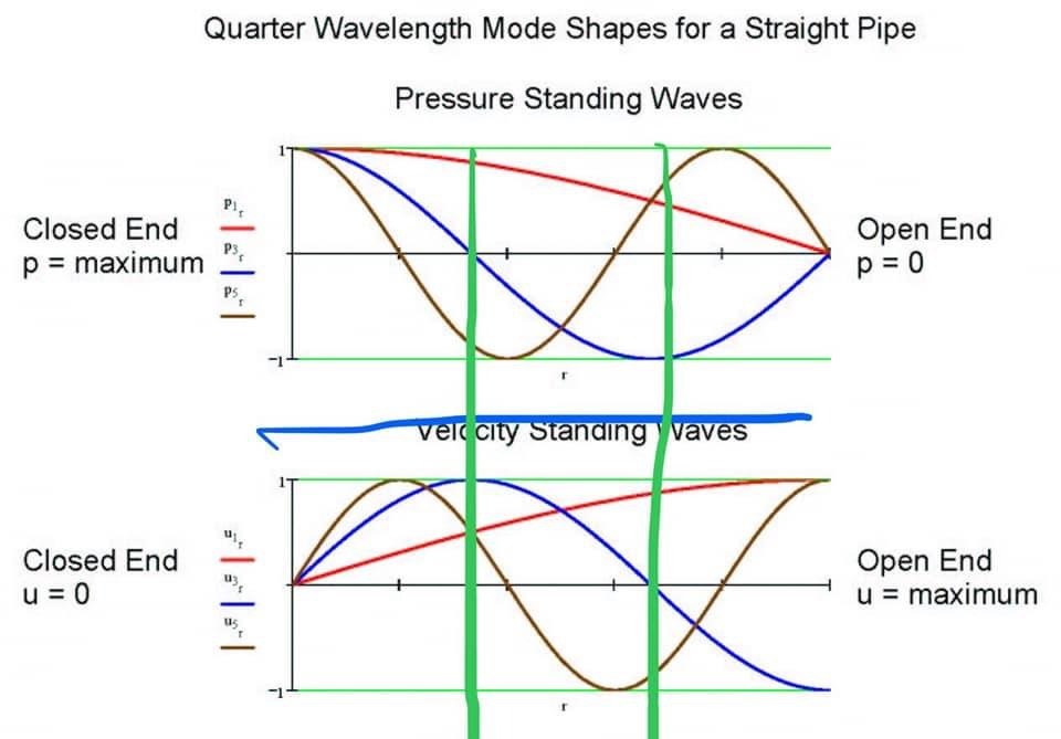

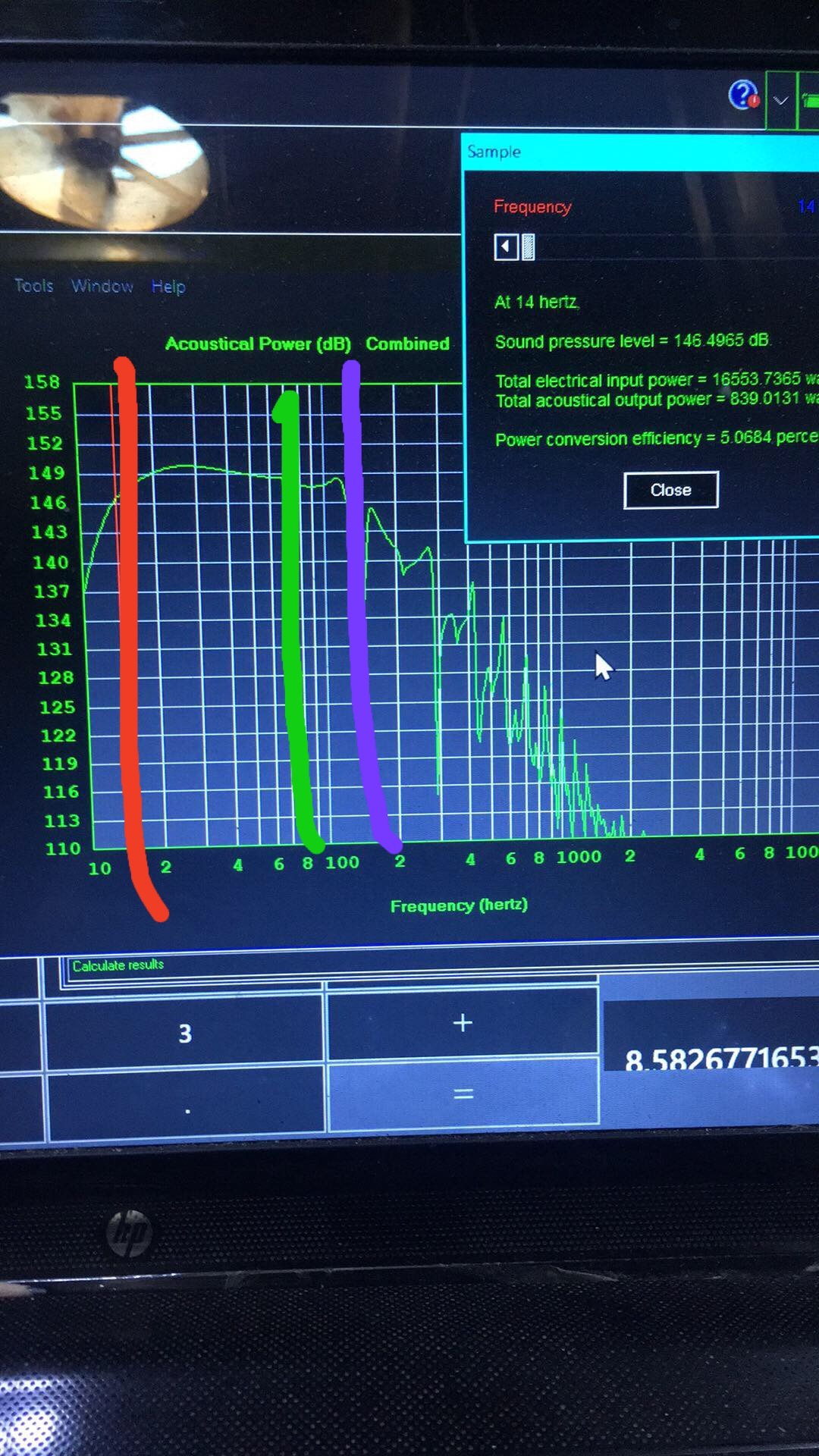

where is this in ‘0.341’? its getting fuzzy? (precarious is wrong word, i dont know what is right though ?) (red,green and purple(should be brown, oops) on Generic HR model go with Martins illustration of sine wave shapes of Pmax/Vmax @ closed end)
π÷9 = 0.349
this entry point promotes Helmholtz resonance. having the driver entry perfectly at this point facilitates the harmonics with double and triple the wavelength
of the fundamental, especially when the TL has 2 folds (3 sections), which causes reinforcement of the fundamental through harmonic subtraction. the reinforcement is perceived as the difference between the double and triple wavelength and thus our ear hears an additional 'ghost' fundamental, or rather a boost of that frequency. the frequencies in the box are not 'fighting' each other but rather coalescing on every node in the TL. it's like the Tacoma Narrows bridge, resonance became so strong the entire structure started waving. this is ideally what one would want, smaller-scale, in a TL

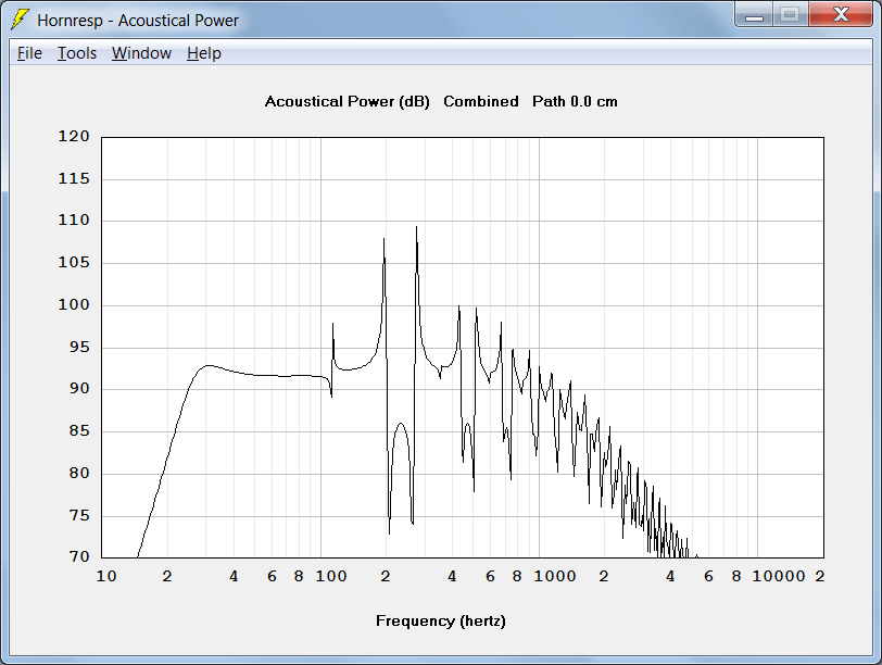

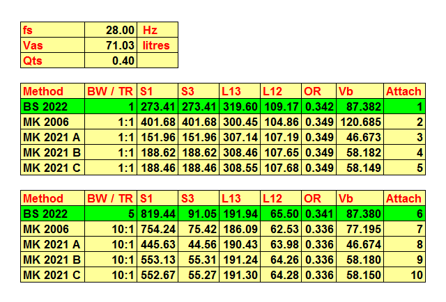

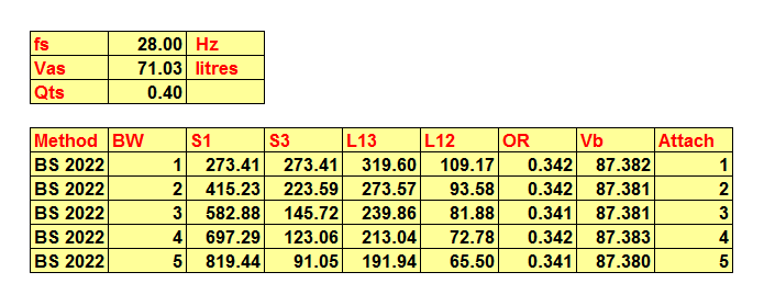

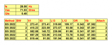

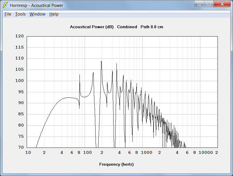

The attached tables compare the results produced by all the methods and alignments proposed for the updated TL Design tool.
The first table shows non-tapered transmission line results. The second table shows the results for transmission lines having maximum taper. The same driver was used for all cases.
MK 2021 A - Alignment QL15/SBB4/BB4
MK 2021 B - Alignment QL15/QB3/SQB3
MK 2021 C - Alignment QL15/SC4 /C4
Brian,
I decided to use 1 - 5 rather than 6 - 10 for the BW range 🙂.
BW = 1 is equivalent to your BW = 6 and BW = 5 is equivalent to your BW = 10.

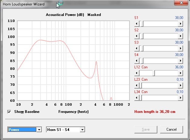

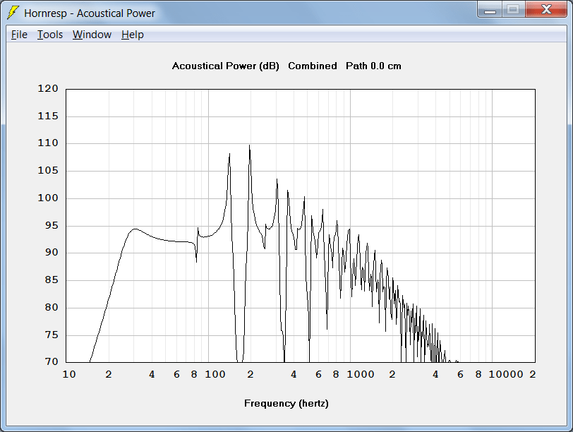

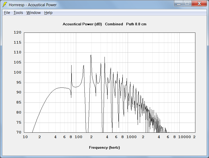

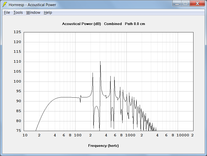

I get this, a bandpass like respons, looks like a bandpass sub but is not precisely, this one has a compression chamber, when I make that bigger
it jumps into a bandpass. Nice respons, tapped horn like. Only I do not now how to get damping into the closed back chamber. Can you tell me? thanks.
It si known als the janus interphase subwoofer. a old design. Do not work well on current amps. I was curious about it and test.Looks to me like a 4th order bandpass with very small front chamber!
It can possibly be improved by offsetting the throat entrance to the front chamber enough to null out the first harmonic (around 400 Hz in your image).It si known als the janus interphase subwoofer. a old design. Do not work well on current amps. I was curious about it and test.
Can I do this in hornresp? long time ago I did play, so forgot some tricks. thanksIt can possibly be improved by offsetting the throat entrance to the front chamber enough to null out the first harmonic (around 400 Hz in your image).

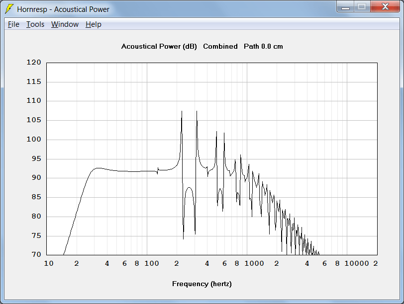

Ok, finally found some time to have a look..The attached tables compare the results produced by all the methods and alignments proposed for the updated TL Design tool.
Brian,
Starting with the driver parameters:
Fs=28 Hz
Vas=71.03 litres
Qts=0.40
Using the "optimum box" equations, we get
Vb=20*Qts^3.3*Vas=20*).4^3.3*71.03=69.1 litres
Fb=(Vas/Vb)^0.31*Fs=(71.03/69)^0.31*28=28.2 Hz
Using my suggested equations (which admittedly are based on a few sims), we get
Vb=20*Qts^3*Vas=20*).4^3.3*71.03=90.9 litres
Fb=(Vas/Vb)^0.31*Fs=(71.03/69)^0.31*28=25.9 Hz
The "BS2022" method in your table. with a BW setting of 1 has Vb at 87.382 litres, or 96% of the value provided by my suggested equations.
You didn't include Fb in your table, but plugging the figures into a Hornresp sim results in an Fb of 26.4 Hz, 2% over the value provided by my suggested equations.
I think that's close enough 🙂
The "BS2022" method in your table. with a BW setting of 5 has Vb at 87.382 litres, or 96% of the value provided by my suggested equations. so no change there. Plugging the figures into a Hornresp sim however results in an Fb of 27.2 Hz, 5% over the value provided by my suggested equations. Is a 5% difference Ok? I'm not sure, but I remind myself that this is just for a "suggested TL", not an "optimized TL"...
I noted also that the volume of the TL predicted by my suggested equation for Vb is noticeably smaller than that predicted by MK2006, but also noticeably larger than predicted by MK2021. I suspect that the predicted volume would be a lot closer to the MK202 figures if Vb=20*Qts^3.3*Vas was used instead, and maybe we should use that going forward.
Yes, model the horn as an OD horn.Can I do this in hornresp? long time ago I did play, so forgot some tricks. thanks

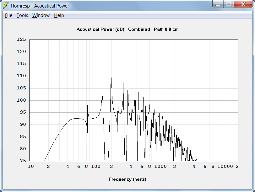

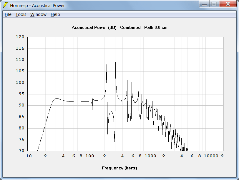

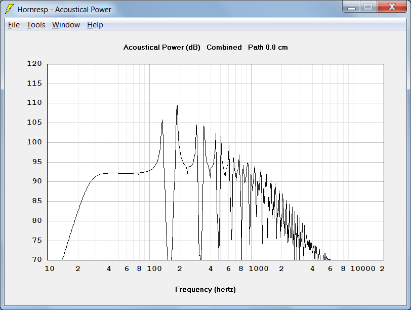

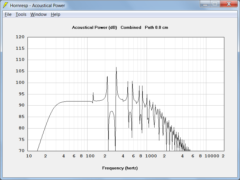

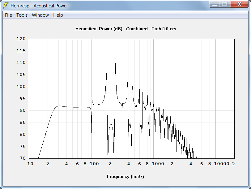

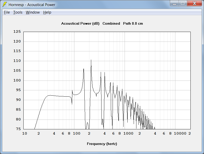

Interesting results for the straight TLs.Table 1 results.
The TL looks Ok in image 1 (BS022), oversized in image 2 (MK2006), undersized in image 3 (MK2021A), and Ok in images 4 and 5 (MK2021B and MK2021C).
The results suggest that the best TL for this driver lies somewhere between 58 and 87 litres. If the "optimum box" equation to calculate Vb in my method, that spread would be between 58 and 69 litres (another hint that perhaps using Vb=20*Qts^3.3*Vas for my method might produce better results).
The size predicted by MK2006 (120.7 litres) seems way too large. Perhaps only usable if the TL is going to be stuffed.
I suggest rechecking the calculations being used for MK2021A, as the result seems grossly undersized.
