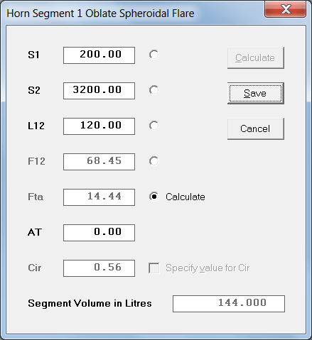

Use the Horn Segment Wizard tool.How to specify the angle of an OS horn at the mouth (at the (finite) length of the horn - not at infinity (asymptotic value)?
Fta is the flare tangent angle at the mouth, AT is the horn throat entry half-angle.

That's what I am doing but the last value in the exported horn data is always less than the angle specified. I think the Fta might be the asymptotic value, not the value at the mouth.Use the Horn Segment Wizard tool.
The data for the angle at the mouth exists but it is cumbersome to get at (save the Horn Segment Wizard tool values, re-calculate the modified design, go to the schematic window, export the horn data, open the exported file and read the last value).
I'd be happy if pressing the calculate button in the Horn Segment Wizard tool could show the actual angle at the mouth in parentheses.
I will investigate.I'd be happy if pressing the calculate button in the Horn Segment Wizard tool could show the actual angle at the mouth in parentheses.

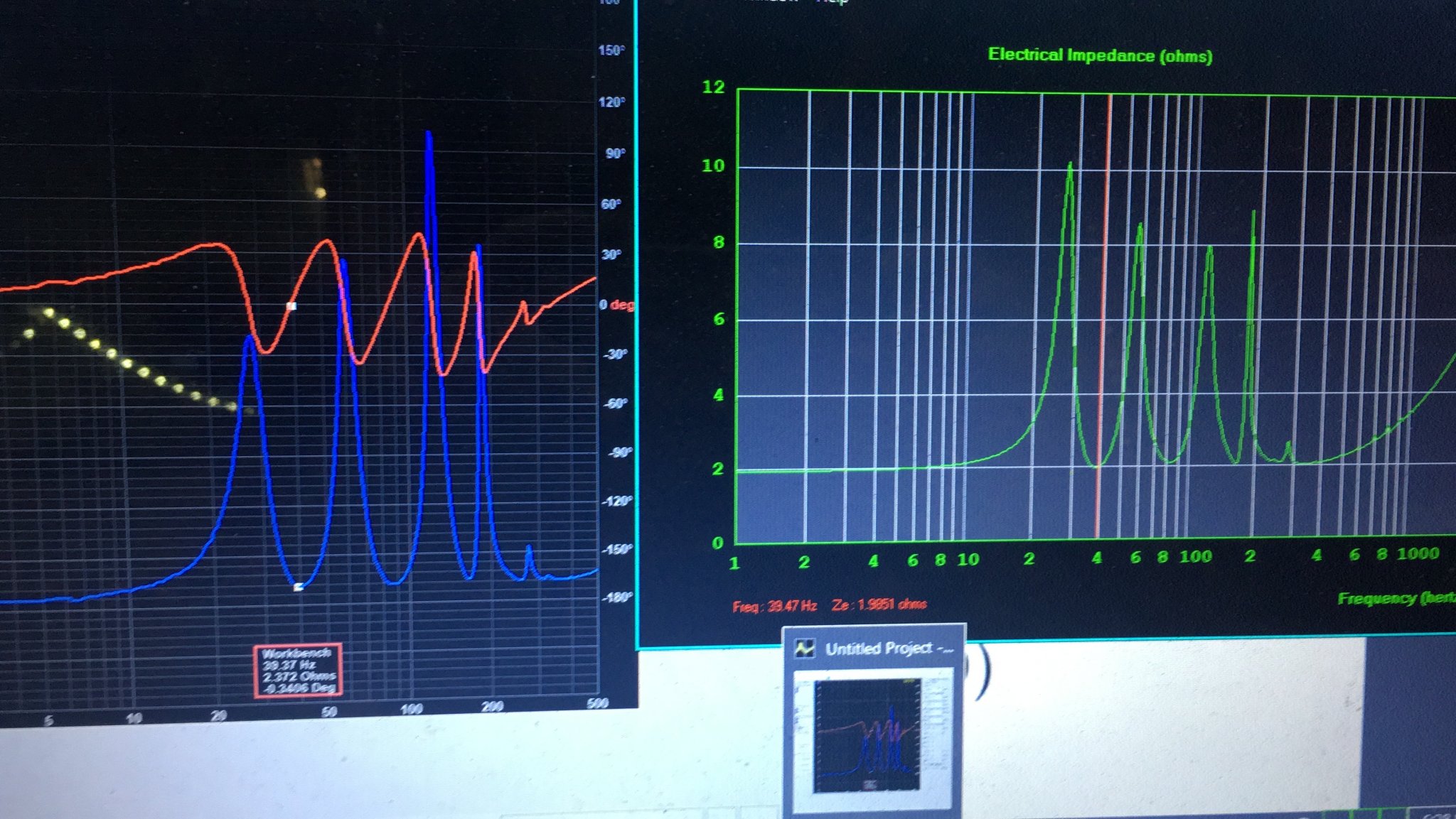

Didn't he kick you out from his group already for your non-scientific posturing about speaker design?when the feed back involves no sawdust and measure …will we start to see a degrade hornresponses potential .. please be careful . martin builds NOTHing except insults about you(us) all(to this day you all ‘ mentally masterbation ’) in my facebook group (i no longer tolerate it, he’s about to get the boot in a unanimous vote..)
i guess measurements aren’t ever enough.. nothing satisfies the arrogant. please don’t get distracted with reality and your ‘science’ ??Didn't he kick you out from his group already for your non-scientific posturing about speaker design?
i’m ready anytime, can you can keep up(your table saw)? not your ‘ideas’. the truth is simple right?
i build the exact thing i sim(HR) and it nails it EvERYTiMe. (unlike some of the ‘golden’ paraflex or many tapered anomalies you call mltl?
we have trophies in California from competitors who learned from horn response and continue to find the leader board is litered with HR users. or the same builds figured out (adapted to other TS para) using … this will reach greater numbers no doubt .. (everyone possibly )

Currently, for an Obl type system Fta is the coverage half-angle. In the next update the coverage half-angle will be designated as CA in the Horn Segment Wizard and Fta will become the flare tangent angle at the horn mouth.I think the Fta might be the asymptotic value, not the value at the mouth.
