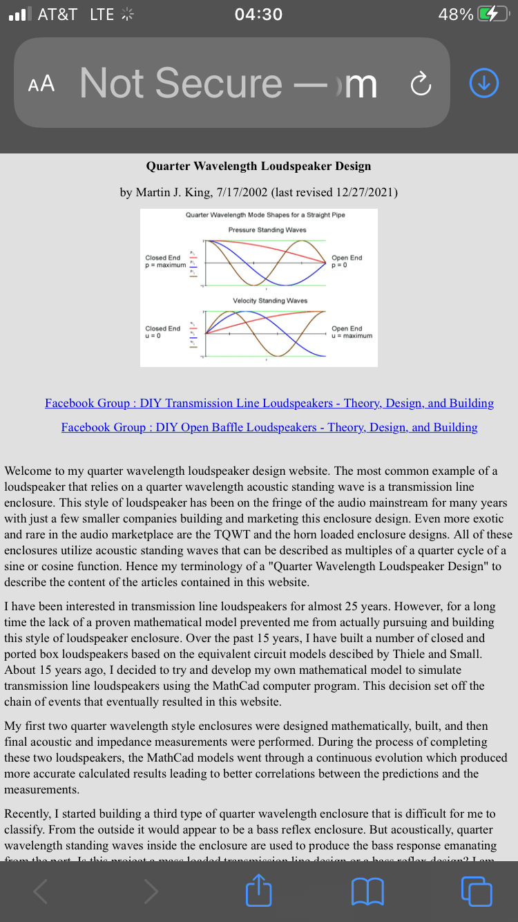

Hi Giri, GM and Brian,
Thanks for all the information. It seems that we can get different answers depending on which set of rules we choose to adopt 🙂.
I have compared Martin's 2006 and 2021 methods and it seems that the 2006 method produces the better results. With the same driver, taper rate of 0.2 and no driver offset, Attachment 1 shows the result obtained using the 2006 method and Attachment 2 shows the result obtained using the 2021 method.
Interestingly, in working through the 2021 paper I think that I may have found an error. Martin calculates the taper volume using the formula:
Vb = 0.5 * (S0 + SL) * L
This assumes that the cross-sectional area tapers linearly, but it is the radius, not the area, that actually tapers linearly. The correct formula to use for an axisymmetric conical segment is:
Vb = Pi * L * (R0 ^ 2 + R0 * RL + RL ^ 2) / 3

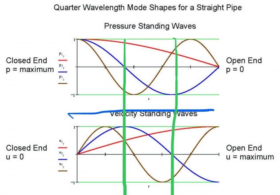

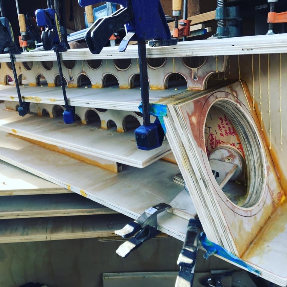

a thought (and a little more … 😝) bare with me…
“π÷9 = 0.349
this entry point promotes Helmholtz resonance. having the driver entry perfectly at this point facilitates the harmonics with double and triple the wavelength of the fundamental, especially when the TL has 2 folds (3 sections), which causes reinforcement of the fundamental through harmonic subtraction. the reinforcement is perceived as the difference between the double and triple wavelength and thus our ear hears an additional 'ghost' fundamental, or rather a boost of that frequency. the frequencies in the box are not 'fighting' each other but rather coalescing on every node in the TL. it's like the Tacoma Narrows bridge, resonance became so strong the entire structure started waving. this is ideally what one would want, smaller-scale, in a TL”
is this represented? considered or part of the inner workings of horn response?
One things for sure I can get a 300 cm ODTL to ‘ perfectly align ‘ with 86.0 Hz
using 104.72 and 195.28 as the split. 300x (pi/9) .
100/200/300 cm as 104.72, 209.44,314.16 , 14.16 cm outside of the ‘qw pipe’ is the velocity max? makes sense from where I’m standing.
This is what seems to make this work.
1200 cm as 7.2 hz
300 cm as 28.8 hz (1/4 harmonic )
100cm as 86.4 hz (3 x 1/4 h)
60cm as 144 hz (5 x 1/4 h)
further enforcing the potential here for accuracy (and ultimately credit to horn response) is the pHone (phi? ironically?) mode where you find the same exact numbers effective ly canceled out The higher up you go outside of the passband at log 10 or 100 scale. when you perfectly align 270 cm against 90 and offset both sides at 30cm. that is one of many interesting combinations that result in a very peculiar scenario that flags frequencies at -990dB If and when you hit the right combination of things that truly do align cross-sectional area and lengths between landmarks established by input values.
Anyone interested in measured and real electrical impedance response curves of a similar cabinet in pH one…^^^^ as the above paragraph discusses, those exist as well as an increasing number of additional
Looking further into this and with the assistance of some people who in math and science skills would rival/equal almost anyone in this group (guessing ?) and certainly make me look like a fool, find the results of what horn response presents as both remarkable relevant and highly impressive. that’s an electronically engineer for PG /E and astronomer And Astro photographer, combining heads to look at things independent of any loudspeaker building concepts to which they were ignorant , until now.
“π÷9 = 0.349
