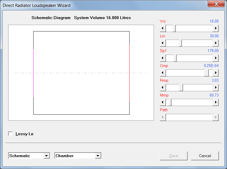

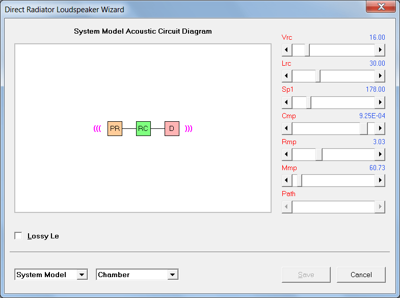

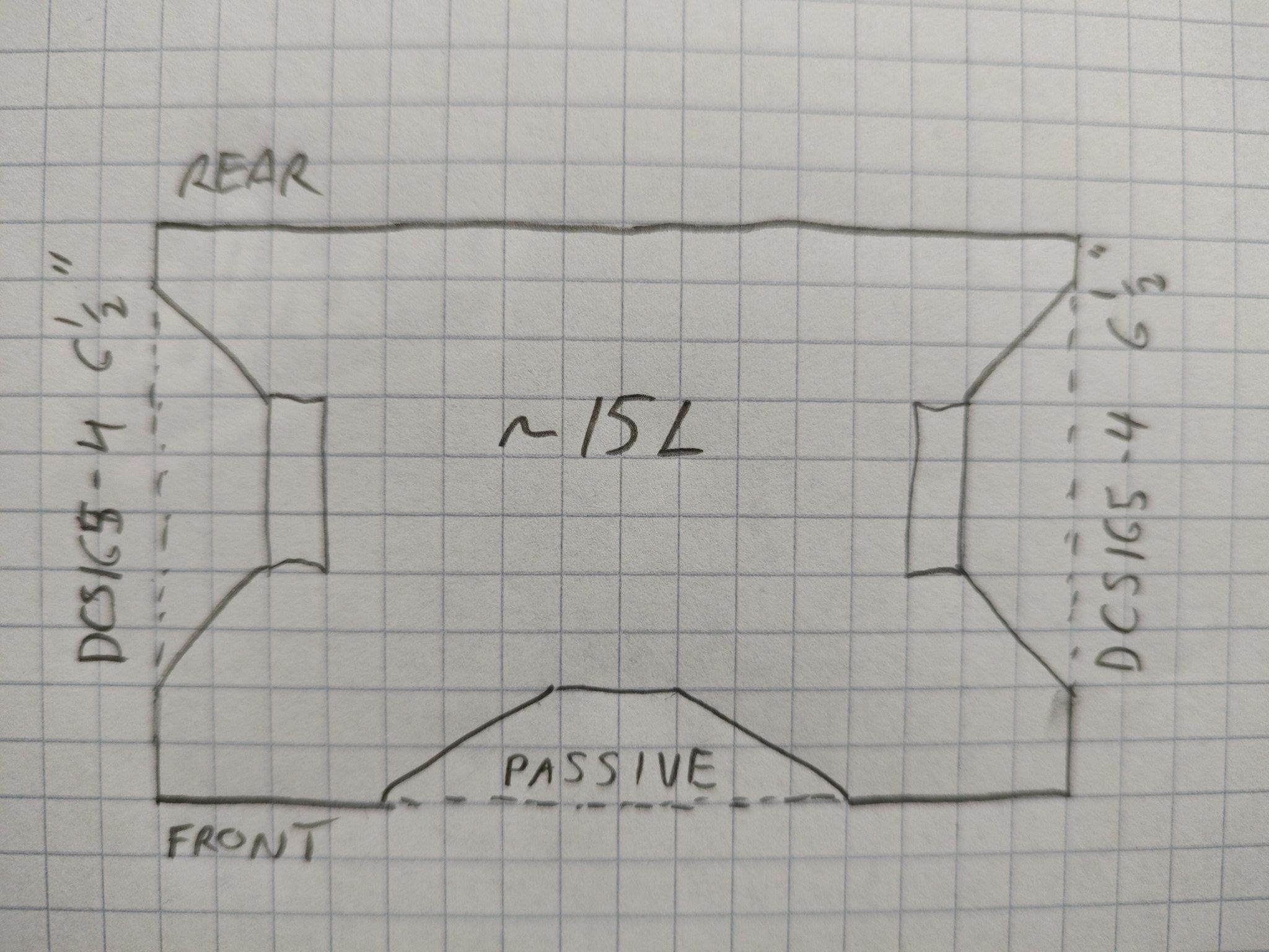

I'm trying to model this in hornresp. It's a ~16L box with two Dayton DCS165-4 6.5" subs in the sides, and a single 5x8 PR in the front. I just chose a Chamber Type = PR, and Loudspeaker Configuration = Normal Nd, with two drivers in parallel.
The resulting curve looks promising, but not sure if the model is correct.
Hi trohricht,The resulting curve looks promising, but not sure if the model is correct.
Your model is fine.
When in doubt, checking the Schematic Diagram and/or System Model sometimes helps to clarify things.
One thing to keep in mind is that the Hornresp model assumes that multiple drivers are close together, and treats them as a single composite driver (with diameter of the driver shown in the schematic diagram being based on 2 x Sd in this case). For your design, the model will be valid at bass frequencies because the physical distance separating the two drivers is a fraction of a wavelength.

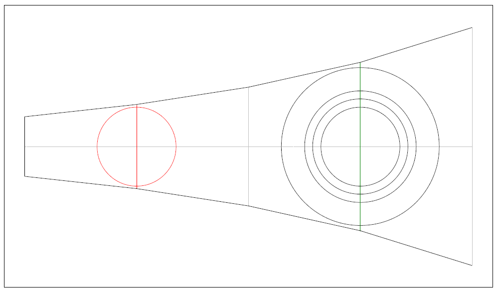

The format of the Hornresp record export file has been changed as shown in Attachment 1, to hopefully make it easier to understand. The BOXPLAN export file remains unchanged.

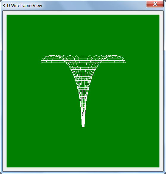

Previously the orientation of the single segment horn in the 3-D View tool could only be changed by dragging the mouse pointer. Now the position can also be altered using the Up, Down, Left, Right, Page Up, Page Down, Home and End navigation keys. Attachment 2 shows the orientation when the PageUp key is pressed, for example.

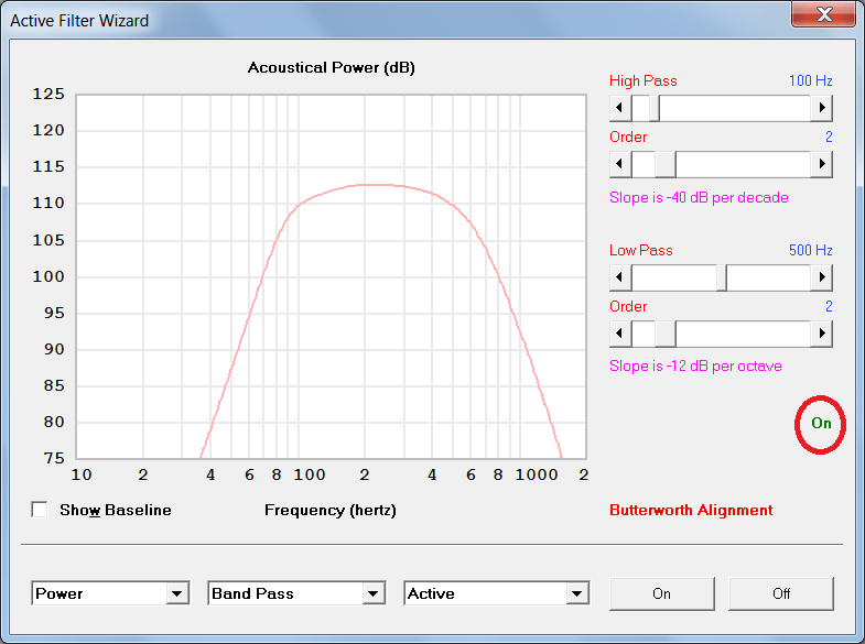

The active filter in the Filter Wizard can now be switched on or off as shown in Attachment 3, similar to the equaliser filter bands.

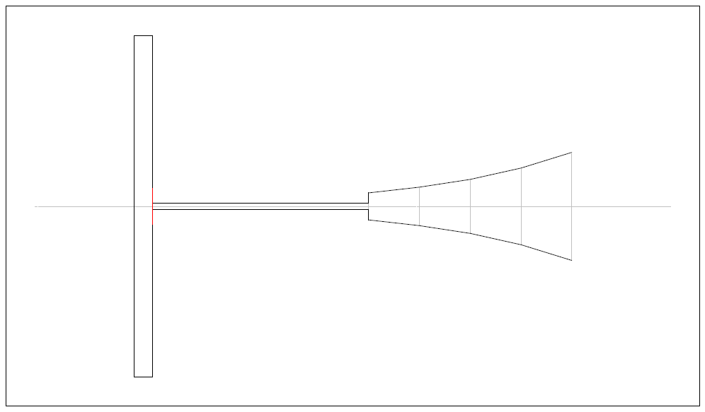

Paraflex horn schematic diagrams were not being printed correctly, as shown in Attachment 4. This has now been fixed, as shown in Attachment 5.
