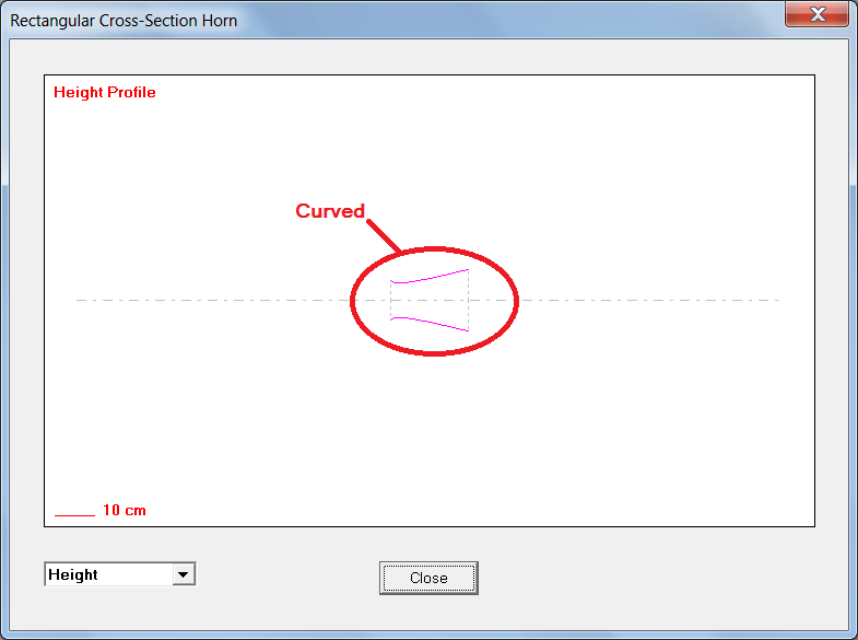

Thanks - so I can build the throat and mouth areas and just connect them, in this case, with plane sides?It is up to you to choose the cross-sectional shape for the actual horn you wish to build. Just keep the cross-sectional areas the same as those used in the simulation.

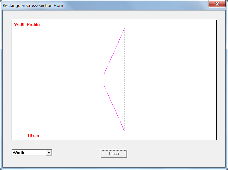

Only when the conical horn has square cross-sections at the throat and mouth, or when the cross-sections at the throat and mouth are rectangular and have identical aspect ratios.
Otherwise, if two opposing sides are plane, then the other two will need to be curved to retain the overall conical area expansion rate.
To illustrate the above, if S1 = 100, S2 = 1600 and L12(Con) = 20, and if the throat is square (10 H x 10 W) and the mouth is rectangular (eg 16 H x 100 W) then the sides of the conical horn will be as shown in the attachments.

OK, I understand. I also see the Height and Width options in your pictures but don't seem to have them on my computer.... what am I doing wrong? Rectangular Cross Section - how do I view that?Only when the conical horn has square cross-sections at the throat and mouth, or when the cross-sections at the throat and mouth are rectangular and have identical aspect ratios.
I will need to read up "a bit" also in general. Thanks!

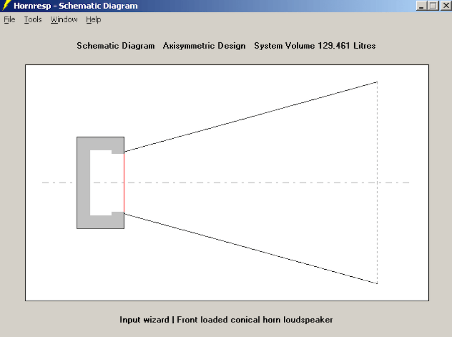

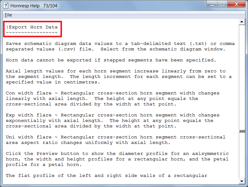

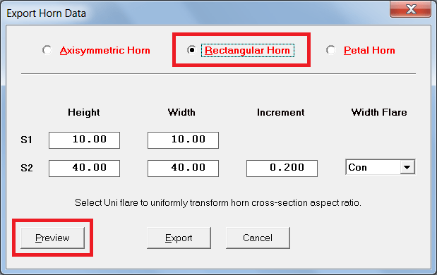

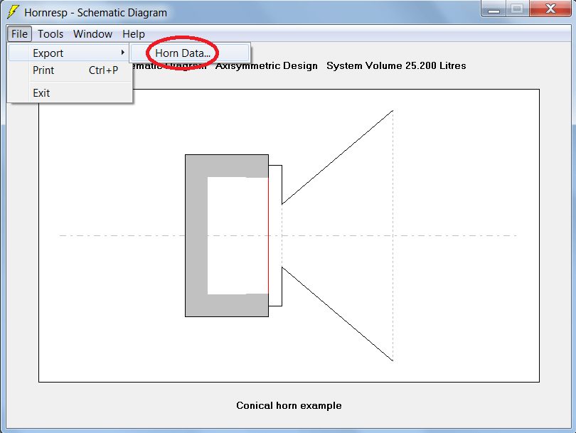

1. Select the File > Export > Horn Data... menu commands from the Schematic Diagram window, as shown in Attachment 1.
2. Select the Rectangular Horn option, set the Height and Width dimensions and then click the Preview button, as shown in Attachment 2.
It's all explained in the Export Horn Data section of the Help file 🙂.

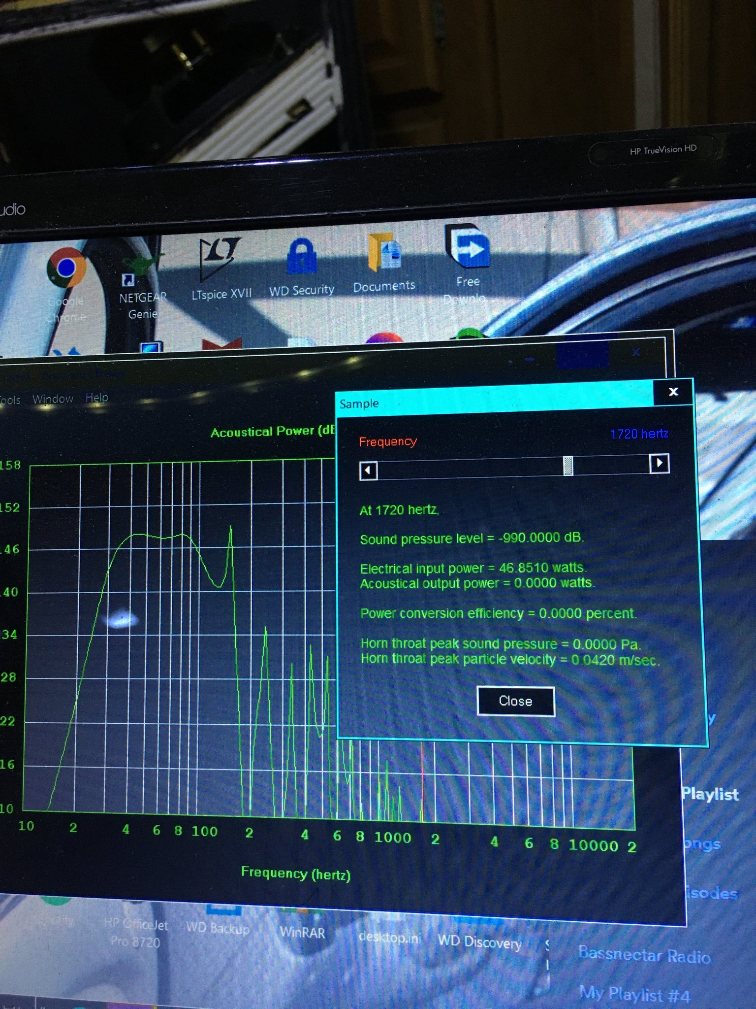

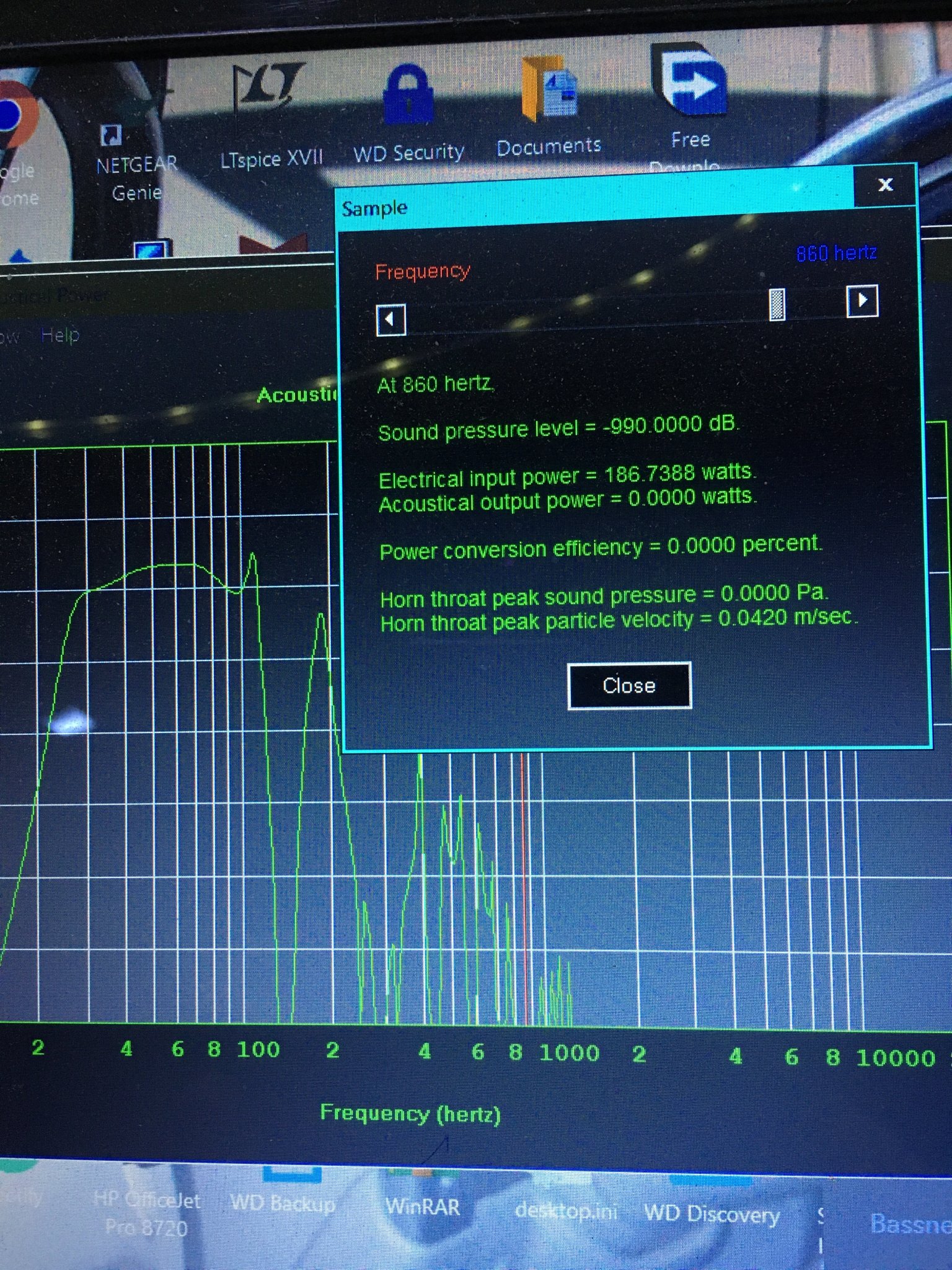

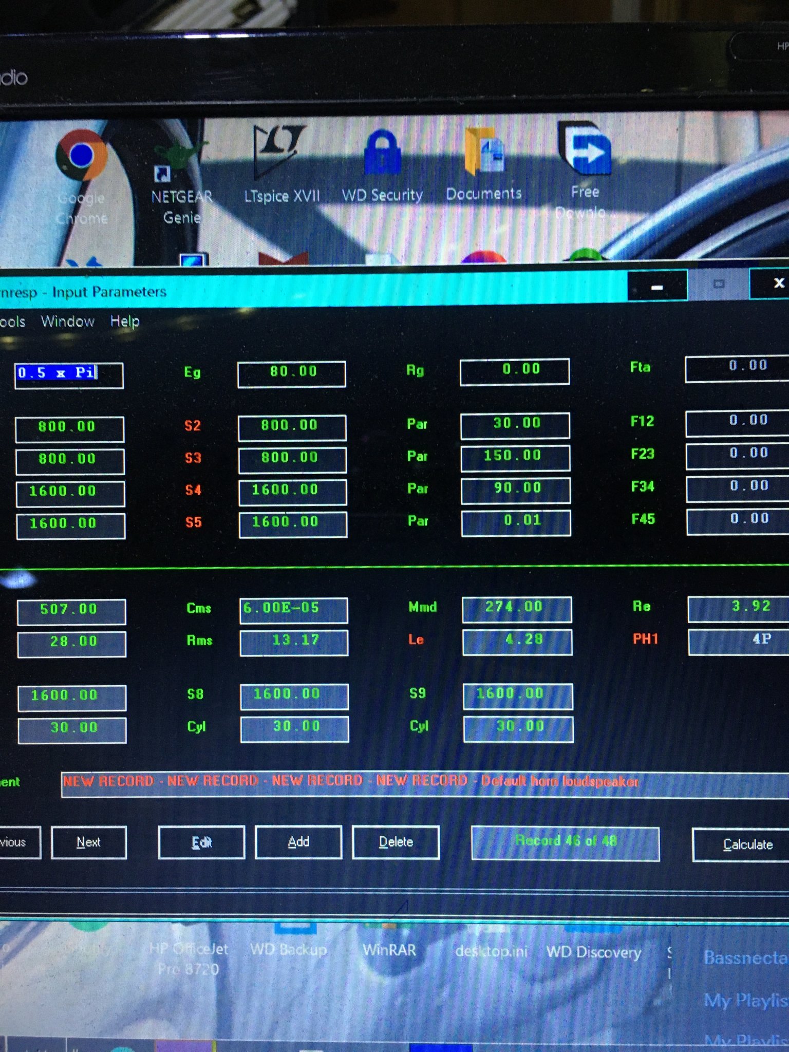

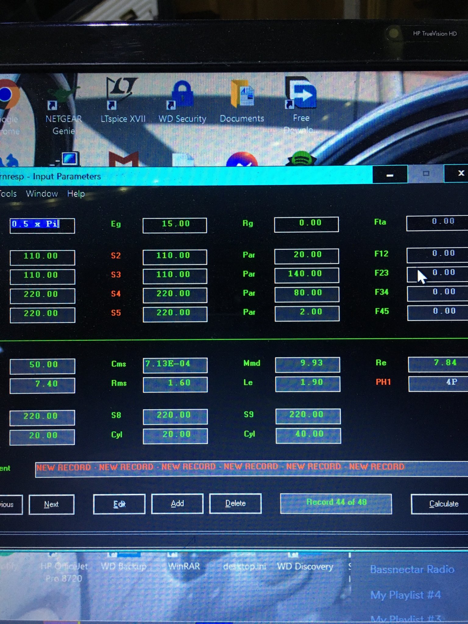

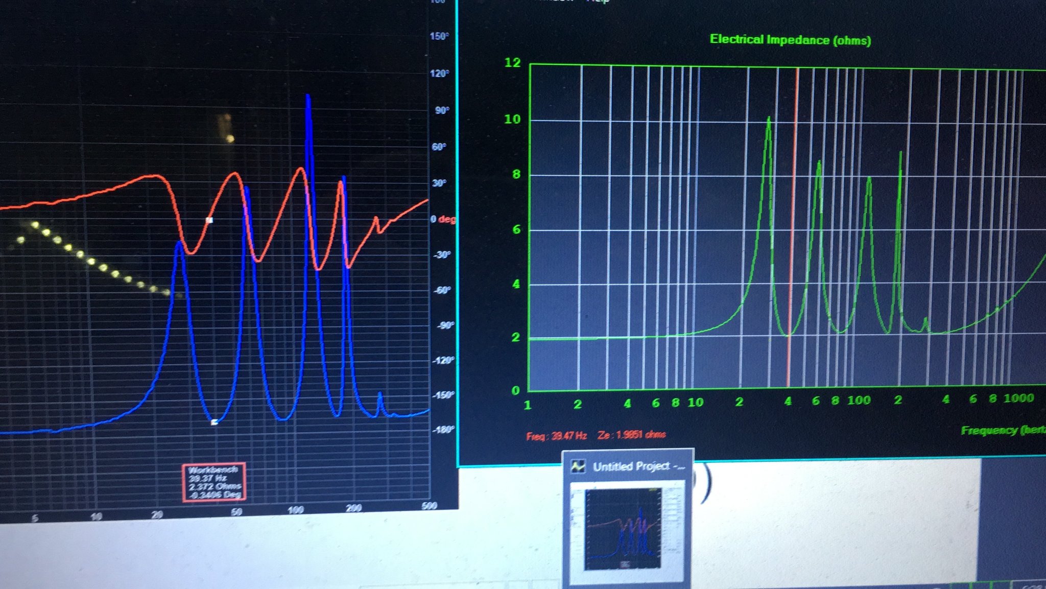

What would the Best description of the scenario where a horn response is wiping out 😂👍🏻 frequencies from existence? It Makes sense actually.. it’s just describing it in a way that’s very serious about it.
As this frequency (860hz) and then the subsequent frequencies there after also, such as 1720 and 2580 and 3440, and on out all the way… 19870…all with -990 DB and no pressure/velocity And then the next it’s right back up to 40/80/90dB..+ and beyond in the surrounding area with in the very next hz… then repeat..
So it’s very specific and incredibly interesting if you look at what those numbers represent outside of sound and 1/4 wave length based speakers…. Where the heart and soul of economics , astrophysics, I don’t even know what else, they’re pretty important! .. and so they’re really really interesting.
The idea is lining up both sides of the drivers output ‘perfectly’ Which judging by the measured impedance (pic ) and any of the details of the simulation info (50cm2 Sd x4 drivers sim pic) it is absolutely amazing ! the spot on bandwidth and info, details verbatim. It’s almost scary how impressive it is!! 👍🏻

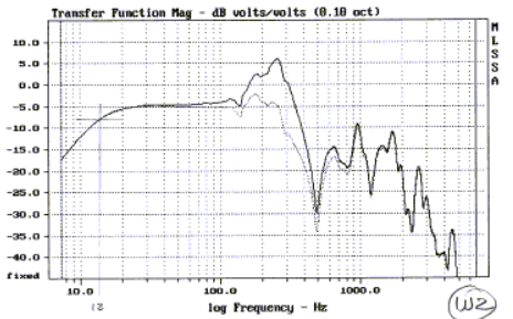

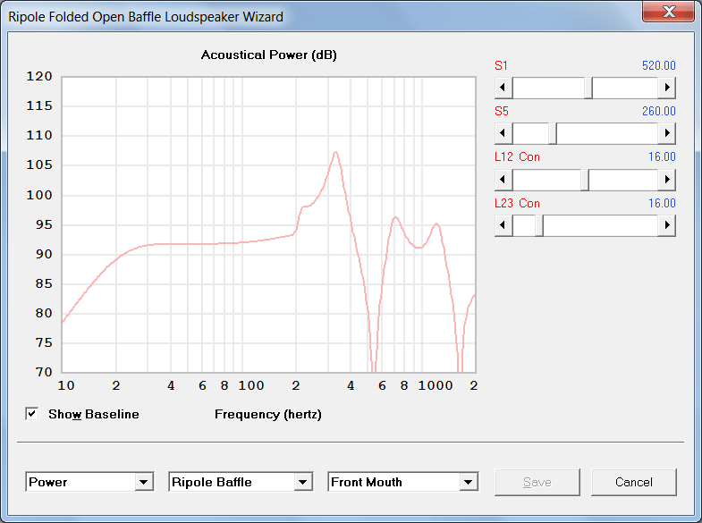

I decided to show only the front mouth output so that it could be compared against an AkAbak simulation and set of measured results that I came across, both of which, for whatever reason, only took the one output into account.

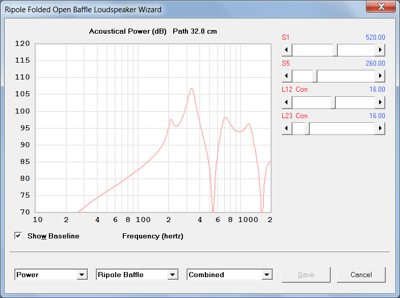

I am no expert on Ripole loudspeakers, but it seems to me that because the combined output will be significantly reduced at low frequencies due to the two outputs being out of phase, a practical loudspeaker would need to be positioned and oriented such that the output from the rear was not a significant contributor to the overall response observed by the listener.
Attachment 1 shows the Hornresp front mouth output simulated results.
Attachment 2 shows the AkAbak simulated results.
Attachment 3 shows the measured results.
Attachment 4 shows the Hornresp combined output simulated results.
The dimensions and driver of the Ripole system simulated in Hornresp are not the same as those of the system simulated in AkAbak, and the measured system is different again, but the general characteristics of the three responses are quite similar.

Which the response the user would more likely experience, the combined or one sided?
Because the combined response looks quite anemic below 80 Hz, which is where a woofer's work actually starts.
Giri
Hi Giri,
Kind regards,
David
As I said, I am no expert on Ripole loudspeakers 🙂. I am not sure how they are actually set up and used in practice, hopefully someone with more experience in such matters may be able to comment further.Which the response the user would more likely experience, the combined or one sided?
Agreed. As far as I can see any dipole-type system is going to be significantly compromised at bass frequencies unless one of the outputs is effectively "isolated" from the listener in some way.Because the combined response looks quite anemic below 80 Hz, which is where a woofer's work actually starts.
Kind regards,
David
