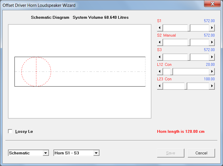

BUG FIX
The bug identified in Post #12,771 has now been fixed.
Given L12 = 20.00 cm and L23 = 100.00 cm:
Attachment 1 shows the L12 + L23 horn length incorrectly as 120.10 cm before the fix.
Attachment 2 shows the L12 + L23 horn length correctly as 120.00 cm after the fix.
My thanks to GM for reporting the problem.
Kind regards,
David

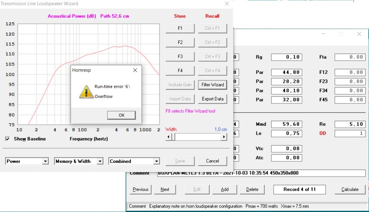

Hi and thanks to all of you.
Is possible to pass on to the filter wizard after filling options applied?
Because i get this error when doing that:
If i do not apply filling i can get the filter wizard running, same record. Something wrong in the record or in my sequence use of HR features ?
I found this problem discussed here: https://www.diyaudio.com/community/threads/hornresp.119854/post-6333381
I deleted all hr files, reinstalled last version and imported the record from BSteele boxplan mltl3.
Same error in opening filter wizard after applying filling, no error without filling. Is there anything to do after applying filling and before
going to filter wizard? Thank you, all.

At the moment of the switch to filter wizard, yes Fr1-2 were not empty fields.Have you tried it with some value in Fr1 - 4?
But even if i load the same record with Fr1-2 values already in (record file edited), same error.
I found a limit in Fr values here, at least with this record.
If i set values > 600 in Fr1-2 i get the overflow error. I did not try any possible number but till 600 is good, i can
go on to the filter wizard and continue the simulations...... greater values as 650, 675, 700, 800 -> error overflow
Hi deepboy,
The absorbent filling material model used in Hornresp is a very good one, but it breaks down mathematically at high frequencies and under certain conditions can also become inaccurate at lower frequencies, due to numerical overflows and underflows. There is nothing that can be done about this, it all depends upon the segment geometry and the Fr1 and Tal1 values specified for that segment. Rather than producing inaccurate results, the Loudspeaker Wizard generates an advisory message instead, as shown in the attachment.
To reduce the chances of the model breaking down, Loudspeaker Wizard charts are limited to a maximum frequency of 2000 Hz when absorbent filling material is specified. The Filter Wizard currently does not have this same constraint.
In your original example the absorbent filling material model breaks down at a frequency higher than 2000 Hz. This is outside the frequency range of the Loudspeaker Wizard so the results it shows are valid, but when the Filter Wizard is then selected it considers frequencies up to 20000 Hz and sees the overflow, thus generating the run-time error message.
Thanks for bringing this problem to my attention, it will be fixed in the next update.

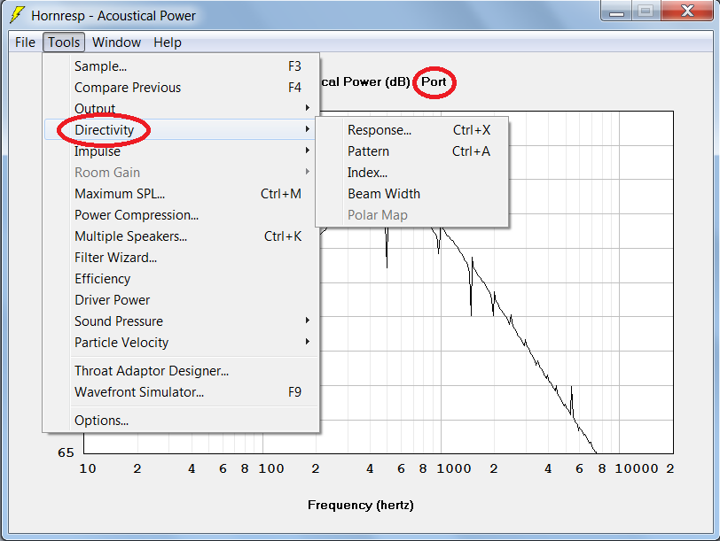

Hi David -- Another thing I keep forgetting to ask if you have a minute to look.
CH1 O(F)P's: Would it be a big pain to try to flip the "Port" and "Horn 2" outputs selected in the Tools->Output menu? We can get directivity, pressures etc. for the "Horn 2" but the output is actually the port so it'd be more useful the other way (though I admit looking at port output spectrograms has been interesting). Alternatively, maybe enabling the calcs for both outputs is easier?
Here's a wizarded CH I chopped into a CH1OP as an example case just to show the outputs flipped.
Thanks for looking and for all you do!

Hi grindstone,We can get directivity, pressures etc. for the "Horn 2" but the output is actually the port so it'd be more useful the other way
I have had a quick look, and with a bit of work I think that it should be possible to give you Directivity Response, Pattern, Index and Beam Width for the port, but not Polar Map, which would require just too many coding changes. Would this be okay?
The Horn 2 Directivity tools would remain as they currently are.
Kind regards,
David

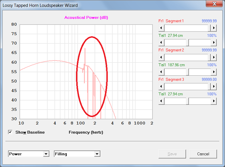

Hornresp Update 5400-220725
Hi Everyone,
CHANGE 1
The Loudspeaker Wizard now detects when the absorbent filling material model begins to break down and displays the "Fr1 is too large" message at that point rather than waiting for a numerical overflow or underflow calculation error to actually occur.
Attachment 1 shows how the power response can be corrupted as the model begins to break down. This erroneous result would previously have been displayed.

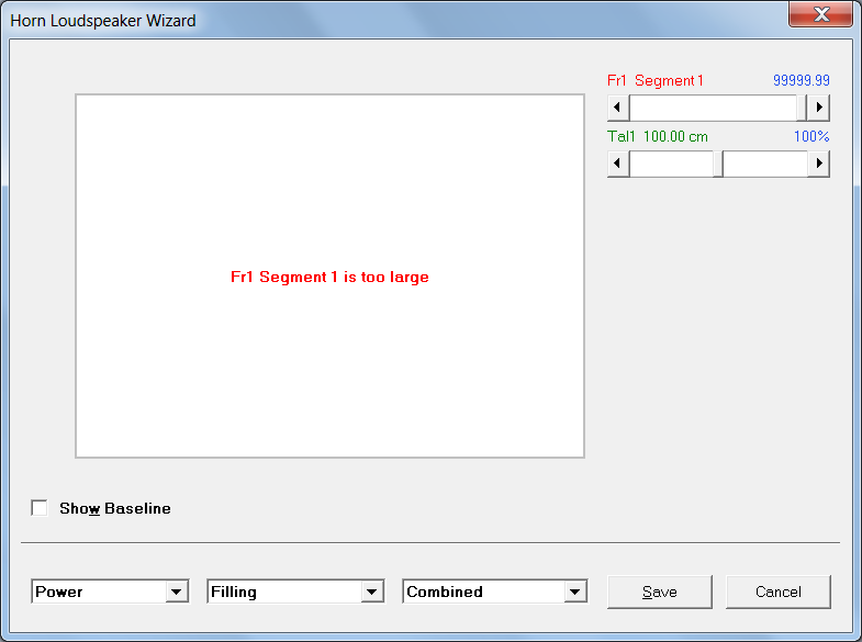

Attachment 2 shows the message that is now displayed at the point that the model begins to break down.

The Directivity tools can now be used with either Output 1 or Output 2, and are applicable to direct radiating single drivers, single passive radiators, finite single-segment non-negative flare horns with no throat adaptor, and non-negative flare ports. The Directivity tools sections in the Hornresp Help file have been updated accordingly.
Specifically, the Directivity tools now apply to the offset port in a CH1 system with closed mouth. Post #12,791 refers.
Also, the time it takes for the Directivity Polar Map to be calculated has been reduced in some cases by up to 70 percent.
NOTE - This change has been extensively tested but there are so many possible system configurations that something may have been missed. Could you please report any problems or inconsistencies found while using the new functionality.
