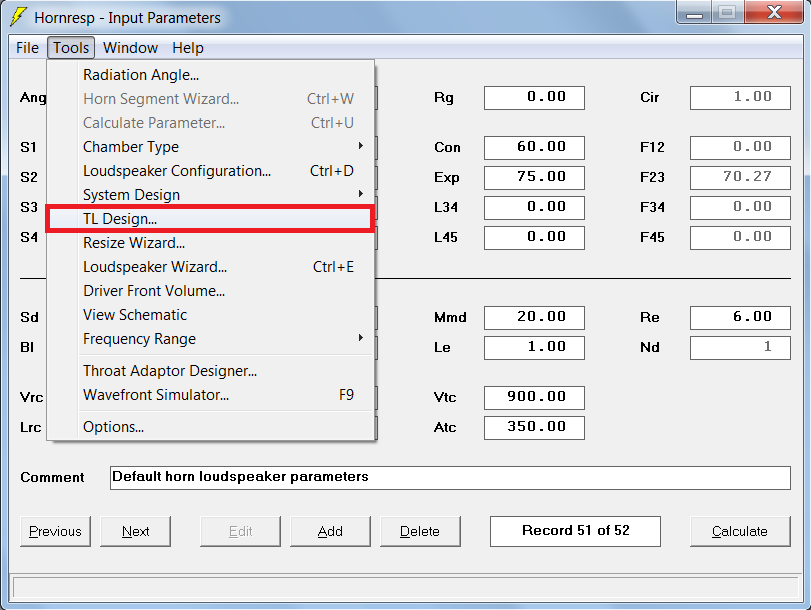

Hornresp Update 5420-220827
Hi Everyone,
CHANGE 1
A transmission line loudspeaker design tool has now been added, as suggested by Giri in Post #12,828.

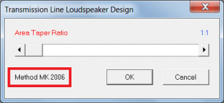

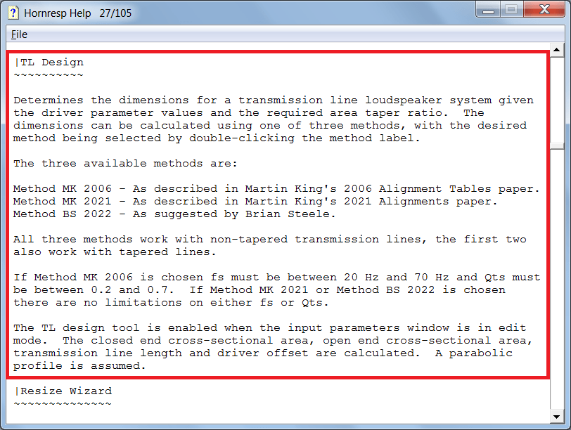

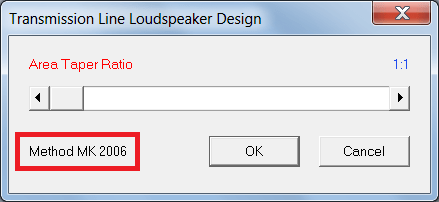

The tool determines the dimensions for a transmission line loudspeaker system given the driver parameter values and the required area taper ratio. The dimensions can be calculated using one of three methods with the desired method being selected by double-clicking the method label (highlighted in Attachment 2).
The three available methods are:
Method MK 2006 - As described in Martin King's 2006 Alignment Tables paper.
Method MK 2021 - As described in Martin King's 2021 Alignments paper.
Method BS 2022 - As suggested in Brian Steele's Post #12,836 but with the Qts ^ 3 refinement from Post #12,839.
All three methods work with non-tapered transmission lines, the first two also work with tapered lines.

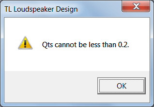

If Method MK 2006 is chosen fs must be between 20 Hz and 70 Hz and Qts must be between 0.2 and 0.7.
If Method MK 2021 or Method BS 2022 is chosen there are no limitations on either fs or Qts.
The TL design tool is enabled when the input parameters window is in edit mode. The closed end cross-sectional area, open end cross-sectional area, transmission line length and driver offset are calculated. A parabolic profile is assumed.
