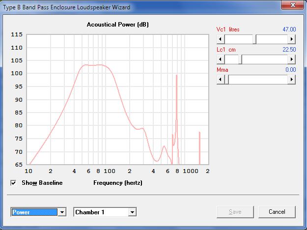

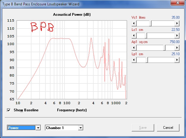

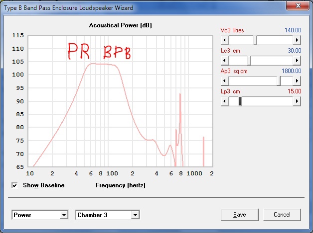

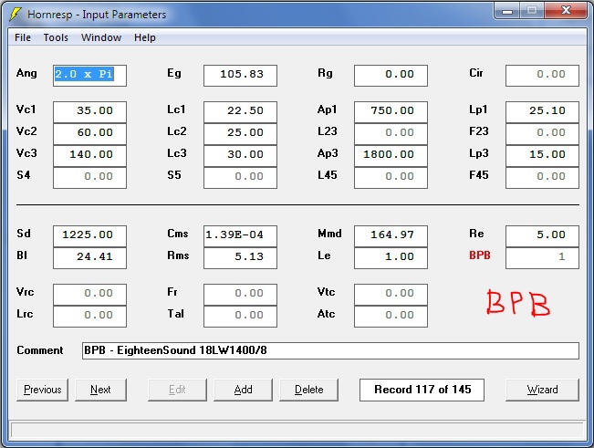

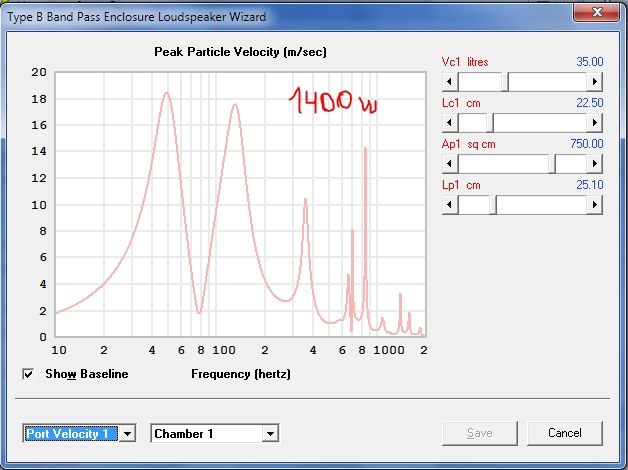

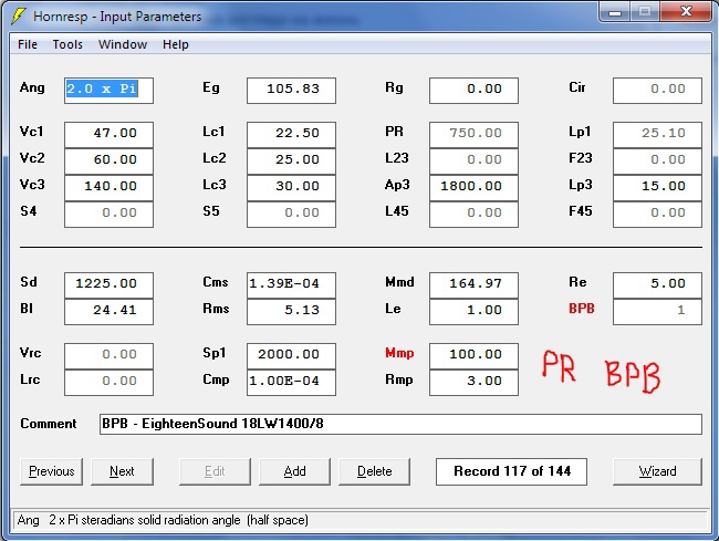

I tested Hornresp's new feature - PR on Band Pass type B and it works! I tested the EighteenSound 18LW1400/8 driver and compared ported version and PR - version of the enclosure. At 1400W peak power, the Vented version has an air velocity about 20m/s in port 1. If I increase port area, it gives me a dip between two peaks. And if I replaced the port by a PR(2*15in), it has no high air speed problem and it gives the same frequency responce. As I think, this feature is worth it if we has powerful driver with high RMS and excursion.
I think replacing Port 1 with PR will give the same result also for PBC and DBR.

BPBV = f3 of 45hz.
BPBPR = f3 of 50hz.
That's not an apples to apples comparison.

BPBPR = f3 of 50hz.
I tuned BPB lower and here's 45hz BPBPR
the point is not in the frequency range, but in the fact that it does not have a high air velocity in port 1

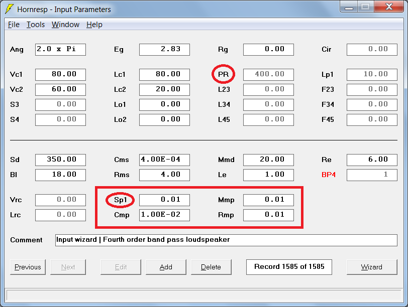

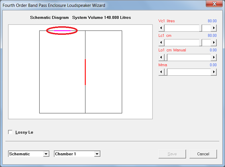

Is it possible to replace port with PR?
Yes, but not in the Input Wizard. With the record in Edit mode, press the Ctrl key and double-click the Fr label to specify a passive radiator. Then double-click the Ap1 label to replace the port with the specified passive radiator.

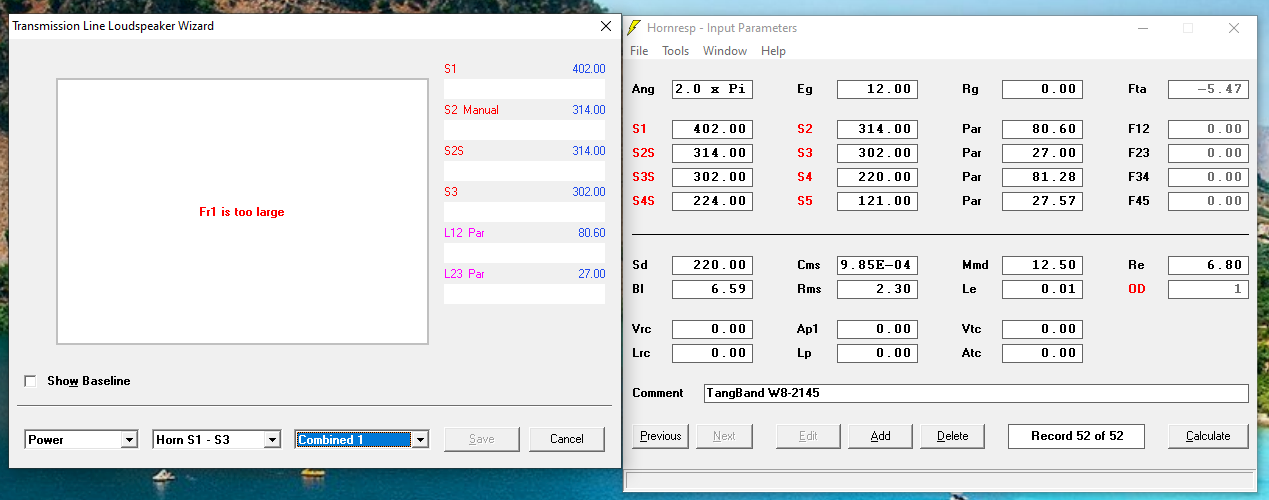

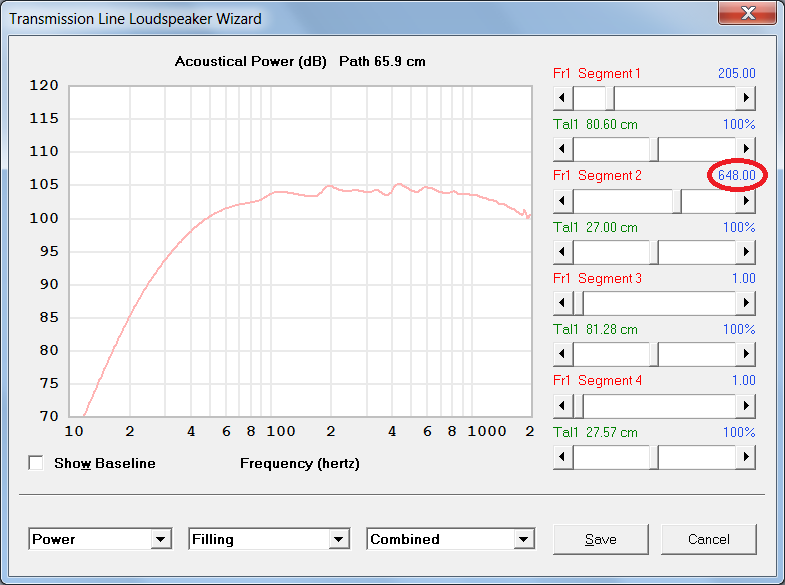

Another question: when I have the Input Parameters for each segment set to Par on a new record I am trying, when I open the Power dialog in the Loudspeaker Wizard, I get the error message Fr1 is too large. What do I need to change?
Sometimes if you just change some geometry, display another output, and then change it back it'll pick-up again. Otherwise, I just bail from the Wizard and re-enter it and then don't do what I just did and the Fr1 too large doesn't happen 🙂 It definitely doesn't go away by making Fr1 zero. At least that's my system...

Would it be possible to provide the input parameter values that generate the error message, so that I can investigate further? Thanks.

Hi David, I am attaching the HR export file.

Thanks Neil. I have checked it out and everything is operating as it should. The absorbent filling material model used in Hornresp is a very good one, but breaks down mathematically at high frequencies and under certain conditions can also become inaccurate at lower frequencies, due to numerical overflows and underflows. There is nothing that can be done about this - it all depends upon the segment geometry, and the Fr1 and Tal1 values specified for that segment. Rather than presenting inaccurate results, an advisory message is generated instead.
For your example, reducing the value of Fr1 in segment 2 from 999.90 down to 648.00 will fix the problem.
