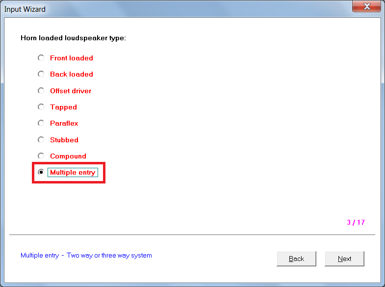

hello I NEED HELP TO LEARN TO SIMULATE A SYNERGY HORN, I HAVE A 4X8 "AND 4X6" OUTLINE AND A 2 "THROAT CD ... COULD YOU HELP ME?
The easiest way to get started is to create an appropriate multiple entry horn "template" using the Input Wizard, and to then alter the input parameter values to suit your specific design. Also, read the "Two-Way or Three-Way Multiple Entry Horn" section in the Help file.

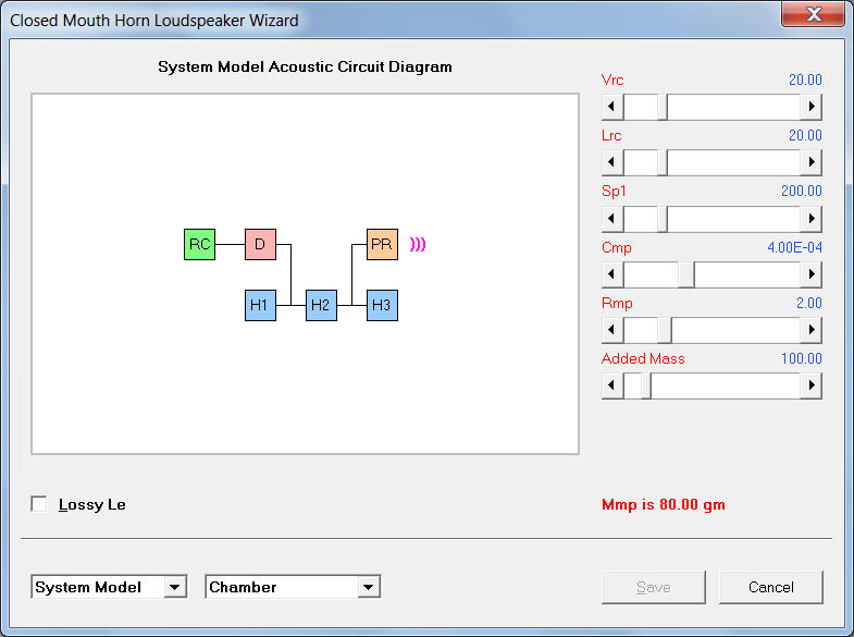

Hi Everyone,
CHANGE 1
Previously it was not possible to switch a BP6 or BP8 design from series to parallel in the loudspeaker wizard if a passive radiator had been specified. This restriction has been relaxed so that it now only applies to a BP6 parallel design with a passive radiator at port 2.
CHANGE 2

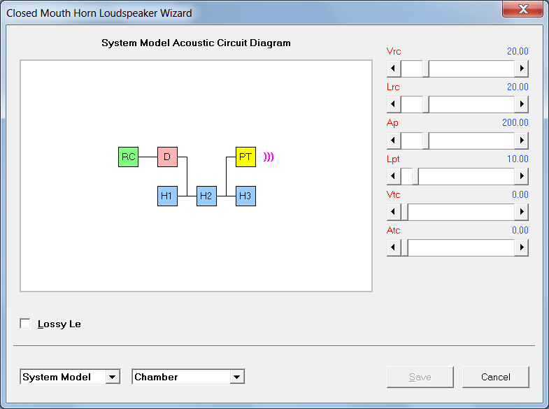

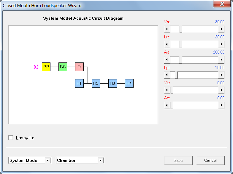

The different topology for an offset driver / offset port system with closed rear chamber requested by Brian in Post #11959 has now been implemented. Either a port tube or a passive radiator can be specified - see Attachments 1 and 2. The modified topology applies to three segment systems only.
CHANGE 3

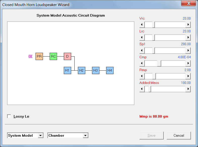

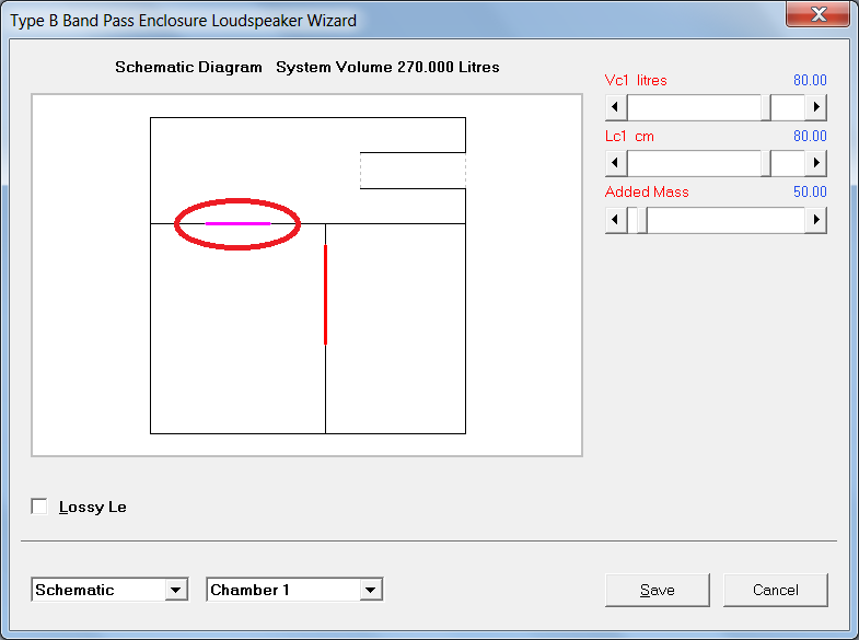

Port 1 in a BPB design can now be replaced by a passive radiator, as requested by Artem in Post #12052. Attachment 6 refers.
CHANGE 4

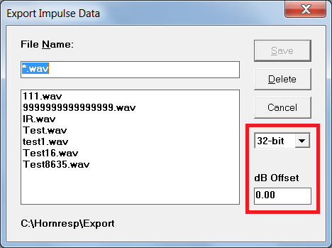

Impulse response data can now be exported as either a 16-bit integer or 32-bit floating point PCM wave sound file. Attachment 7 refers.
My thanks to bolserst for providing the necessary 32-bit file format details.
CHANGE 5

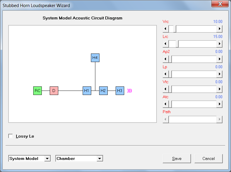

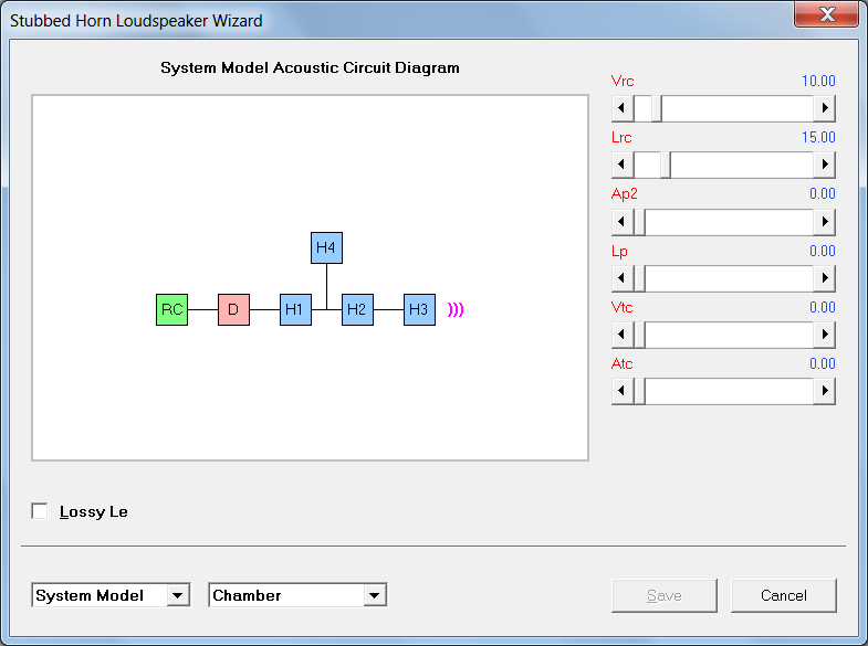

Previously, when components were omitted from a loudspeaker design, gaps were left in the system model acoustic circuit diagram. Except for tapped and multiple entry horns, this is no longer the case. For example, Attachment 8 shows the old system model diagram for a stubbed horn SH2 design with throat chamber and absorber chamber port tube omitted. Attachment 9 shows the new diagram.
BUG FIX
The electrical impedance was not being shown correctly when the lossy inductance option was selected in an offset driver / offset port type design (Posts #11968 and #11969 refer). This has now been fixed.
My thanks to freddi and Brian for identifying the problem and for bringing it to my attention.
Kind regards,
David

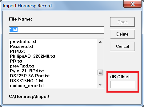

if I do an impulse export and import it into REW, it is about 23dB higher than reference.
Does using the new 32-bit export option, with appropriate dB offset value, fix the problem?

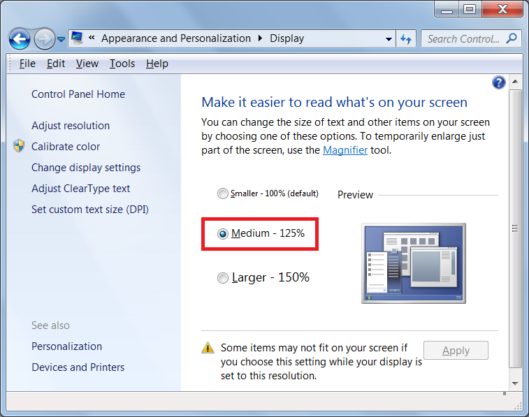

Anyway to enlarge HR to where I can see it better?
Hi GM,
I don't know what the equivalent would be in Windows 10, but in Windows 7 I use the Medium (125%) Text setting to enlarge Hornresp to the size I want.
To set the text size in Windows 7: Control Panel > Appearance and Personalization - Adjust screen resolution > Change the appearance of your display - Make text and other items larger or smaller > Medium - 125% > Apply.
(I use a display resolution of 1600 x 900 pixels).
Kind regards,
David
I use 150% in W10 on my home laptops and desktop. I use 175% on my work laptop. All with 1080p HD. The work laptop is connected to 2 x 27" monitors in the office and a 55" 4K TV at home.

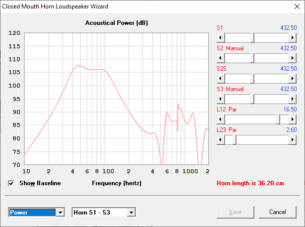

Please let us know if you are successful in doing so.

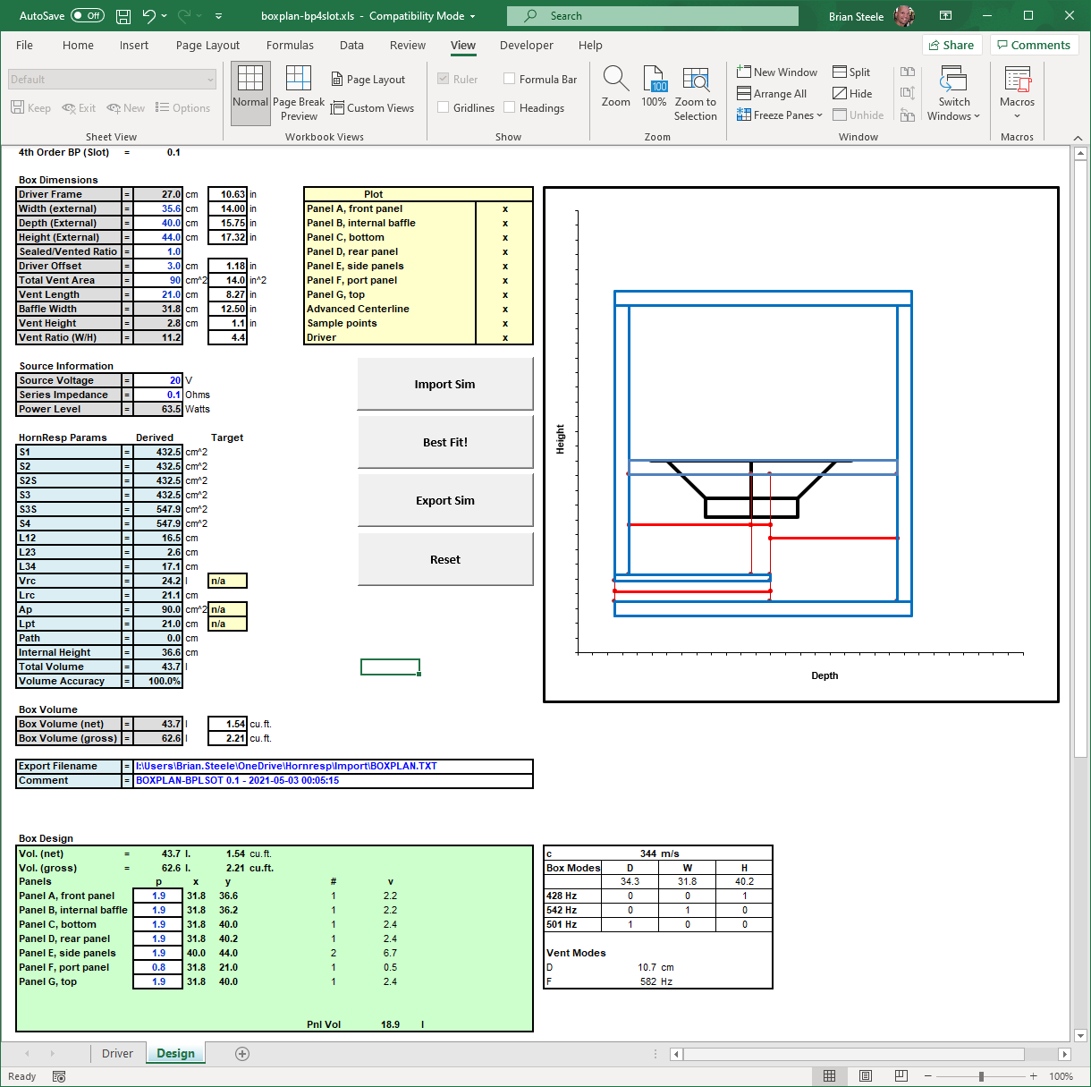

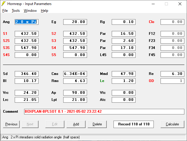

I'm happy report that, by using the updated Hornresp model, the corresponding response predictions from Hornresp are the closest that I've ever seen to the measured performance of the Enigma 🙂
This bodes well, because it suggests that it might actually be possible to use Hornresp to design a 4th order BP system with minimized out of band noise, and the measurements will be pretty close to the sim'd performance.
I'm happy to also say that the new model also gives me some ideas of how the Enigma's performance can be improved even further, as the sim suggests that the box is still tuned a little low. Maybe it's time for Enigma v2 🙂.
Now, if only Hornresp would also accept filling data from the BOXPLAN import file... 🙂
Excellent, thanks for the feedback.
That would mean modifying the format of the BOXPLAN import file, which could cause problems for us both. I would not want to have two different versions of the file in use (ie. one with, and one without, filling data). Also, the filling would not apply to BP type cabinets.
At the moment filling can be specified in the Loudspeaker Wizard and adjusted there as necessary as each refinement to a BOXPLAN design is imported using F6. The final optimised design settings can then be saved to the permanent Hornresp record.
This new model allows me to include the effects of filling though (see attached).
No biggie. The way I'd probably approach it is to ignore filling data if not included in the import file, but it's no real biggie - it's easy enough to adjust in the Loudspeaker Wizard anyway.
I experimented with importing filling data from BOXPLAN but I don't like the functionality 🙂.
After adjusting the filling values in the loudspeaker wizard to optimise the performance for a given set of cabinet dimensions, importing a design iteration using F6 sets the filling sliders back to the BOXPLAN values. I find it much easier to use if the filling sliders remain as previously adjusted. Trying to "guess" the correct filling values to enter into BOXPLAN to then import into Hornresp for a given design iteration is virtually impossible.
In other words, it's not going to happen 🙂.
