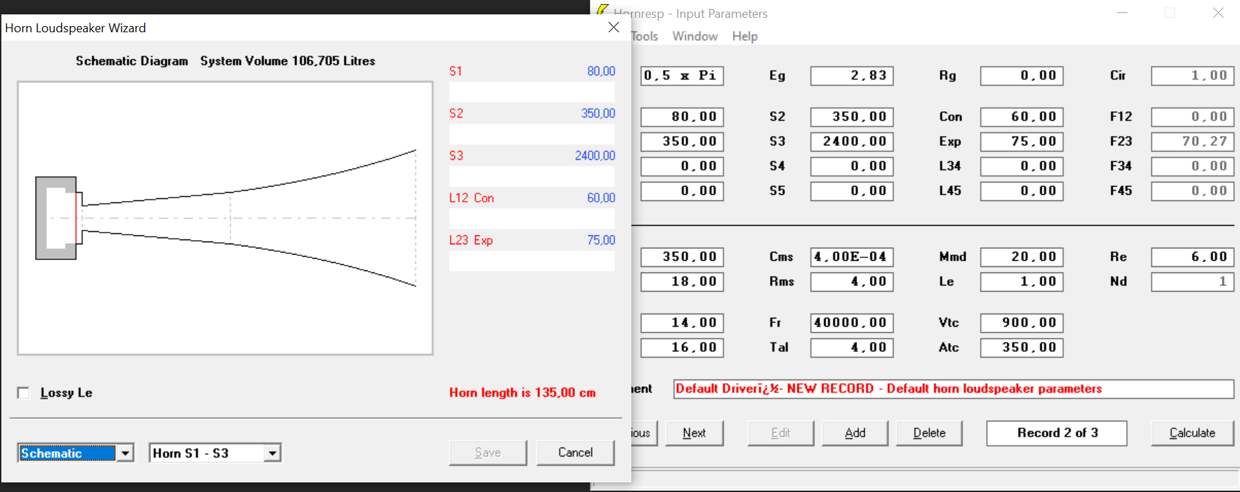

It´s not that I just don´t see the slidebars, I´m also not able to change any of those values
did you follow post 11999 https://www.diyaudio.com/forums/subwoofers/119854-hornresp-1200.html#post6621242 and previous posts about similar problem?
Didn´t see that before, but windows is up to date and Hornresp is located in the correct location, still it doens´t work :/
