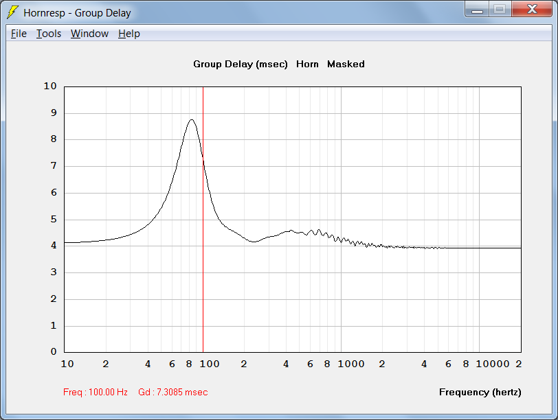

As far as Hornresp is concerned, group delay is the time delay of the signal through the loudspeaker as a function of frequency. In an ideal loudspeaker the phase would be linear and the group delay constant. In reality however, group delay distortions occur because signals at different frequencies take different amounts of time to pass through a practical loudspeaker. To illustrate - in the example attached, the time delay varies considerably across the frequency range, with the value at 100 hertz being 7.3085 milliseconds.
The key issue is at what point does group delay become audible...

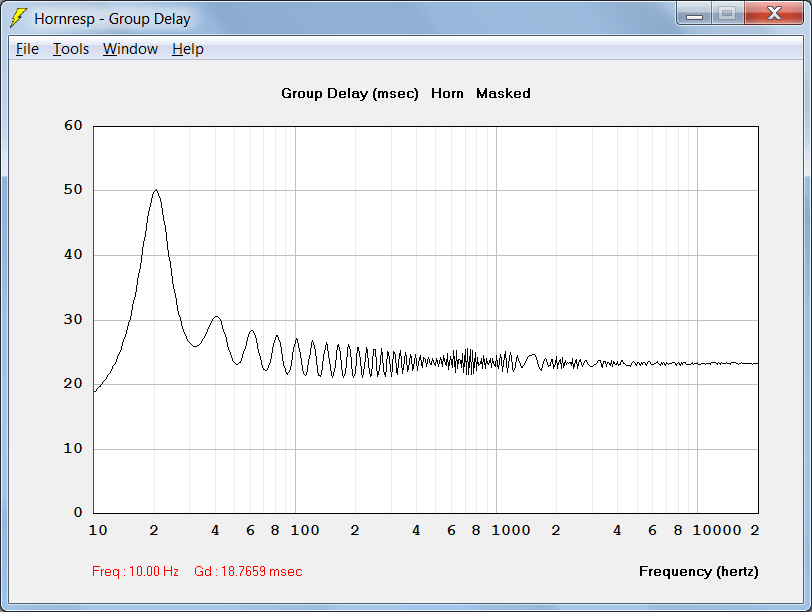

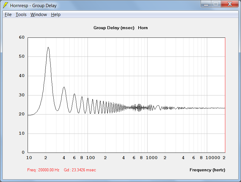

Has an Fc of 14 hertz and 8 meter length. Group delay was colossal.
The attachments show the predicted group delay results for a representative 14 Hz exponential horn of length 8 metres. At 20KHz the signal delay is almost entirely due to the time it takes for the sound to travel through the horn. At high frequencies the delay through the drive unit itself is relatively small.
At 20KHz:
Predicted signal delay = 23.3426 milliseconds
Horn length = 8 metres
Velocity of sound = 344 metres per second
Delay through horn = 8 / 344 * 1000 = 23.2558 milliseconds
Delay through driver = 23.3426 - 23.2558 = 0.0868 milliseconds
It is interesting to note that at 10Hz the signal through the system is delayed by 18.7659 milliseconds, meaning that for the chosen example at least, at that frequency the delay through the driver has a negative value of 18.7659 - 23.2558 = -4.4899 milliseconds.
