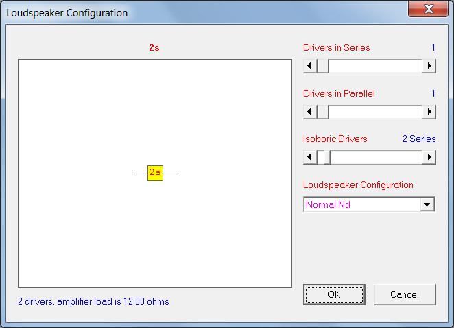

Not sure if it answers the question, but isobaric driver configurations can be specified for any loudspeaker system type using the Loudspeaker Configuration tool. Attachment 1 shows the slider setting for two isobaric drivers connected electrically in series. Attachment 2 shows the slider setting for two isobaric drivers connected electrically in parallel.

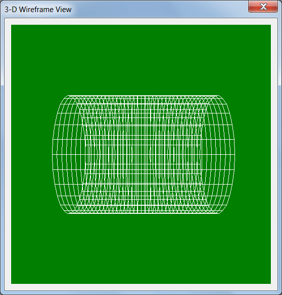

CHANGE 1

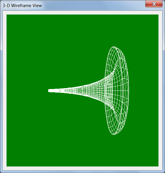

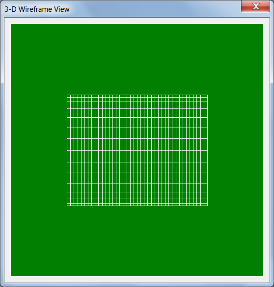

The forced perspective present in the 3-D View tool has been removed. Images can still be rotated by the user if required. Attachments 1 and 2 (before) and 3 and 4 (after) refer.

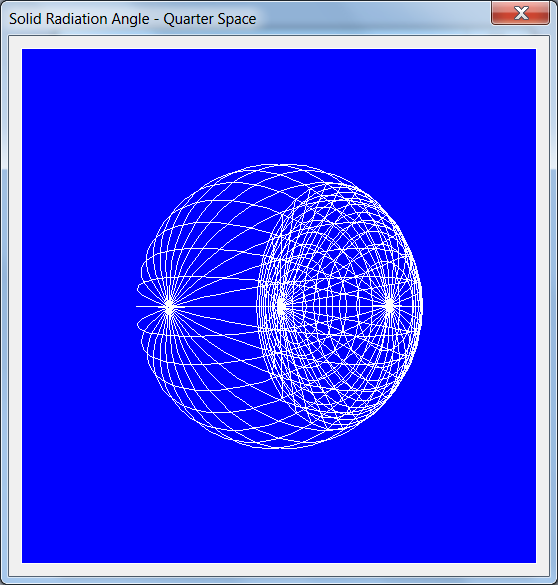

CHANGE 2

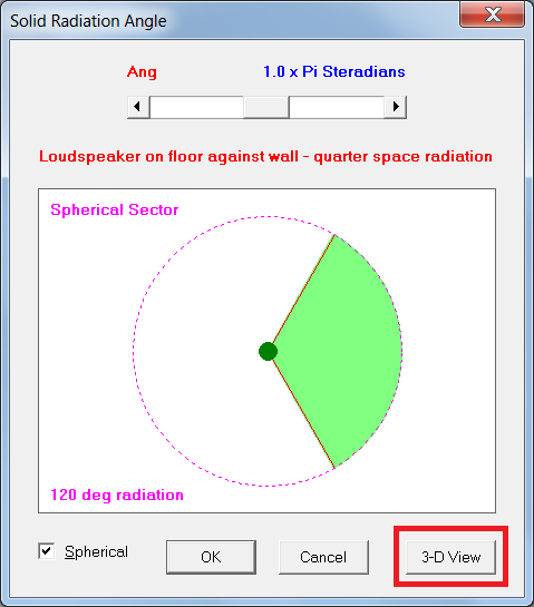

When the Spherical option is selected in the Radiation Angle tool, solid radiation angles can now be viewed in 3-D. The images can be rotated by the user if required. Attachments 5, 6 and 7 refer.

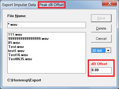

The dB offset associated with exported 32-bit impulse response data can now be entered as either an rms (default) or peak value. Double-clicking on the dB Offset label changes the setting. Attachment 8 refers.

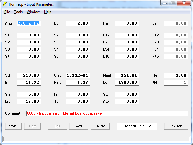

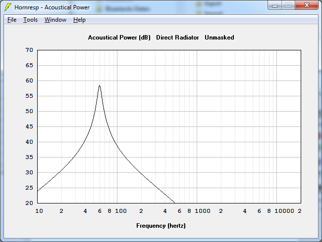

Hello guys, and especially hello David! 🙂
In the last few days, i was simulating a couple enclosures for my subwoofer (mostly with WinISD).
I allways liked the idea of a 6th order serial tuned bandpass, wich was unable to simulate until now, when i finally found Hornresp!!!
But i am pretty confused, at what Hornresp outputs me, compared to WinISD
I got strange peaks in the result, so i simulated a simple closed box, to see, if atleast this looks familiar, wich was NOT the case.
When simulating a closed box, i get just 1 big peak as result, like the following picture shows:

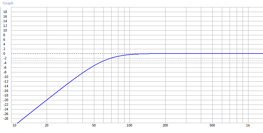

The same driver, in the same 5l closed box in WinISD looks like this:
attachment.php
I mean... ok... im sure the flat line at 100Hz and above is not true in WinISD, but this peak in Hornresp also looks unreal to me.
But it is not just the way, how it looks, also the point, where it starts dropping is totally different.
-> WinISD starts dropping at ~100Hz and below, the Hornresp simulation has its peak at 60Hz and drops below that
Just to let you have all the informations, here a screenshot of my input window:
Hi Benni,
If you change the value of Le in Hornresp from 1800,00 (1,8 henrys) to a more realistic 1,80 (1,8 millihenrys) you will find that as expected, the WinISD and Hornresp results become effectively identical below about 100Hz.

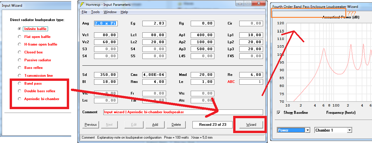

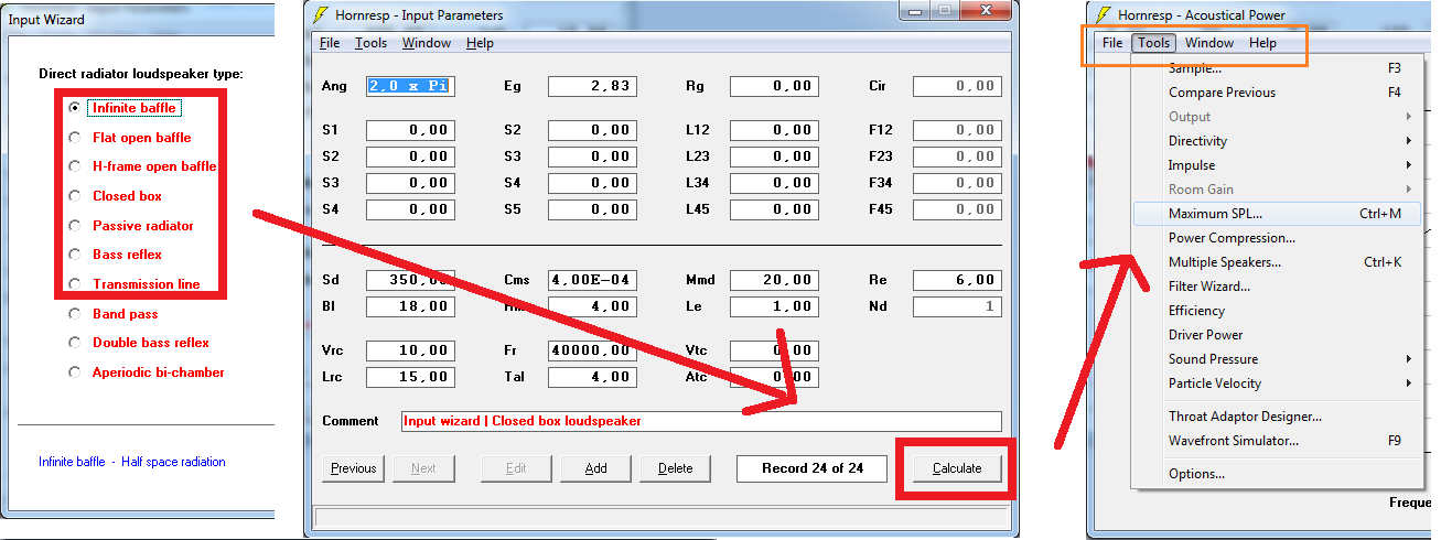

I have another problem, hopefully you can help me with this also 🙂
-> how can i show the max-spl for bandpass simulations? I can not find this in the dropdown menu.
For the first 7 options in the wizzard, it shows a "calculate"-button after all stuff in the wizzard is specified.
After clicking the "calculate"-button, you get a lot more options in the "window" and "Tools" -dropdown menue.
attachment.php
But for the last 3 options, it shows a "wizzard"-button instead of the calculate button.
When clicking this "wizzard"-button, a new window pops up, but i can not find a "calculate"-button anywhere. Also the "main-window" in the backround is not clickable, as long as you are in the "wizzard"-window.
attachment.php
Soo.... how can i get to the "maximum SPL"- window, when simulating one of the 3 last options from the list?
Thanks for the help 🙂
Greetings Benni
