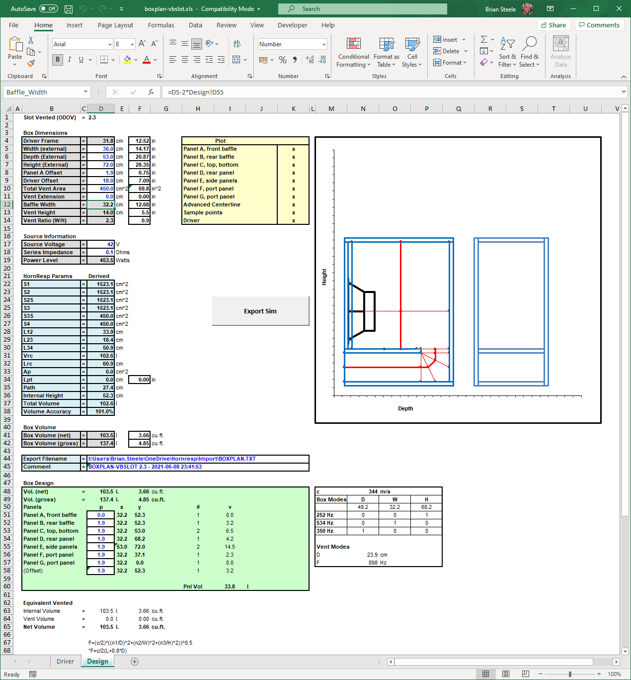

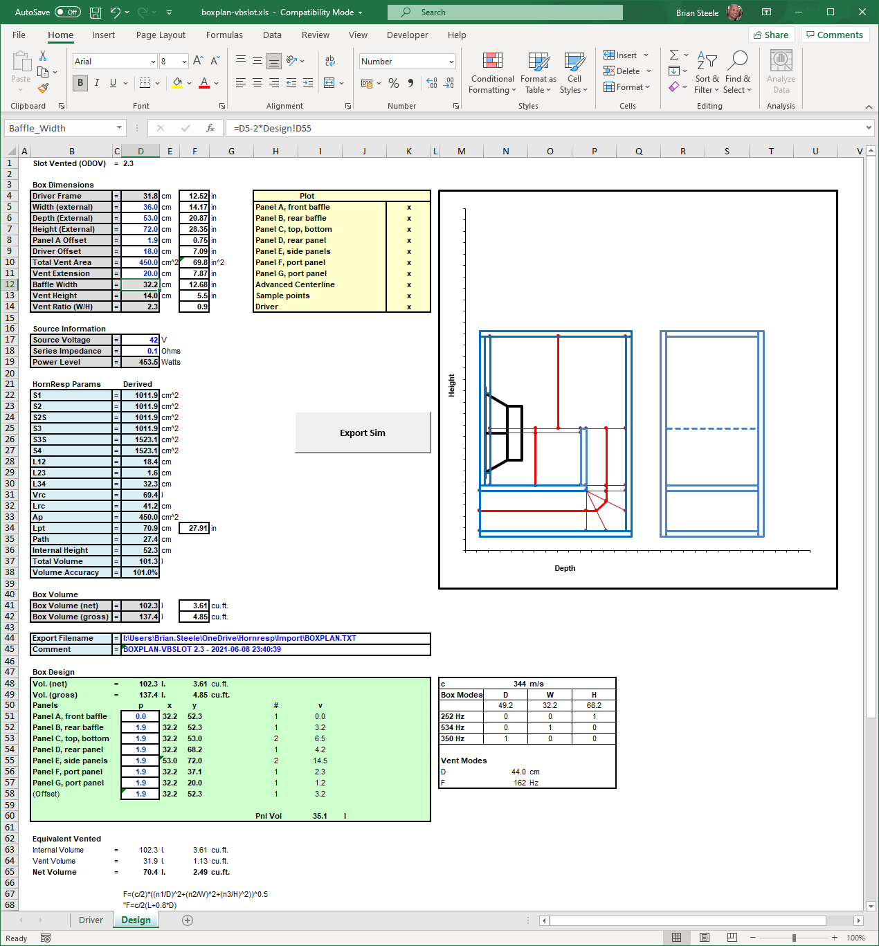

Hi David, I discovered a minor "bug" with the BOXPLAN routine for Offset-Driver, Offset-Vent alignments. When the corresponding values in the workbook are set so that the resulting sim is a simple OD model instead, apparently the F6 refresh routine doesn't recognize this and still considers the line to be a closed one. However, if I import the same sim as a new record, it treats it like a normal OD sim.
To see what I'm talking about, download the BOXPLAN-VBSLOT workbook from my database, export the sim from it, import into Hornresp and start the Loudspeaker Wizard. Then, set the value for "vent extension" to zero in the workbook, select "Export Sim" again, and press F6 in Hornresp. Instead of recognizing it as a standard OD model (with stepped sections), it sees it as a closed model. However, import the same sim as a new record and it recognizes it correctly as a standard OD model with open mouth.
Hi Brian,
Thanks for the feedback and for the detailed description of the problem, it makes things so much easier for me. The reason for the difference in outcomes is because the routine used to import the initial BOXPLAN record into Hornresp is different to the one used when the F6 refresh key is pressed in the Loudspeaker Wizard. The F6 routine will be modified in the next update so that removal of the vent is recognized. Not sure when the update will be released, though - I am currently also trying to implement the two features requested by grindstone, which is proving to be quite a challenge .
Kind regards,
David

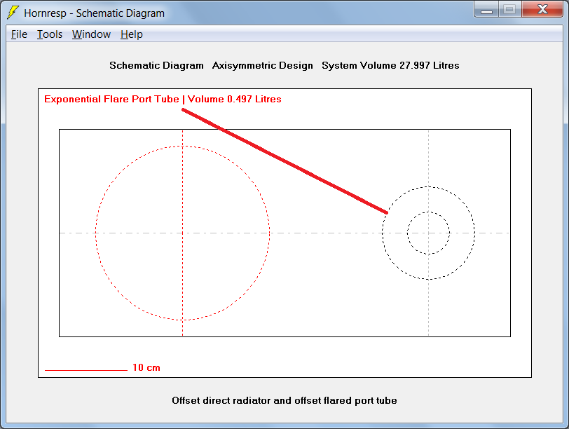

CHANGE 2
A loudspeaker with an offset direct radiator can now have an offset flared port tube. Attachment 1 refers.
Inputs:
Select the OD offset driver option and specify at least three segments, or select the OD1 offset driver option and specify four segments. Double-click on the Cir or Fta label in edit mode to select the Clo closed horn mouth option and set Vtc = 0. Specify the offset port using Ap and Lpt. An inner end correction is added to the Lpt port tube length.
Double-click on the Lpt label in edit mode to specify a flared port tube. Ap is the tube mouth cross-sectional area, Apt is the tube throat cross-sectional area and Lpt is the tube length.

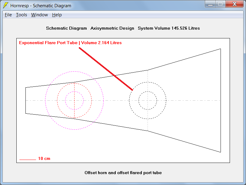

A loudspeaker with an offset horn can now have an offset flared port tube. Attachment 2 refers.
Inputs:
Select the CH1 offset driver compound horn option and specify four segments. Double-click on the Cir or Fta label in edit mode to select the Clo closed horn mouth option. Double-click on the Ap1 label to specify the offset port using Ap and Lpt. An inner end correction is added to the Lpt port tube length.

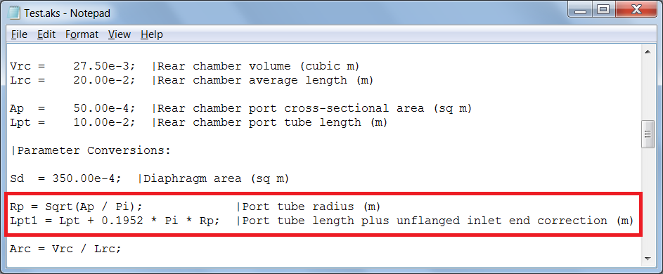

The end correction formula in the AkAbak export file has been changed so that it is now the same as the one used in Hornresp. Attachment 3 and the post linked below refer:
https://www.diyaudio.com/forums/subwoofers/373301-vented-vs-tl-4.html#post6688205

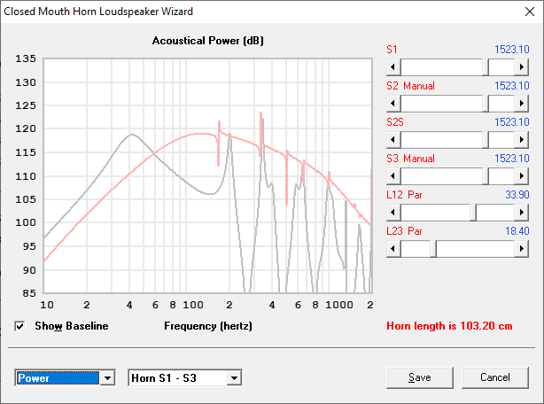

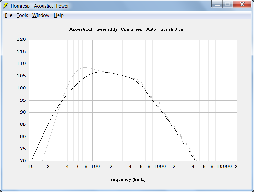

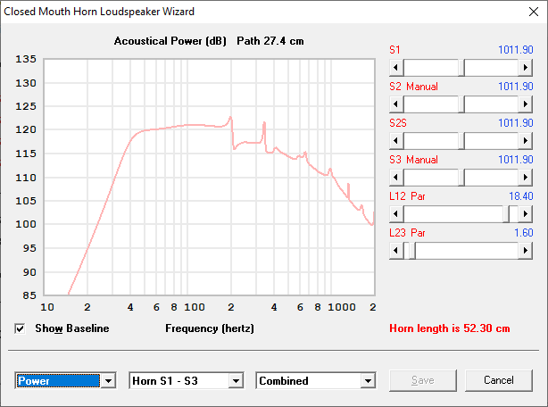

For now, maybe open this thing, David, and just set L45 to 10 then 100 and 1000 and 10000 and 100000. Does that seem right? I'd think the extra compliance of the big volume would move things more than just affecting higher harmonics
Hi grindstone,
Thanks for this feedback.
When I change the L45 (Par) value from 10 cm to 10000 cm in your example record the power response changes from the grey trace to the black trace in the attachment. In my case the lower frequency portion has been significantly altered. Are you seeing something different to this?
Also, just to check - you have set Ap (the port mouth area) to 200 sq cm and Apt (the port throat area) to 1200 sq cm. Did you mean to specify a negative exponential flare port, or should the figures perhaps be the other way around?
Serendipitously, in playing with the L45 slider in the Loudspeaker Wizard I discovered a minor bug that would have been there for ages - not one introduced with the latest release. I will try to fix it in the next day or so.
