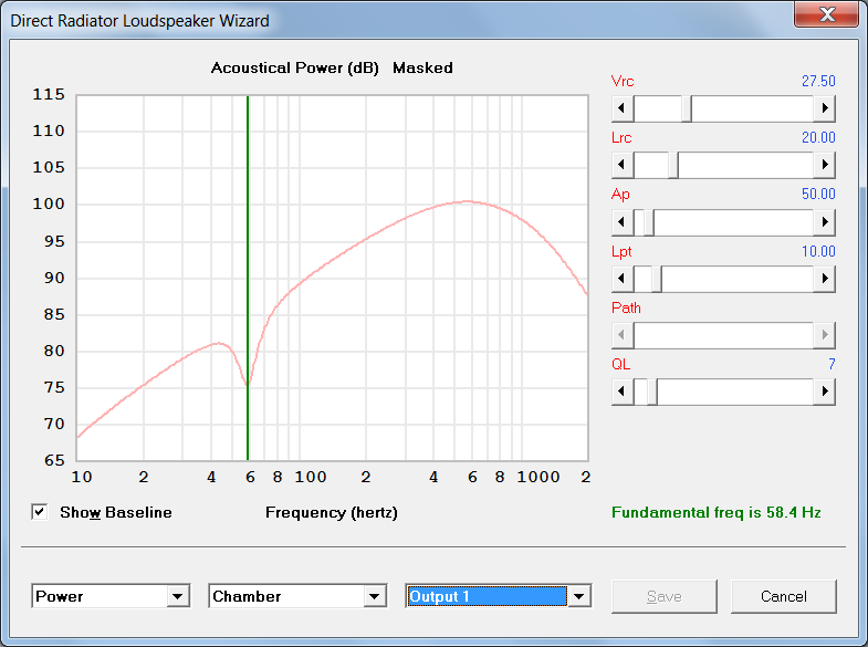

David, whats the chance that you could make an option to see a combined output of driver and vent which is an overlay of the separate outputs vs a simple summed view?
im thinking of a EBP alignment where the driver output and port output begin to decouple and you get a dip. it would be informative to see that in the wizard.
whats the chance
Hi Etocynned,
That's an easy one - there is no chance :).
The best that can be done using the Loudspeaker Wizard is to set the fundamental frequency marker as shown in the attachment, make a slider adjustment, and then use the up/down arrow keys to toggle between Output 1, Output 2 and Combined to see how the adjustment changes the three outputs.
Kind regards,
David

David,
I has a sad!
Hi Etocynned,
We can't have you being sad... :).
I had a close look at the code last night and after some "thinking outside the box" it looks like it might be possible to do something. If I don't run into any unforeseen problems the overlay feature will be in the next release. Note however that it will be confined to the loudspeaker wizard only, it will not be available in the main program.
Kind regards,
David
