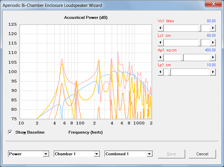

Do you plan to implement it in phase and group delay chart ?
Hi Damien,
The Combined 1 option is intended to work with the power chart only. The option was left on the drop-down list simply because that was the easiest thing to do 🙂. I will have a look to see how difficult it would be for the Combined 1 option to be removed when the phase or group delay chart is selected.
nice curves colors 🙂
You would be surprised at how long it took me to settle on the final colours. I wanted them to blend nicely with the original pale red trace, and also to complement each other and not clash 🙂.
Kind regards,
David
Playing with the 4 curves of aperiodic bi-chamber enclosure with "combined 1" power chart is entertaining ^^
"Entertaining" is not the description I would have used 🙂.
When I checked an ABC design prior releasing the update I thought that the four traces were horribly confusing!
"Entertaining" is not the description I would have used 🙂. (...)
You would be surprised at how fast it took me to settle on the word to put in google translate to mean "Entertaining" 😉You would be surprised at how long it took me to settle on the final colours. (...)
I'm so used and confident in people ability here to be really tolerent with our (non native english people) langage approximations (this sentence is probably a good example) 🙂
Will be implemented in the next update.

Hornresp Update 5110-201018
Hi Everyone,
CHANGE
It is no longer possible to select the Combined 1 option when the phase response or group delay chart is displayed in the loudspeaker wizard.
Post #11201 linked below refers.
