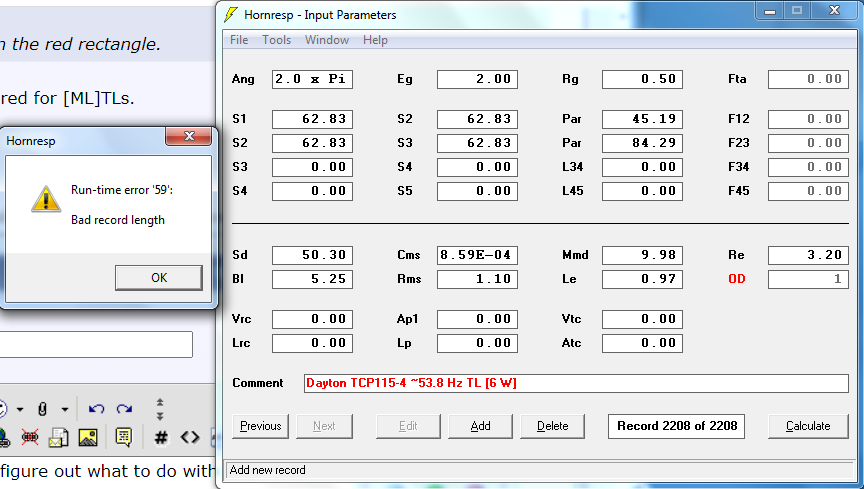

I have no idea how it could possibly happen, but the record has been corrupted. Because your Hornresp.dat file contains many other records that presumably you do not want to lose, the best course of action would be for you to email me a copy of your complete Hornresp.dat file, which hopefully I can fix and then return to you.

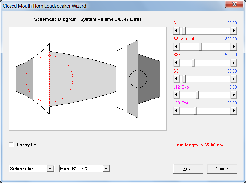

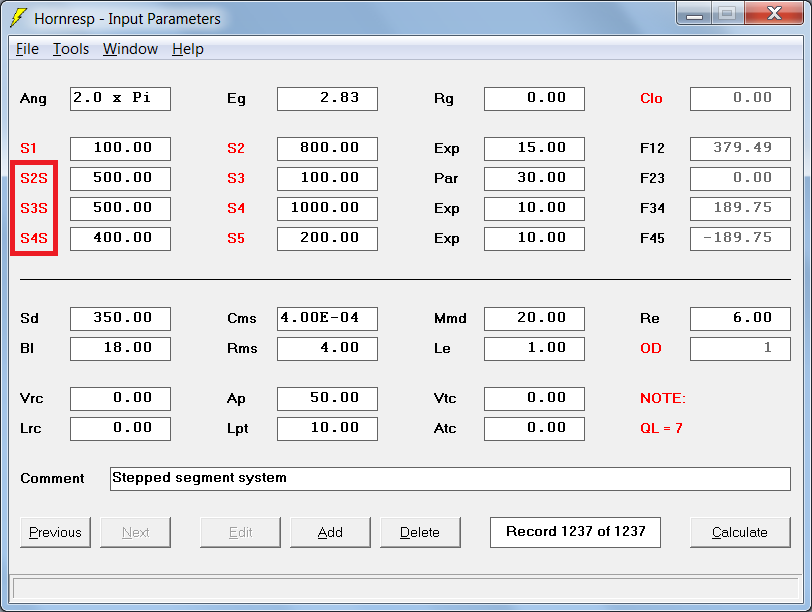

Hornresp Update 5100-200926
Hi Everyone,
CHANGE 1

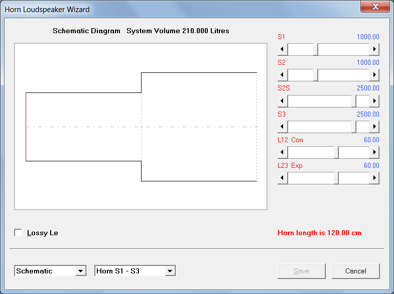

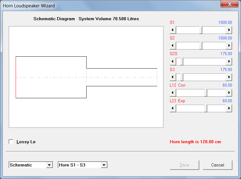

The Loudspeaker Wizard now has full stepped segment functionality, as shown in Attachment 1. Systems with stepped segments can have up to three additional sliders depending upon the number of segments in the design. The new sliders are designated S2S, S3S and S4S as shown in Attachment 2.
At the S2 boundary, for example:
If S2S is greater than S2 then the step is upwards and the cross-sectional area increases, as shown in Attachment 3.
If S2S is less than S2 then the step is downwards and the cross-sectional area decreases, as shown in Attachment 4.

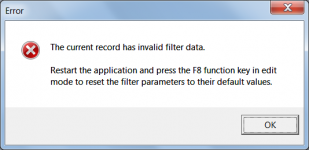

A more instructive error message is now displayed when the current record has invalid filter data. Posts #11070, #11073, #11075, #11078 and Attachment 5 refer.

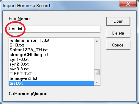

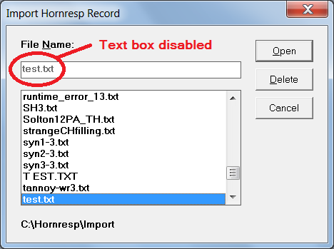

Previously a file could only be selected for importing by scrolling through a file list, as shown in Attachment 6. It is now also possible to specify the required file by directly typing in the file name (case insensitive), as shown in Attachment 7. The file extension is added to the name automatically, it does not have to be typed in by the user.

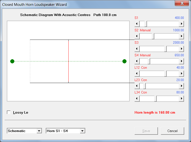

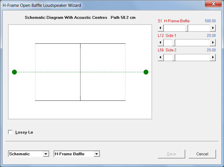

Acoustic centres correctly displayed on the loudspeaker wizard schematic diagram of one record, as shown in Attachment 8, were in some cases being wrongly included on the schematic diagram of a newly selected different record (when they should have been removed) as shown in Attachment 9.
This bug has now been fixed.

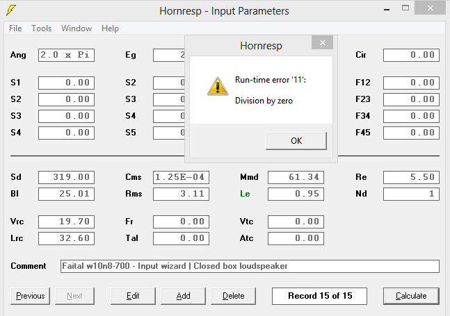

got it fixed!
That's good to know, because the 'faital pa-as.txt' export file you posted wouldn't have been of much help in tracking down the problem - it is simply a copy of the default record 🙂.

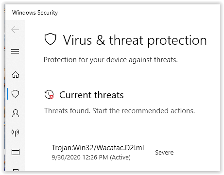

Antivirus - Win10
Hi Sabelbacke, Post #11143: "...checked and downloaded setup.exe on a few win10 machines - no alarms any more..." - I'm running hornresp in Win10 on Acer laptop, no problems until today. Now the .exe is gone, and download is being blocked by Windows Defender Antivirus, see attached screenshot. What now? 🙂

Hey Oliver,
Davids Post gave the link to a solution. In the security center you can "allow" stuff, or choose actions (block, delete, allow on this machine...). The file obviously got deleted from the security stuff in windows.
I just checked the file online - everyhting is ok. If one uploads the setup.exe to virustotal - only the ms scanner shows a warning, all other 8347248327 not.
VirusTotal
If you are out of luck, just switch the security stuff of for a moment, then download again, install - and switch on again... Next time windows complains, open up security center and "allow" .

Posts #11153/4/5
- I had already excluded the Hornresp folder and .exe file, didn't help. I turned off all virus protection, now the update takes place, but Hornresp doesn't advance past the license number window. I'll mess with it some more later, gotta run. 🙂
Thanks for the help.
That´s strange.. You mean the program itself is running but gets stuck at the info screen at the start?
Post #11157 - Yes. I also - to the extent possible - disabled Windows Defender, and the Firewalls, no difference. Version 4030 from 2017(?) works fine. As I'm not in any direct need of the newest version of the program right now, I think it may be easiest to wait through a few update cycles of Win10, and see what happens. I'm willing to try other things, but the MS suggestions of extensive editing of the registry is not one of them. 🙂
Actually, there should be mentionings of the blocked items in the MS security center. If you go into it, you should see the blocked hornresp.exe - no need for registry edits 🙂
