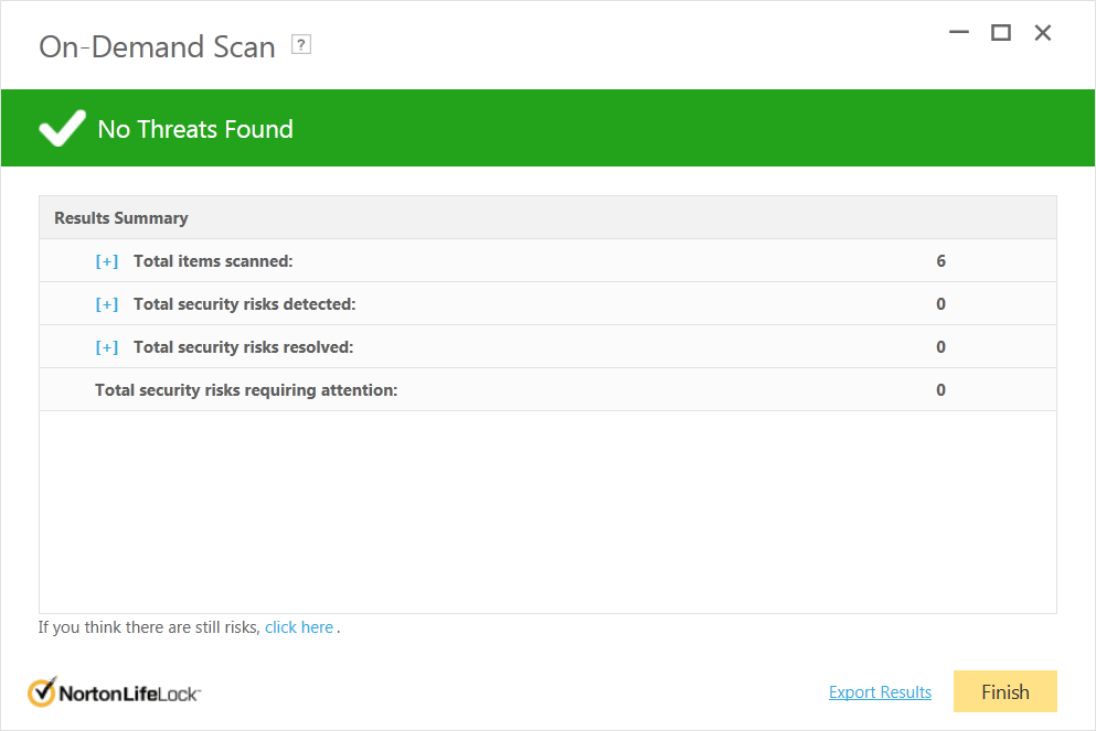

As Mark said, there has never been (and hopefully never will be) a Trojan in Hornresp.
My computer is comprehensively protected by continuously-maintained Norton antivirus software. Full disk scans are run regularly. I am very careful what files I download and what email messages I open, particularly those containing attachments. Every time I upload a new Hornresp update I then immediately download a copy and run a virus scan on that file. I am acutely aware of the responsibility I have to users to ensure that Hornresp is benign software. For that reason when Hornresp is installed, all files are visible, nothing is hidden, and the Registry is not modified in any way. What you see is what you get.
The only way that a virus is going to get into Hornresp is if the host server in Germany is externally hacked and the Setup.exe file residing there is maliciously infected. Maybe Sabbelbacke might like to comment further, but in my view that chances of that happening are zero.
I have once again just downloaded a copy of Setup.exe and scanned it for viruses. As you can see from the attachment, it is quite clean and totally safe.
Unfortunately though, there is nothing I can do about over-zealous antivirus software "jumping at shadows".

It's very good that you are all very cautious about the files you download! But as viruses get clever and clever, it is obvious that antivirus-software has to fight harder and sometimes create false positives.
To complement the fact, that HornResp is certainly 100% clean, we can look in our exceptions tab which you can find in my tutorial on post #11091. In my case, I do a bit of coding myself and all my coding software needs these exceptions to work.
Perhaps the problem originates from the fact that these software constantly changes files. HornResp changes txt (short for text) files on your pc to save your precious speaker designs. We wouldn't want a trojan changing files on our pc, but in the case of HornResp changing innocent txt files. I think we will be fine 😀
