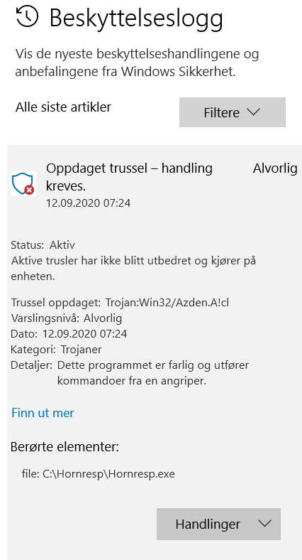

Nothing, hornresp is fine. I just checked with virustotal.com:Hi everybody, just downloaded hornresp from Hornresp and windows advertise me about a Trojan:Win32/Azden.A!cl on program file... What's wrong ?
VirusTotal
False alarms happen from time to time.

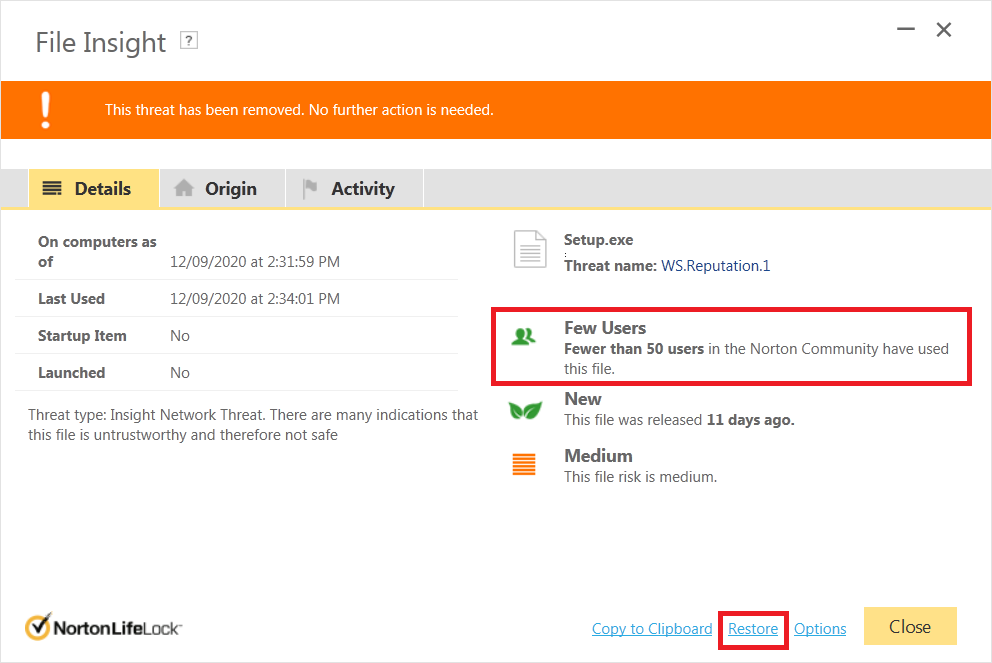

I just tried downloading a copy of Hornresp myself and received a warning message. Norton is suspicious because it appears that the program is relatively new with few users. I had to click the 'Restore' link to override the warning and "de-quarantine" the Setup.exe file.
Not sure what can be done about them though, as it seems that the antivirus software packages these days are being deliberately engineered to be more and more paranoid about scammers and hackers - and with good reason in some cases, I might add...

Prevent Windows from blocking and rejecting execution of HornResp.exe
PROBLEM
I had problems starting up the new version of HornResp. Windows would report "Windows found that this file is potentially harmful. To help protect your computer, Windows has blocked access to this file." Windows then deletes the file after a couple of minutes (once Windows Defender finds the file).
FIX
As stated on Microsofts website, do the following:
- Open Settings
- Update and Security
- Windows Security
- Open Windows Security
- Virus and Threat protection
- Administer Settings
- Add or remove exclusions
- Add an exclusion (Choose Folder)
- Set it to C:/HornResp (Or whatever folder you keep the software in)
You should now be good to go! Install the software again and you will not have any more problems starting it 😀
