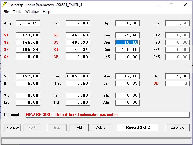

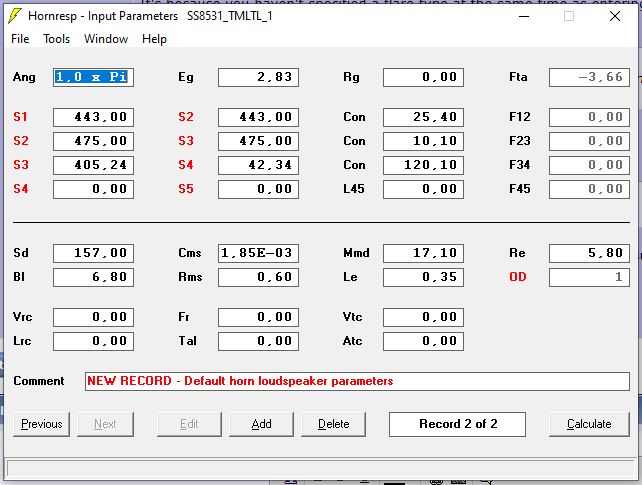

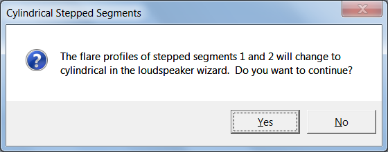

What i mean with cylindrical is that S1=423, S2=466 and S3=484 together is making a cone (with two sections/volumes) where the driver is positioned. But in the LsW is will change to two different cylinders with the area 423 and 466 cm2.
To start with I changed the area for the two different sections/volumes to be the average of the cone area. Section/volume 1 area = 444, and s/v 2 area = 475 before starting to look at filling, impedance etc.
Still not exactly the power handling etc of the initial S1-S2-S3 cone but as close as it´s going to get without the abilitiy to use cones/tapering in the first part of the TL in LsW (Loudspeaker Wizard).

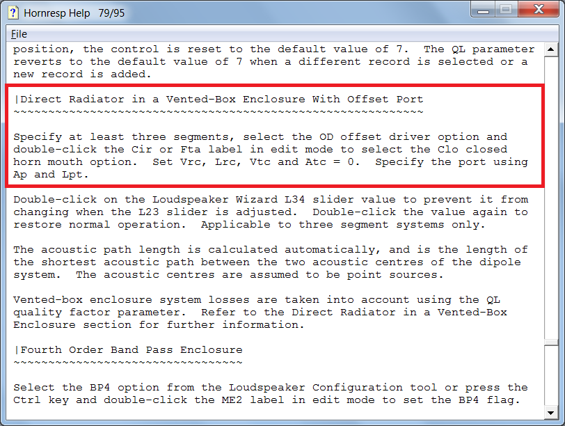

I have jumped around and tried to find where to change the open end to a closed end with a port/vent. Haven´t found it. Everything the same but with close end and a port/vent at 108 cm of the 120 cm into section/volume 3, and the extra section/volume picking up the rest 12 cm to get to 120 cm.

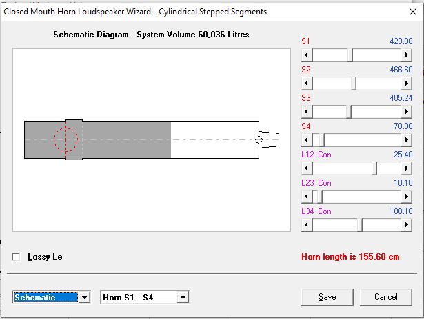

That's why the message shown in Attachment 1 is displayed before the Loudspeaker Wizard opens. Without more area sliders in the wizard, it's the best that can be done when stepped segments are specified.
See Attachment 2.

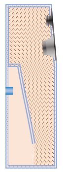

Instead of using the suggested smaller areas of the different sections I used the average of the throat and mouth areas (averag or the conical area) after going from input parameters into LsW (where conical becomes cylindrical) seem more correct to me. Are there any theory against this?
Next design is where the LsW automatic adjustments gets a little bit troublesome. When designing with OD, tapering and a port/vent. Shown after and before the automatic adjustment. Quite different designs (with the preferred design shown to the right with the SS 8531G00 and the SS D2608/91300+WG). And making this with "averages" seem i little bit too far away from the original design. 🙂
Not really. It's just a matter of making the best approximation that you can, given the circumstances.

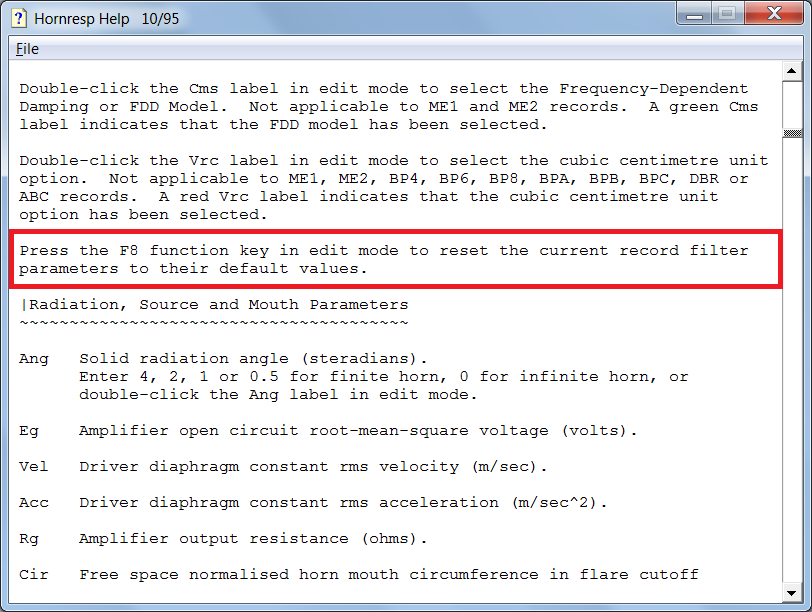

I get an overflow error 6 when trying to add filters and it crashes out of the program.
Hi USRFobiwan,
The filter data in your record has been corrupted. There is an explanation for this if the record was generated a long time ago, or is a new record that used an old record as a starting point. (There was a bug in the system that meant that the filter data could sometimes be corrupted, but this was subsequently fixed). Otherwise, I don't know what the cause is.
The easiest way to fix the problem is simply to press the F8 function key in edit mode to reset the current record filter parameters to their default values.

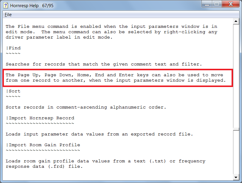

Also is there an easy way to go to the last record in the collection when opening the collection.
There certainly is, simply press the End key... 🙂.
See the attachment for details of the other available navigation keys.
