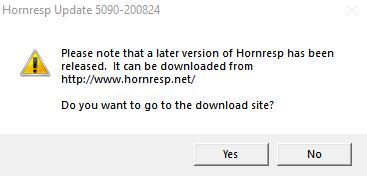

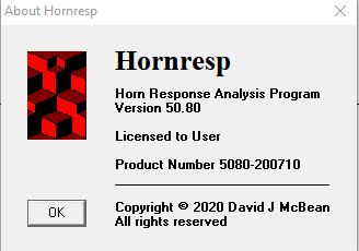

David, Hornresp shows that an update but upon downloading/installing the update, the old version remains and notifies of the update again.

False alarms from security/virus scanners happen from time to time.
What seems to be happening in the case of Hornresp is that the antivirus software checks to see how many times the Setup.exe file has been downloaded, and if only a few times (which is the situation early on with a new release) it thinks that the file must be suspect in some way because it appears to have very limited use. If I stopped releasing updates to Hornresp the "false positive" problem would probably go away once the number of downloads reached a level considered to be acceptable by the security software 🙂.
