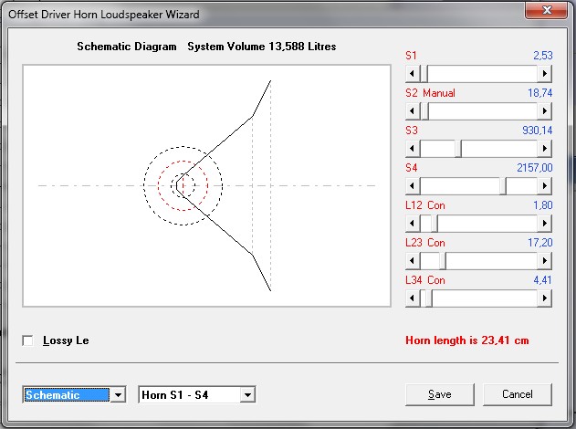

Hi David

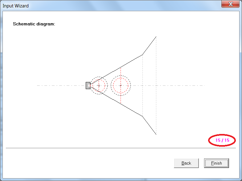

The new update of hornresp does this, in Wizard I get a strange picture and in schematic diagram after calculate it is oke. This was not the case in prvious version.
When using the old version as you see things are right, see pic three.
regards
Hi Kees,
It's because you have specified stepped segments. When the Loudspeaker Wizard is used with the stepped segments option selected, all the segments will be cylindrical apart from the last one, regardless of the profile specified. This limitation is necessary to avoid having to increase the number of area sliders in the wizard. In your case, the last segment is also cylindrical because you have the S4 slider set to Auto.

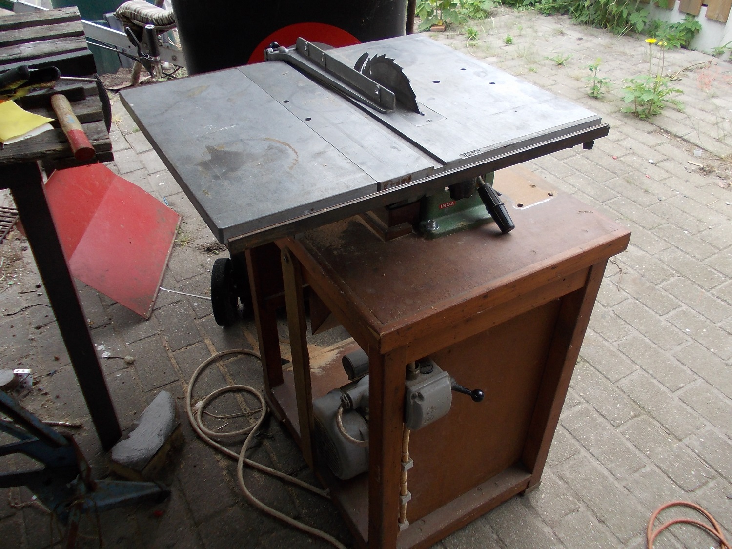

I buy me a saw, a precisie one type from Switzerland type Inca, with that I can make things more precise with some sleds. It is for making horns, not the bis ones.
I go look.
regards

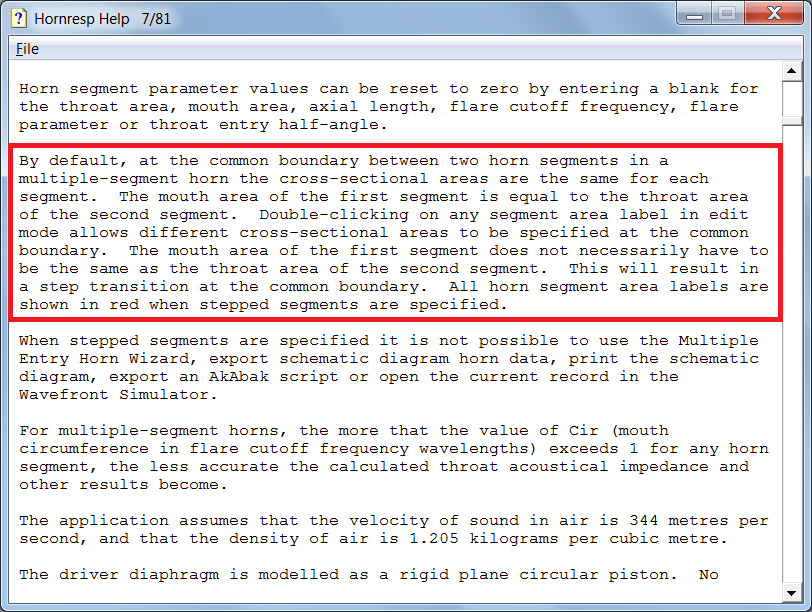

I did not have that problem with the previous version, it was oke then after the update I did get this, the new version did set the options different? do not happen normally.
The stepped segment option can only be selected by double-clicking on a segment area label. All area labels change from black to red to signify that the option has been set. I suspect that at some stage you must have accidentally double-clicked on a label and set the option without realising that you had done so 🙂.

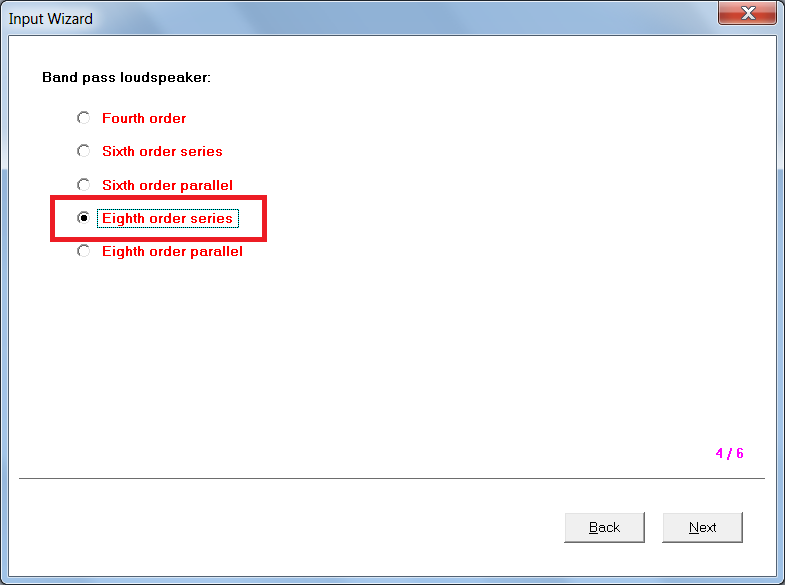

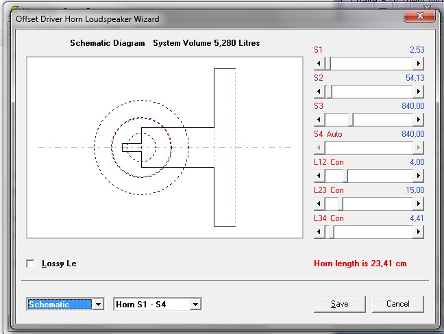

Hornresp Update 5010-190605
Hi Everyone,
CHANGE 1

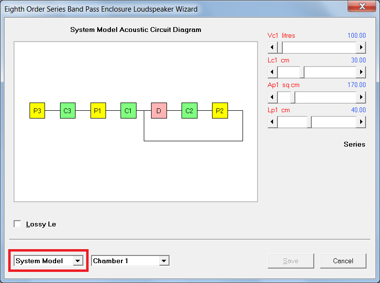

Eighth order series band pass loudspeakers can now be simulated (see Attachments 1 and 2).

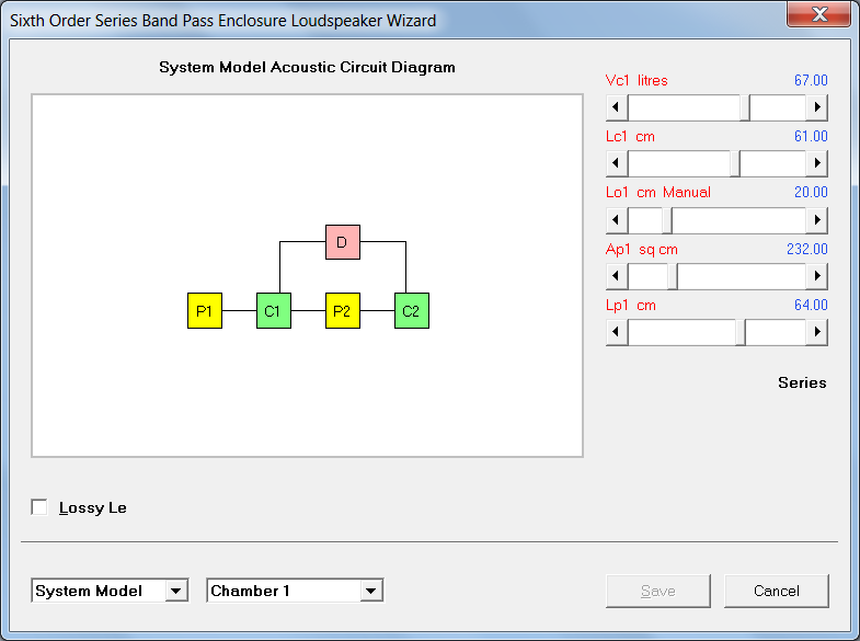

CHANGE 2
A 'System Model' output option has been added to the BP / DBR / ABC loudspeaker wizard. The new option displays the acoustic circuit diagram for the specified system, enabling users to better understand how the enclosure is modelled in Hornresp so that they can accurately simulate their band pass, double bass reflex (DBR) and aperiodic bi-chamber (ABC) enclosure designs (see Attachments 3 and 4).
BUG FIX
Adding the stubbed horn option to the Input Wizard caused the page numbering for the multiple entry horn loudspeaker option to become incorrect (see Attachment 5). This has now been fixed (see Attachment 6).

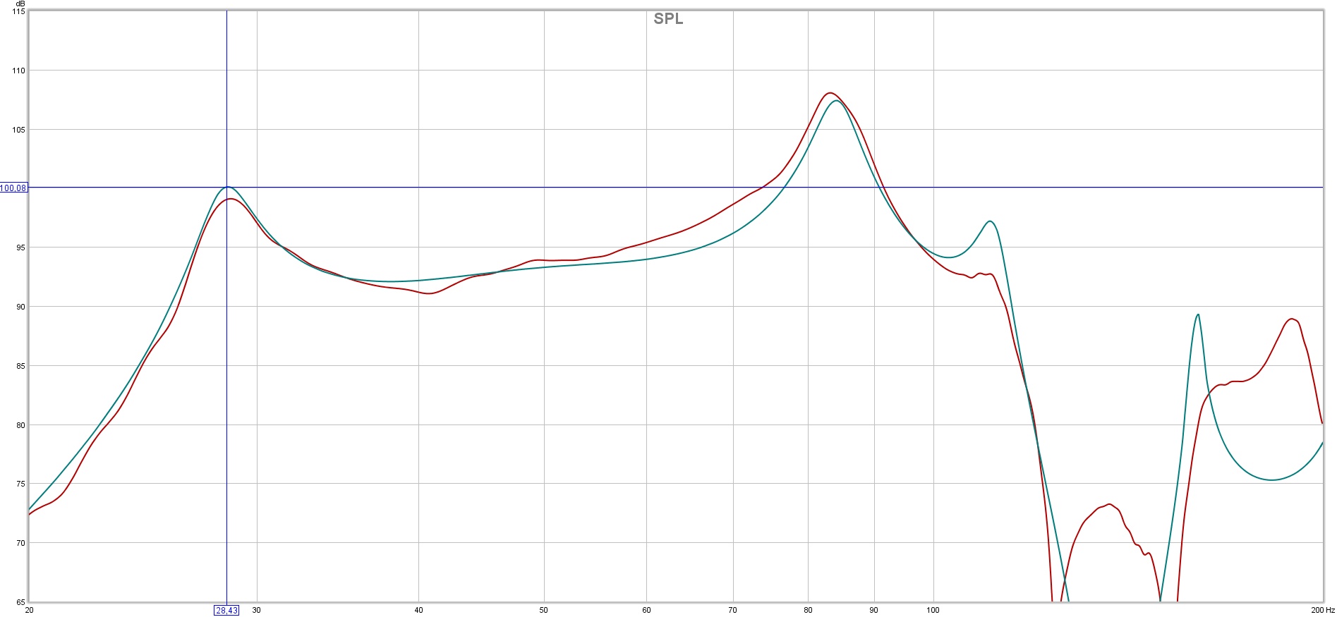

Increasing the Le and lowering the Bl slightly, and a more careful measurement of the actual length and cross section area of the HROAR10 gave this correlation between Hornresp and REW+Umik measurements.
You really can´t expect better correlation between sim and measurement then this.
Hornresp is truly a gift to all of us that love to build creative bass enclosures!
Thank you David McBean!!!!

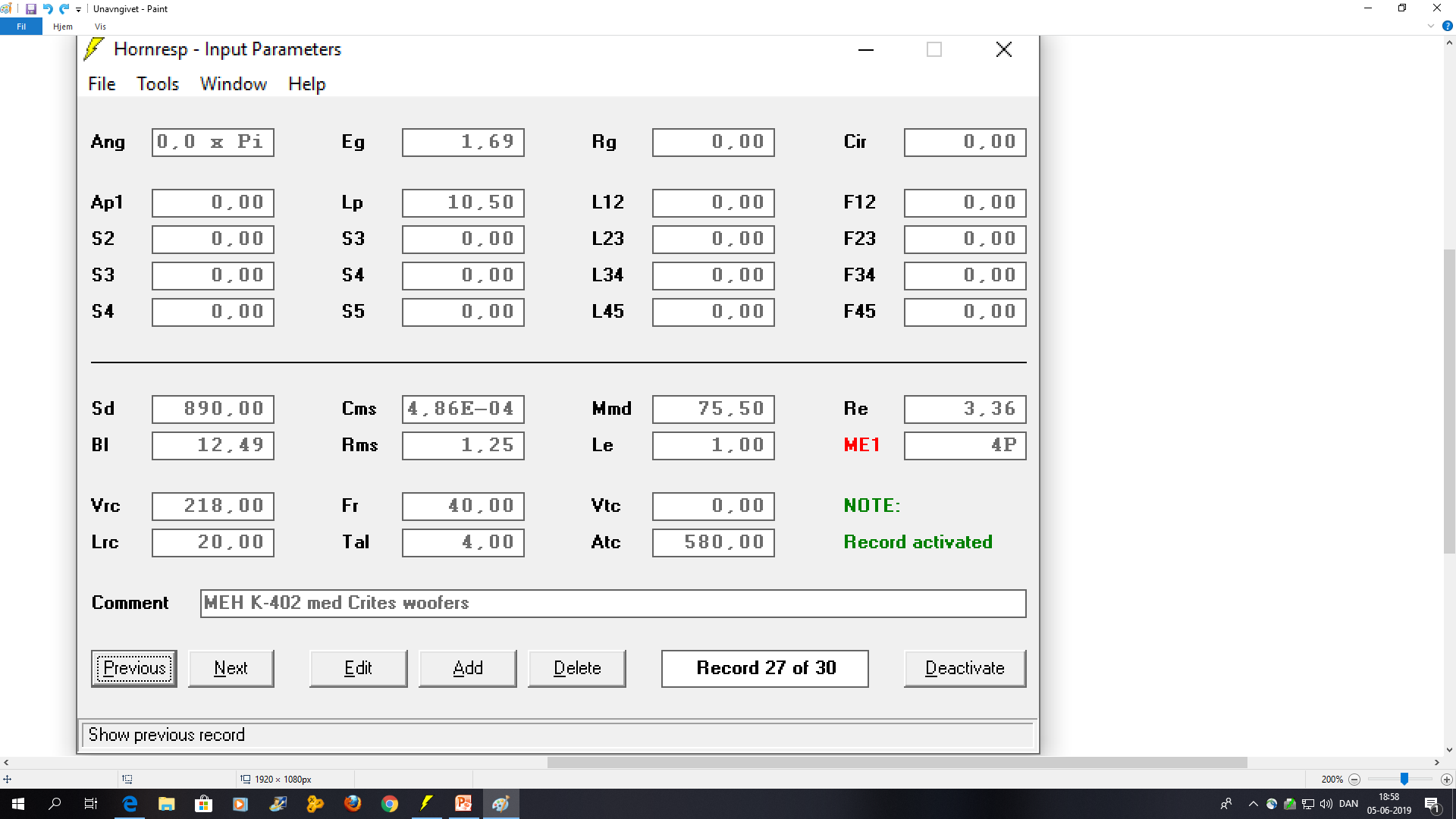

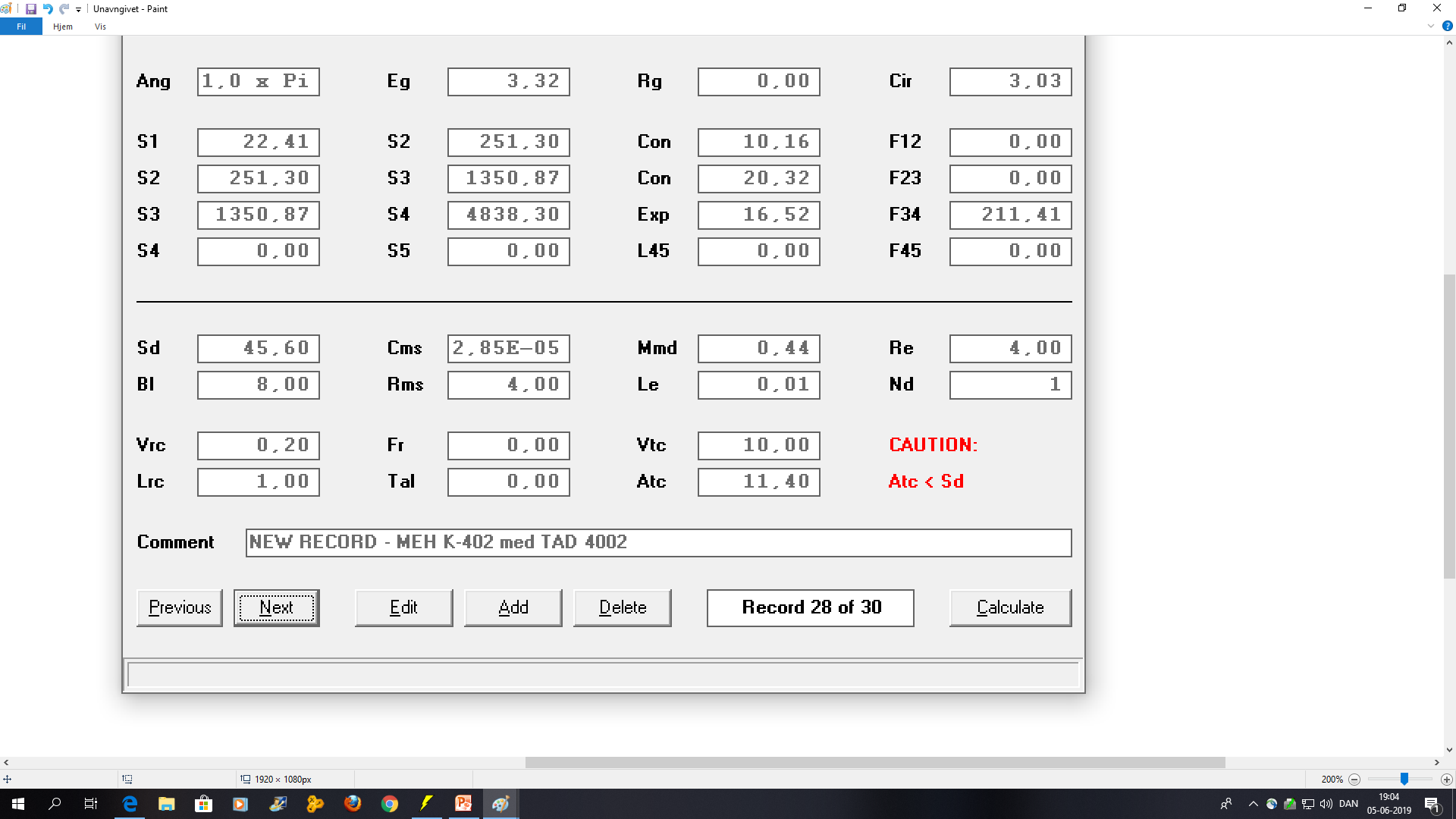

In order to get a hang of simulating Multiple Entry Horns (MEHs), I have started out by trying to replicate some of the simulations Chris (aka Cask05) have showed on the Klipsch forum based on the K-402 horn. I have just entered to same numbers as Chris for (1) a Tad 4002 and (2) some Crites Woofers (see the attached files).
My question is: How do I get to see the acoustical output simulation of the MEH1 simulation with the Crites woofers? (with the TAD 4002 simulation the "calculate" button in the right corner is active; however this is not the case with the Crites' woofer simulation). What am I doing wrong? Thanks!
