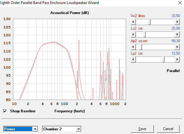

Tweaking a lot, i got the feeling that same response from same volume can be gotten with serie and parrallel bandpass. Serie got the advantage of 2 last stage advantage, but parrallel got the advantage of 2 stage inside feedback loop insertion second path less far from output, wich probably help compression wise.... Here a example, same volume, one 8 parrallel, one 8 serie. Serie should low pass noise from ealier "stages" better, hence, lower thd. But i got too low knowledge to be confident with my own logic. That is just hippopothesis throwing.
I never though doing so to show the difference between leaky and theorical really sealed box. Thanks for this good sim example. Note that difference in frequency scale chart add a bit of confusion, and this can be done with any other topologies that hornresp allow to sim as closed back using the trick of really small port.

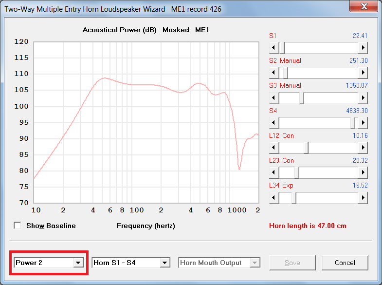

How do I get to see the acoustical output simulation of the MEH1 simulation with the Crites woofers?
1. Activate the ME1 record.
2. Move to the associated Nd record.
3. Click the Edit button.
4. Select the Multiple Entry Horn Wizard from the Tools menu.
5. Select the Power 2 output option as shown in the attachment.
Select the Power 1 option to see the TAD 4002 output.
Select the Total Power option to see the combined Nd + ME1 output.
Clicking the Calculate button on the Nd record calculates the normal Nd results only - they will be different the Power 1 option results.
Kind regards,
David

Say one wants to "shut" off a port. What values should one enter for best approximation of that condition?
The closest you can get is to set Ap and Lp to 0.01 (by selecting the slider, typing the 0.01 value and pressing the Enter key). Note that it still represents a small leak though, and will affect results accordingly.

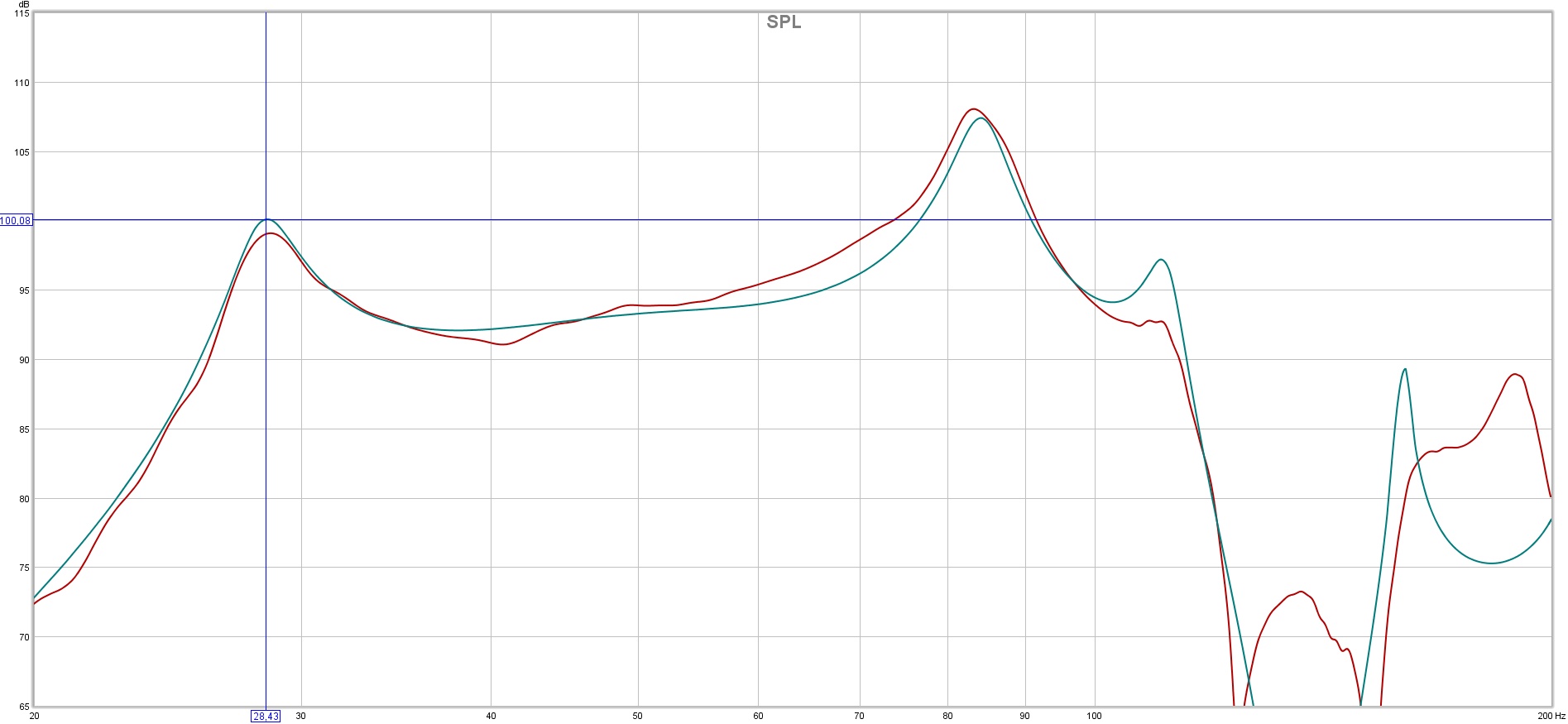

Increasing the Le and lowering the Bl slightly, and a more careful measurement of the actual length and cross section area of the HROAR10 gave this correlation between Hornresp and REW+Umik measurements.
You really can´t expect better correlation between sim and measurement then this.
Hornresp is truly a gift to all of us that love to build creative bass enclosures!
Thank you David McBean!!!!
Johannes
Isn't it awesome when the simulation matches the measurements?
