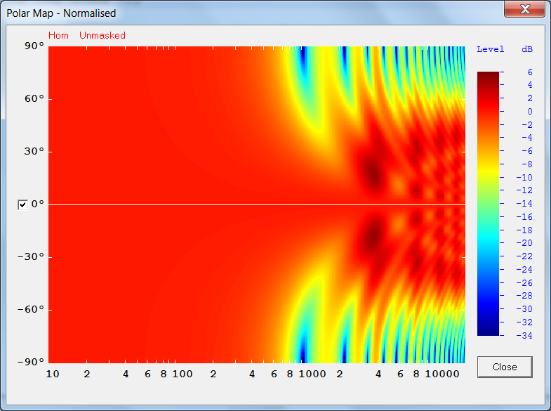

A bit longer than a couple of minutes, I suspect 🙂. Producing the normalised polar map for Fred's OSW design example using the relatively simple model in Hornresp took 8 minutes and 10 seconds on my computer. Nevertheless, it would be interesting to try - if only I had the coded MMM algorithms... 🙂.

8 Minutes seems very long - on my years old i5 Intel NUC it took 41 seconds, while hornresp is using only 25% of the CPU. It´s a 2 core machine with hyperthreading (=4 virtual cores).
Seems hornresp only picks up one virtual core.
On an old Pentium 4 (my CAD/CAM Machine) with P4-630 (single core, 2 threads, 3Ghz), it took 70 seconds.
One "core" is used again.
So I assume hornresp is "single thread software".
Investigating further :
Comparing your AMD CPU to my very old P4 on single thread performance with passmark:
PassMark - CPU Comparison AMD E-450 APU vs Intel Pentium 4 3.00GHz
Your CPU: 430 Points
P4 3Ghz: 650 Points
(singe thread performance on a midclass-modern cpu is around 2000 for a 150$ CPU)
Even with your CPU a little slower on single thread performance than a 10 year old P4 - you should be able to get computing times much lower than two minutes - since hornresp isn´t using many very modern CPU-capabilities like AVX, raw single thread performance from passmark should give a rough estimate..
What is happening here? Am I missing something and doing the wrong comparison? Somehow your system seems even slower when calculating polar response than my pentium 3..

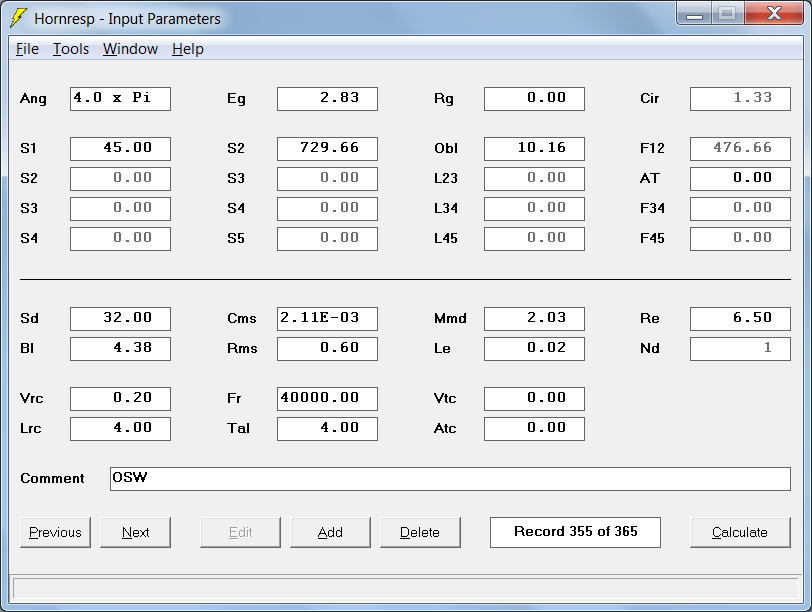

Thanks for investigating this issue.
Did you use the same OSW design example as me? See attachment.
Calculation times vary considerably depending upon the flare profile of the horn. In my case, changing from Obl to Exp reduces the time it takes to produce the polar map down to 72 seconds. Were you using an exponential flare in your example, perhaps?

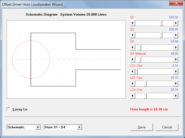

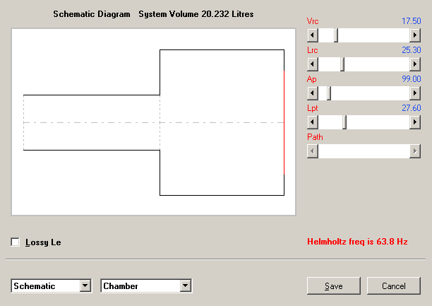

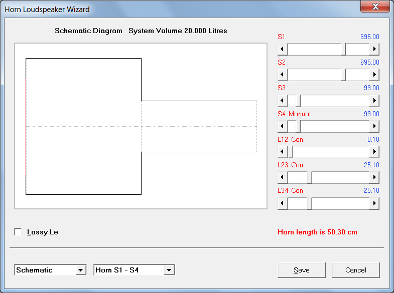

i've simulated the same driver as mlqw and as br with same dimensions, the only difference i'm aware is that the br has(probably?) a round port. Why is the frequency responce that much diffrent?
Thanks in advance, Johannes

so now the response seems pretty equal.

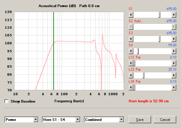

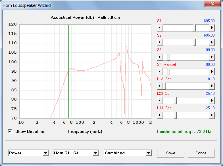

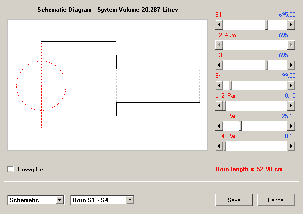

Hi Johannes,
The results will become identical if you specify the "bass-reflex" system using a horn segment for the port rather than Ap and Lpt. This is because a port specified using Ap and Lpt includes an internal end correction, which is not present in the offset driver system being used in your comparison.
Whatever you choose to call them, your two example systems are for all practical purposes the same.

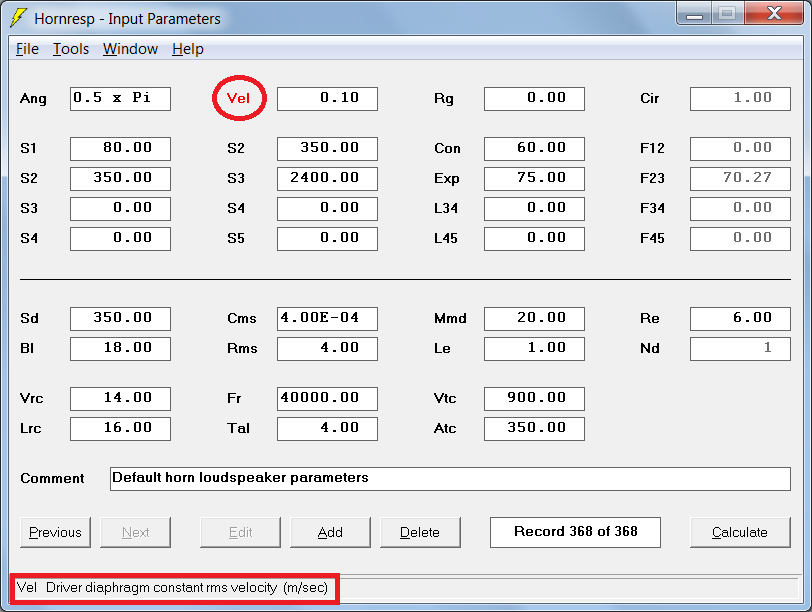

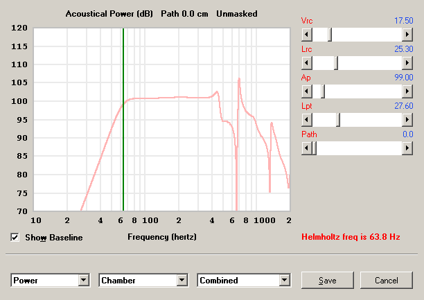

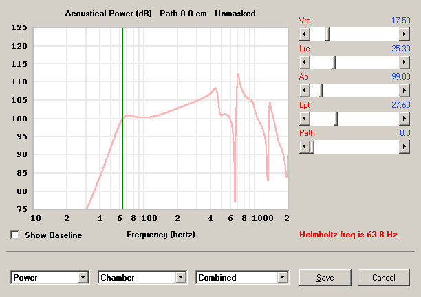

Hi Damien,
This can already be done, using the driver diaphragm constant velocity option.
Kind regards,
David
Wow ! It's really fun to play with ! And results are somewhat surprising, speakers damps a looooot more than what i would was thought.
When Vel is selected, is it normal that only diaphragm excursion and acoustical power screens changes ?
Whereas importing both Eg/Vel impulse in REW, i don't get same group delay curves, as expected. I probably miss something, again, sorry...:worship:

indeed, that cleared things up. I am now at 4:25 calculating time for your given example on my i5-4250u.
One thing is interesting: I have 2 Cores with hyperthreading enabled (=4 cores) - hornresp seems to use only one of the 4 virtual cores - I never get above 25% for the hornresp instance.
Do you see any chance to enable multiple threads in hornresp? On modern CPUs with many cores, this could speed up things quite a bit.

Hi Damien,
In effect all that happens when Vel is selected is that Eg varies with frequency to maintain a constant diaphragm velocity. This is why only the acoustical power and diaphragm displacement results change.
Kind regards,
David
I'll have to look closer...and do my homeworks :violin: :faint:. I don't get why exported impulses from Eg and Vel did not give me the same group delay curves when imported in REW, but did in hornresp... 😕
