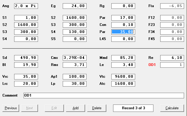

Hi Damien,
Could you please post the input parameter values used in each case, so that I can run the simulations myself and investigate further. Thanks.
Kind regards,
David
Here they are with their output files, thanks !
Damien

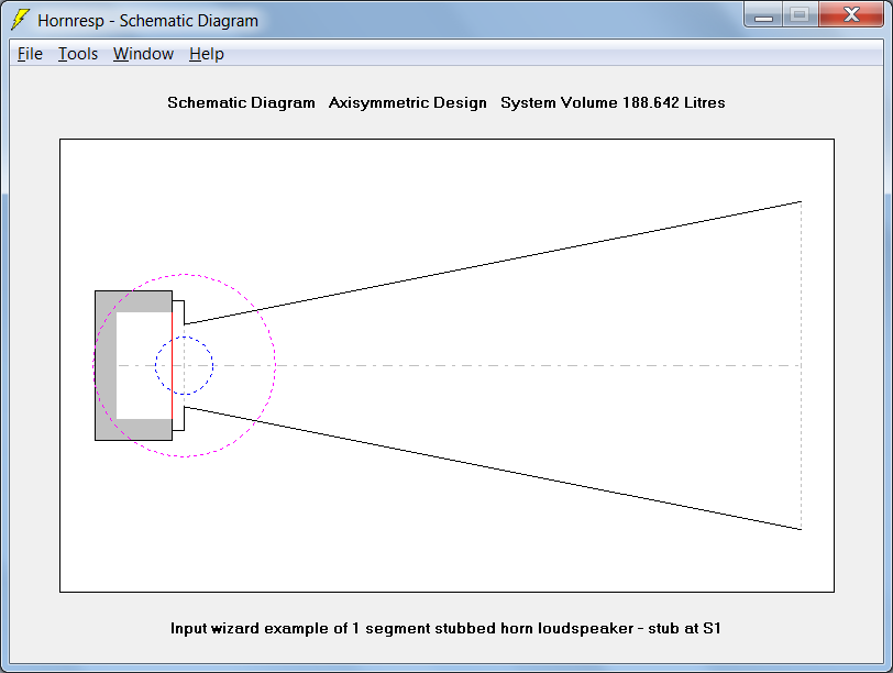

Hornresp Update 5000-190503
Hi Everyone,
BUG FIX
The bug described in Post #9479 has now been fixed. My thanks to Fred for reporting the problem.
CHANGE
The stub outline was being partially hidden behind the rear chamber acoustical lining in the schematic diagram, as shown in Attachment 1. It is now completely visible as shown in Attachment 2.
Kind regards,
David
