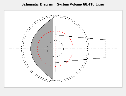

I managed to excite a runtime error & lockup - probably error on my part trying to see if a stub could be applied to a blh.
It seems that you must have too much RAM in your computer - it works just fine for me... 🙂.
There should be no problem in applying a stub to a back loaded horn - see attachments using your example.

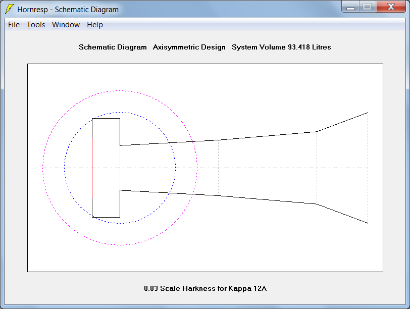

Hi David - I crashed that sim for a Harkness BLH a couple of times in succession. "SH1" seems to sim fine until I attempt to invoke the Wizard (in hopes to see what damping material may do). What might the culprit be? (usually myself - lol) - perhaps I should do a fresh re-load of hornresp.
Is the input specifying too large an absorber chamber? What might I be doing wrong? - How should the stub's parameters be specified for this case?
Here's the way it looks at my end:

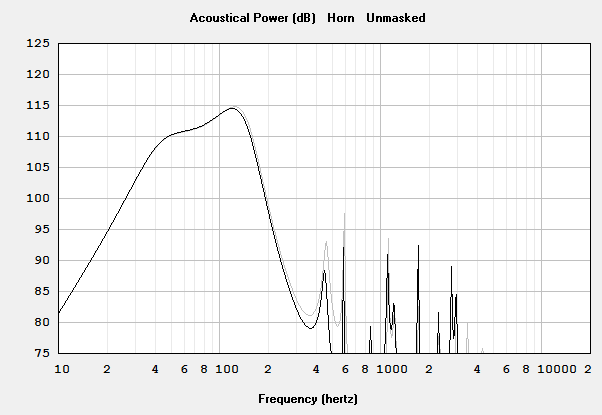

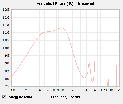

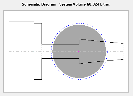

Hi David, what does explain the big damping difference effect of filling in wizard between using OD L12 segment as stub VS using stub mod ?
In Sim, stub mode gives more filtering effect of the same amount filling.
Here two sims for example. Without filling, there's no difference, grey trace is really close to black one and hard to see in figure 5.
Thanks !

IF (?) I somehow did something right, it would appear a more cubical absorber chamber volume than in the example above
would exhibit a much lower Q (?)
