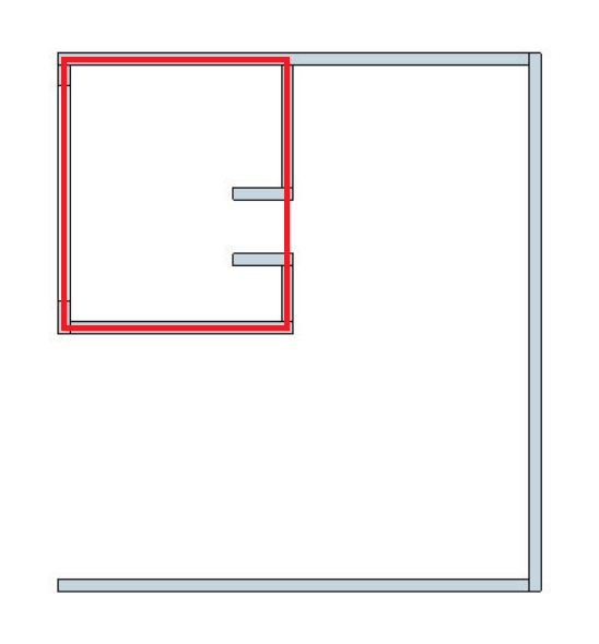

hi david if i use the back panel on this pic. i can sim it as the pi corner?
Hi Thawach,
If you are asking whether the complete system can be simulated as simply a bass reflex box (shown in red in Attachment 1) radiating into Ang = 0.5 x Pi because the blue-grey "back panel" portion of the cabinet serves as a corner, then the answer is no.
You would need to come up with a model for the complete system, including the back panel portion, radiating into (half?) space.

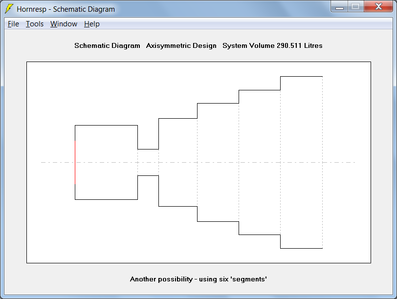

Fred has suggested one possible model using four stepped segments. I doubt that it would help in this case, but note that you can specify up to 6 segments if necessary, by including front chamber and Cyl throat adaptor components together with 4 segments (stepped), as shown in Attachment 2.
Just to clarify - I am saying that having two extra segments would probably not help in this case, not that using Fred's suggested model would not help .

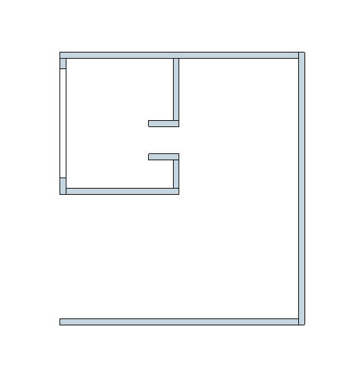

like so? - - - (tell me how you you sim those fabulous Karlson-ish cabinets)
Exactly!

thx u freddi i might not follow the hornresp very long time. i hv just known the hornresp can sim the difference segment. about karlson i had ever seen ur post. i saw the freq respond from u measured. i sim as the same bp. and i tried to understand the effect of the front panel. and drew them until it was finish. i have one karlson design that i still not finish. it s karlson line array if it is finish ill tell my friend measure them.
