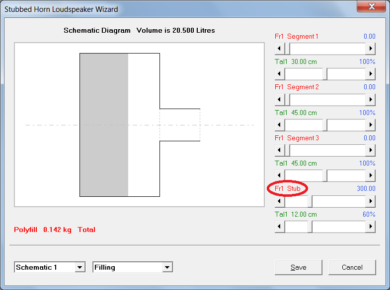

Hornresp Update 5000-190501
Hi Everyone,
CHANGE 1
Coding changes have been made to prevent the fatal run-time error experienced by Berd and reported in Post #9381, from occurring in the future.
CHANGE 2
Hornresp now closes when the user elects to download a copy of the latest release after being prompted on starting the program. Previously if the user downloaded a new version and tried to install it while the earlier version was still running, the installation of the new version would fail. My thanks to Brian for his Post #9418 suggesting this change.
CHANGE 3

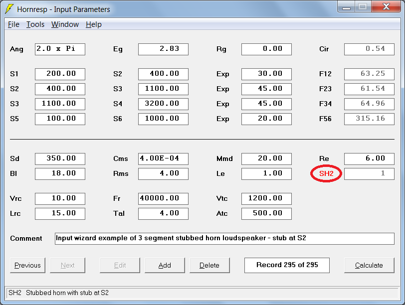

Stubbed horn systems can now be simulated using the SH arrangement options.
SH1 positions the stub at S1 in a 1, 2 or 3 segment horn.
SH2 positions the stub at S2 in a 1, 2 or 3 segment horn.
SH3 positions the stub at S3 in a 2 or 3 segment horn.
SH4 positions the stub at S4 in a 3 segment horn.
The stub is specified using segment 4.
Attachments 1 to 3 refer.

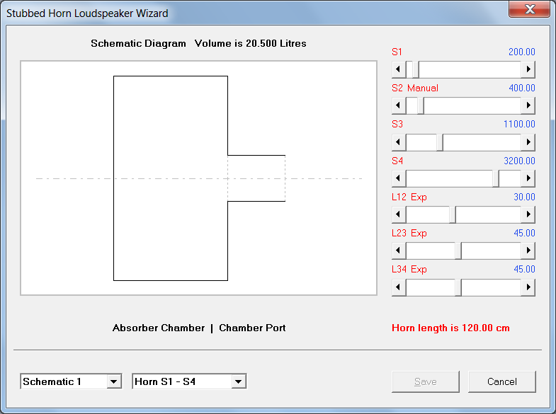

Ap2 and Lp can be used to insert a port tube before the stub. The stub and port tube can then be used to form a Helmholtz resonator absorber chamber. Attachments 4 and 5 refer.

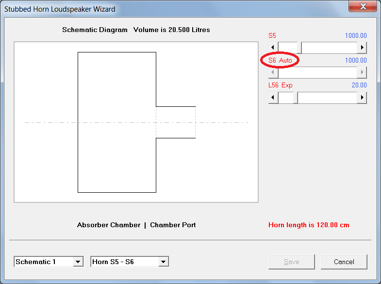

The S6 slider in the Loudspeaker Wizard can be set to Auto to ensure that the stub or absorber chamber is cylindrical. Attachment 6 refers.
The stub or absorber chamber can contain absorbent filling material. Attachment 7 refers.

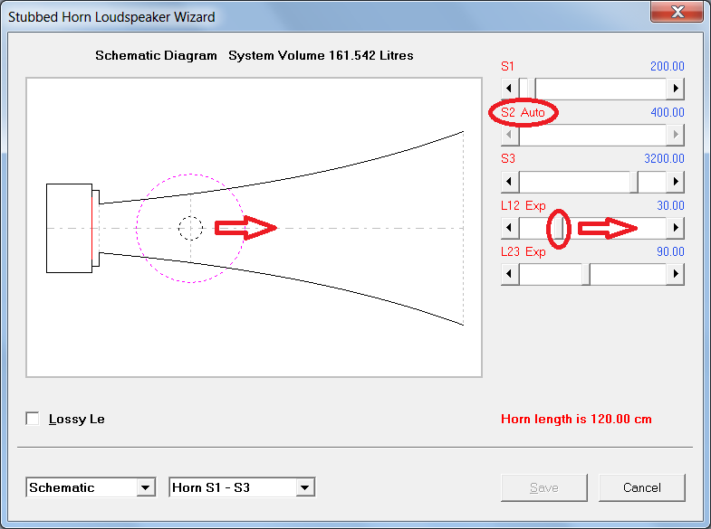

Using the Loudspeaker Wizard, it is possible to slide the stub or absorber chamber along the axial length of the horn and observe in real time the effect on the response. Attachment 8 refers.

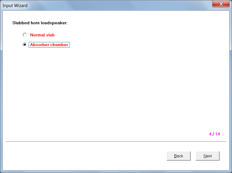

Stubbed horn systems can be exported to AkAbak, and the stubbed horn option has been included in the Input Wizard. Attachments 9 and 10 refer.
