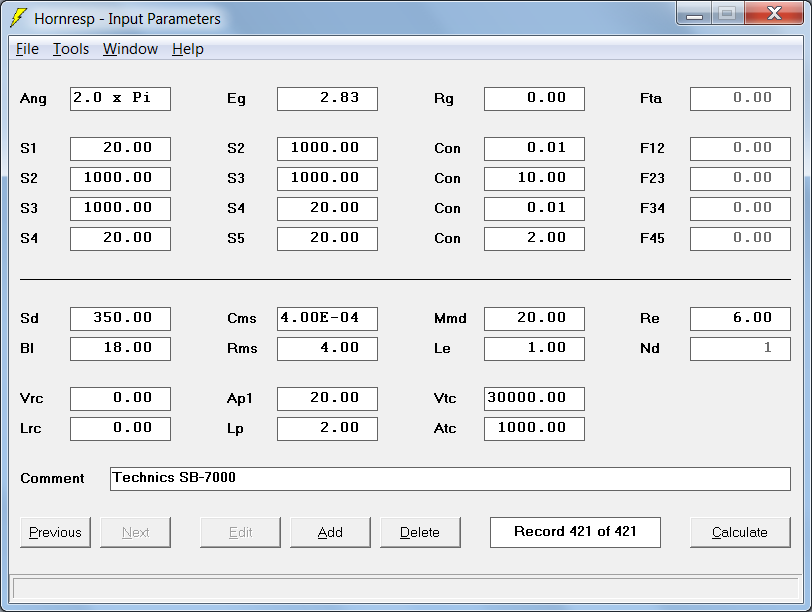

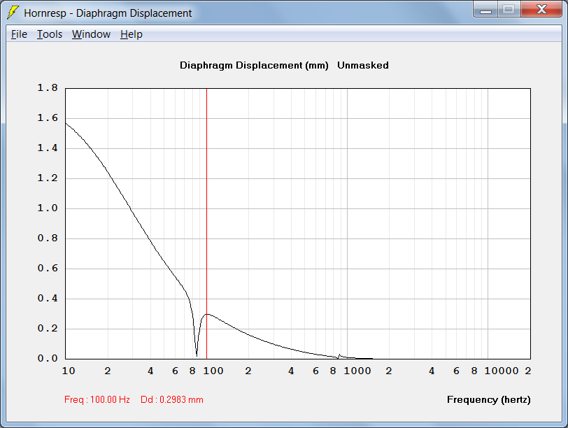

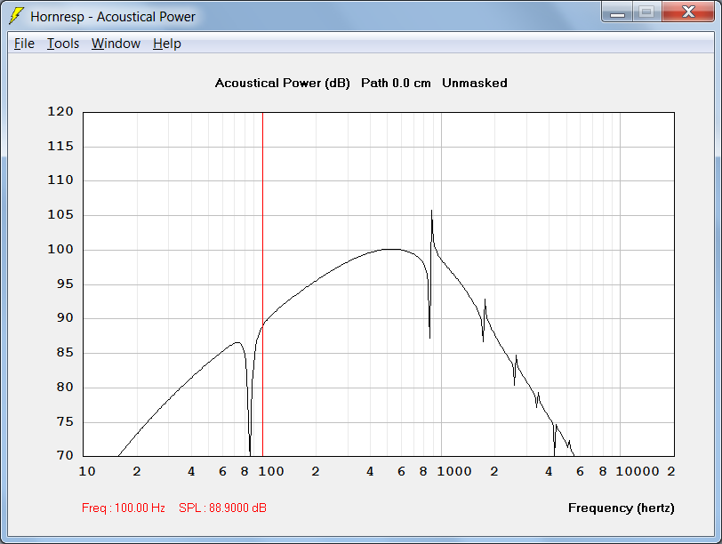

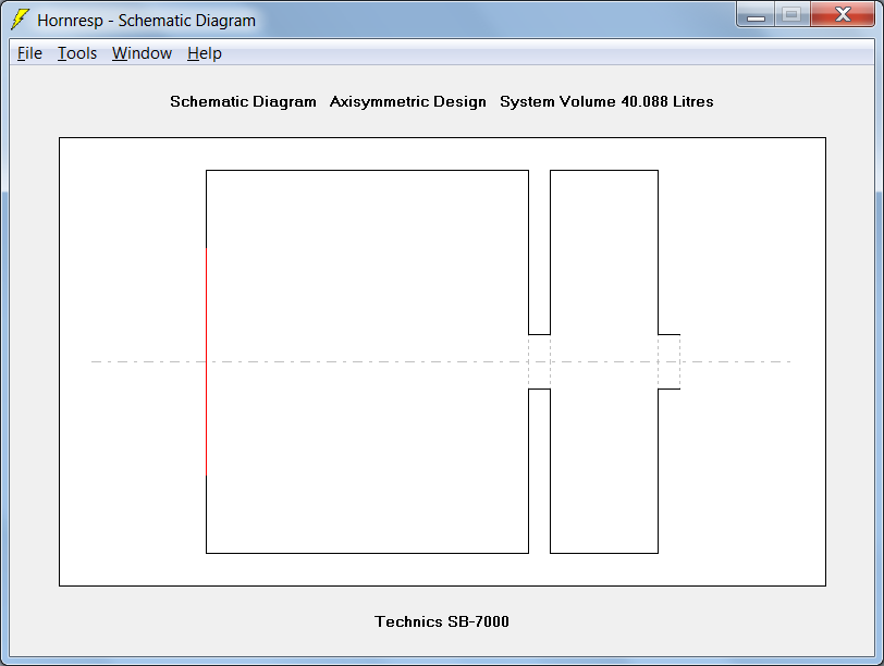

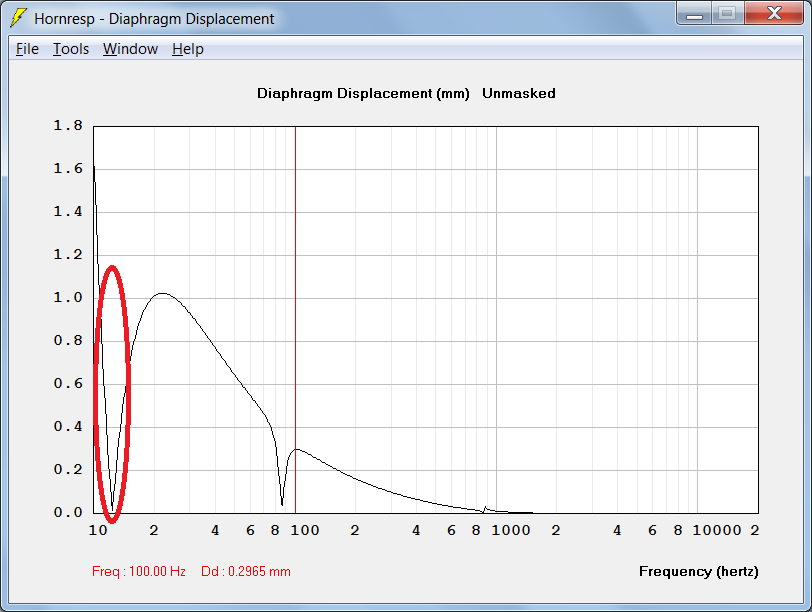

Hi Freddy,
The model I suggested is the closest that you can get using Hornresp, but it is by no means perfect 🙂. Hopefully the power response prediction should be reasonable though, provided that the Output 2 result is used.
It appears that the notch you are seeing is due to the effect of the very small hole in the second chamber. Notice how if you increase S5 to 1.00 sq cm for example, the notch disappears. I have no experience with dual chamber designs, but presumably the notch would not be present in a practical system, if the second chamber was completely sealed.
For a serious analysis it would be safer to use AkAbak, but I gained the impression that you were looking for an indicative result only, which is why I was prepared to provide the suggested Hornresp "compromise" model 🙂.

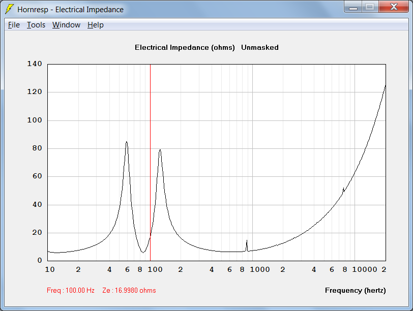

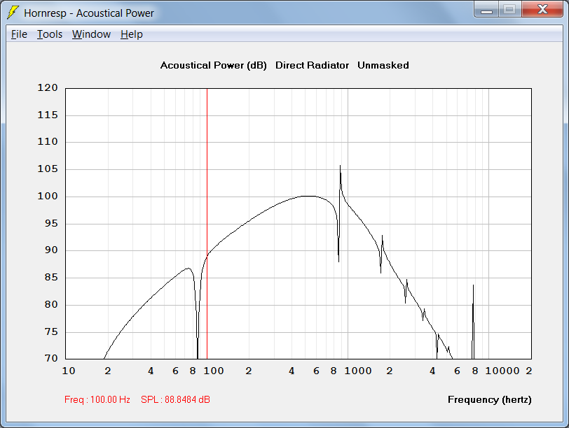

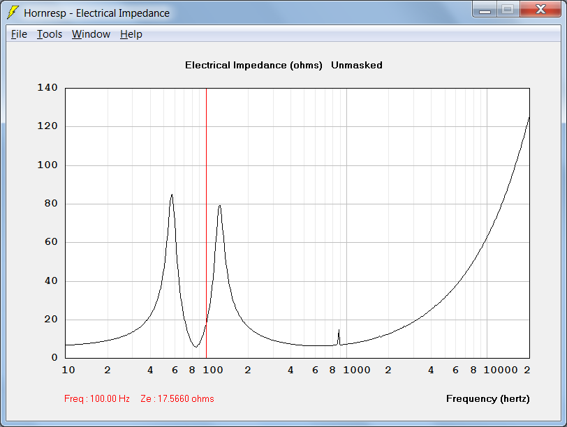

Hi Freddy,
Further to my message above, my curiosity got the better of me 🙂.
I temporarily jury-rigged Hornresp so that the second chamber was completely sealed.
Attachments 1 to 3 show the results obtained using a completely sealed second chamber.
Attachments 4 to 6 show the results obtained using the originally suggested "compromise" model.
As anticipated, the power responses are similar, and the notch in the diaphragm displacement disappears when the second chamber is completely sealed.
The electrical impedance results are also much the same.
Kind regards,
David

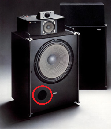

The two chambers are indeed connected. This is a type of bandpass enclosure.
the design shown is obviously a bit different to a standard bass-reflex / Helmholtz resonator setup.
The reason why I originally thought that the Technics SB-7000 was a conventional bass-reflex design was because I was looking at the attached photo, which clearly shows a port in the front baffle 🙂.

I don't know wherefrom this picture is.The reason why I originally thought that the Technics SB-7000 was a conventional bass-reflex design was because I was looking at the attached photo, which clearly shows a port in the front baffle 🙂.
It from japanese audio-heritage:

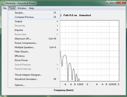

Can you help me function Compare previous the program hornrasp Compare graph 4-5 graph simultaneously.
Hi Piyapong38,
I am not sure what you mean by "Compare graph 4-5 graph simultaneously". 'Compare Previous' allows the user to compare current results against previously calculated results. 'Compare Captured' allows the user to compare current results against previously captured results. In each case only two sets of results are compared. Further details can be found in the 'Compare' section of the Hornresp Help file.

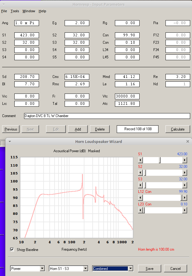

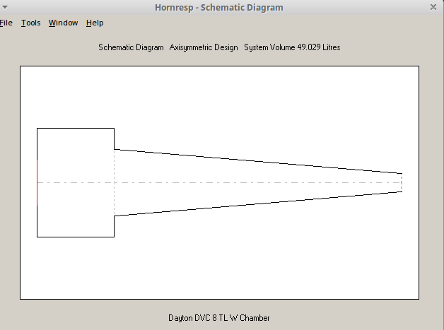

TL with back chamber
A few questions. For a project I am looking to make a TL sub with a back chamber that feeds the line.
1. Is this the way to model it?
2. Is it a feasible approach?
3. Does the entry to the line need to be directly behind and concentric to the driver or could it be a slot at the bottom rear of the chamber?
4. Has anyone done such a thing?
