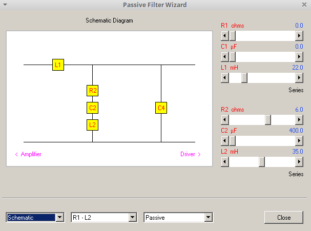

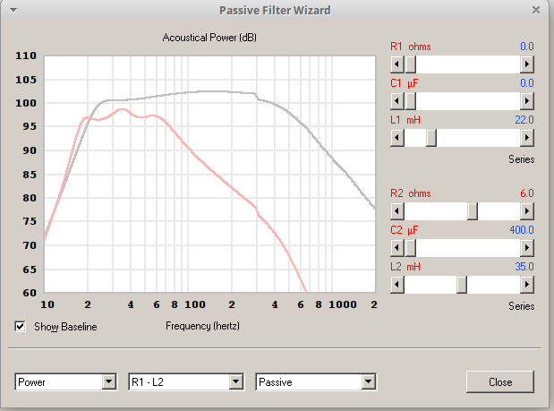

Hmmm... turns out an LRC notch filter has potential to tame the beast...

many thanks David - its interesting to see that a notch in displacement can occur below 20Hz - would that hold up under various reasonable drive levels with such a small interconnecting vent? - being internal no one should hear it wheeze (unless through the cone. BEST ! Freddy
Hi Freddy,
The model I suggested is the closest that you can get using Hornresp, but it is by no means perfect 🙂. Hopefully the power response prediction should be reasonable though, provided that the Output 2 result is used.
It appears that the notch you are seeing is due to the effect of the very small hole in the second chamber. Notice how if you increase S5 to 1.00 sq cm for example, the notch disappears. I have no experience with dual chamber designs, but presumably the notch would not be present in a practical system, if the second chamber was completely sealed.
For a serious analysis it would be safer to use AkAbak, but I gained the impression that you were looking for an indicative result only, which is why I was prepared to provide the suggested Hornresp "compromise" model 🙂.

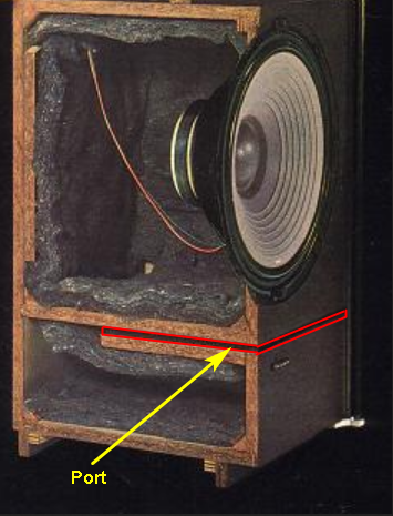

Is possible to calculate whith Hornresp Helmholtz resonator like Technics SB-7000?
Hi Orion33,
Yes, bass-reflex systems can be simulated in Hornresp. The easiest way to get started is to create a representative design using the Input Wizard, and then change the input parameter values to suit. Select:
Help > Input Wizard > Half Space > Direct Radiator > Ported Box ......
Kind regards,
David
Thank you for answer, David.
But Helmholtz resonator is not bass-reflex system. See please picture
Resonanse camera is not connected to main box whereas bass reflex port is directly connected. I tryed create think section with maximal acoustical lining resistance but its behavior is diffrent from closed box. Or am I wrong?
