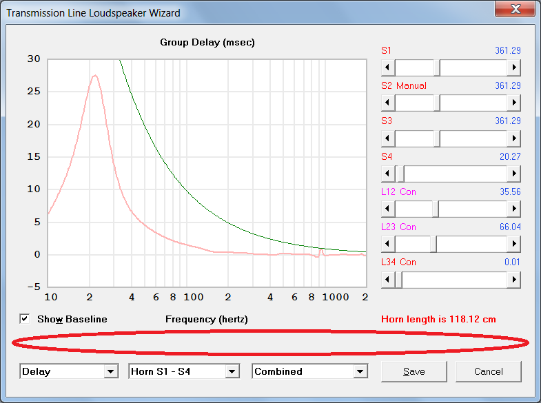

BUG 1
The timer mouse pointer would stay on after the loudspeaker wizard group delay chart was double-clicked, if absorbent filling material had been specified.
BUG 2
The separating line below the loudspeaker wizard group delay chart was being hidden when a limit line was added - see attachment.

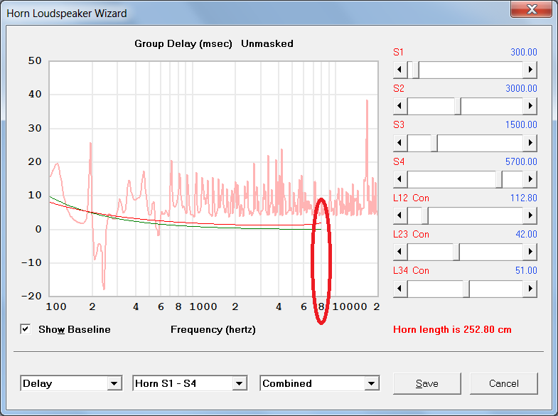

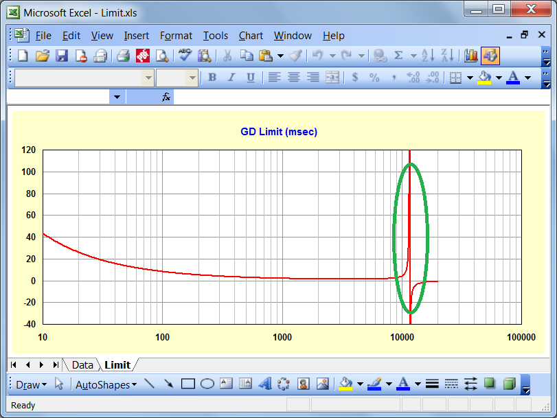

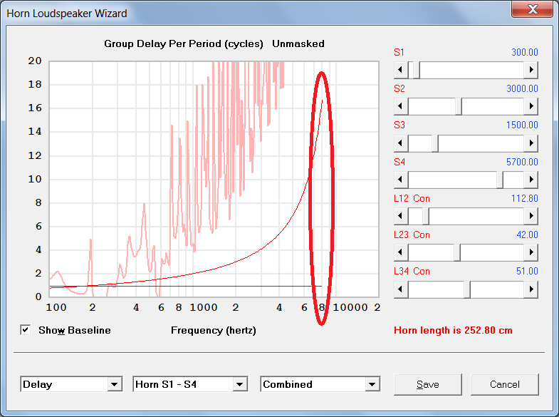

Hornresp Update 4520-180621
Hi Everyone,
CHANGE 1
The maximum frequency of the 1/f and Claus Futtrup group delay limit guidelines has been increased from 2000 Hz to 8000 Hz. It is not practical to extend the upper frequency beyond 8000 Hz because the Claus Futtrup expression starts to break down and produce erroneous results above that frequency. Attachments 1 to 3 refer.

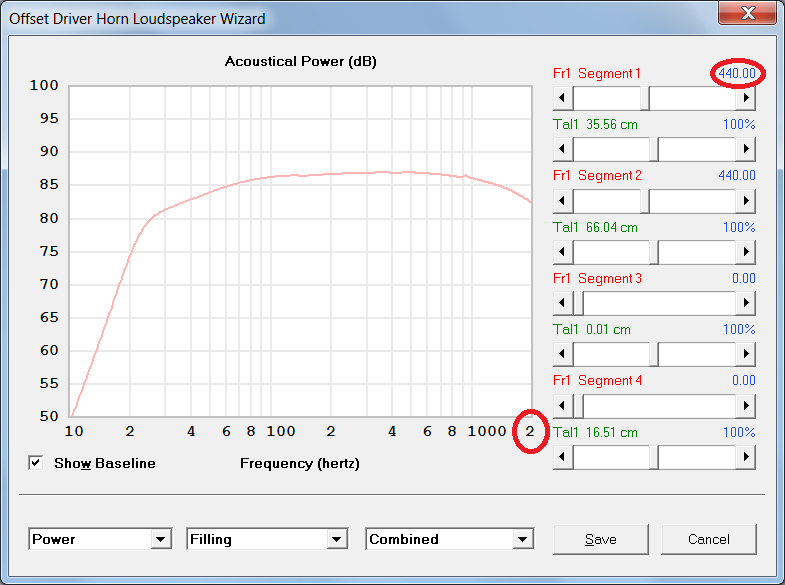

CHANGE 2
With the 1 - 2000 Hz frequency range selected, and acoustical filling material specified, the loudspeaker wizard chart frequency scale can now be switched from 1 - 200 Hz to 10 - 2000 Hz if required. Previously this was not possible. Attachment 4 refers

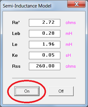

Hi Mark,
I blame to much sun on my little bean.
So now this leads me to ask if the lossy Le button still has relevance?
As Brian and Josh have indicated, the Lossy Le model can be useful when nothing better is available.
Or are you incorporating the semi-inductance model throughout all of the Hornresp calculations?
The semi-inductance model is incorporated into all Hornresp calculations, but is activated only when the user enters non-zero values for the advanced driver parameters Re', Leb, Le, Ke and Rss, and clicks the On button.
Kind regards,
David
