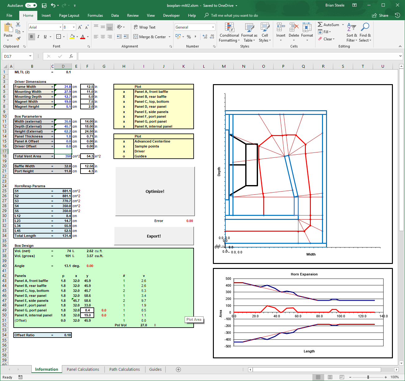

Hey, I'm getting a "runtime mismatch" error when trying to use the Filter Wizard with an OD1 sim created from an imported file.
First image is the Boxplan workbook that's creating the import file. The txt file is the import file and the last image is the error message being generated when I try to use the Filter Wizard.
Another thing, with OD, L12 and L23 are linked, however with OD1, L23 and L34 aren't linked.

Hi Brian,
Thanks for the feedback. It's not just with an OD1 simulation that the problem occurs. The bug will be fixed in the next release.
That was intentional - it would have required significant additional work to include the feature. I might have a look at it again, when I have nothing better to do 🙂.
Kind regards,
David
I should have perhaps mentioned that until the bug is fixed, the problem can be circumvented by pressing the F8 key in edit mode to reset the current record filter parameters to their default values.
The bug was introduced with the release of Version 43.00, as a result of adding the semi-inductance and frequency-dependent damping models.

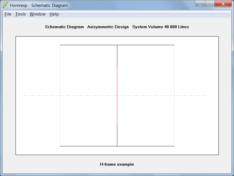

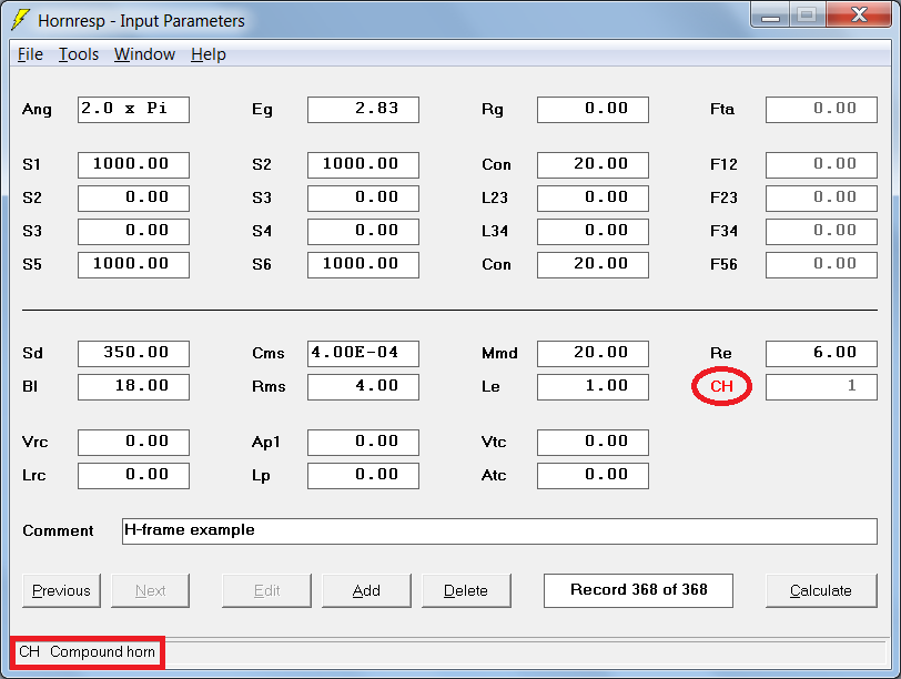

Hi David
I want to model an H-frame for open baffle bass, so I down loaded Hornresp, read lots and got stuck. Can Hornresp model an H-frame including the loading of the air in the H-frame? Is their a guide for dummies for setting up an H-frame in Hornresp?
Hi kazap,
The loading of the air in the H-frame is automatically taken into account by Hornresp. In effect what you have is a compound horn, made up of two equal-length, equal cross-sectional area, cylindrical horns. The path length difference to be specified will depend upon the orientation of the cabinet relative to the listener.
I am not aware of any specific H-frame guide, but a Google search should unearth something I expect.
The attachments show a representative example design.
Kind regards,
David

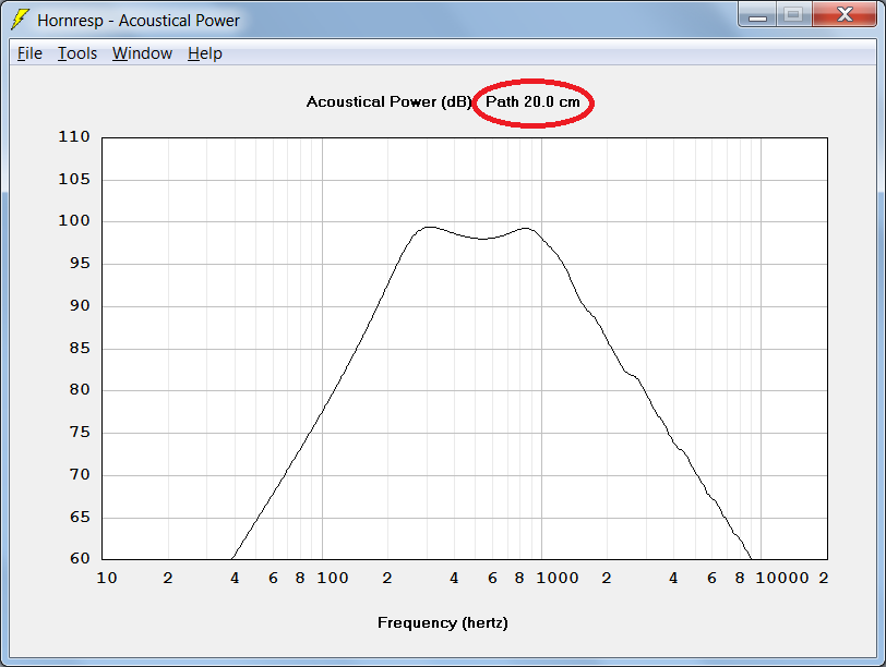

Hi David
Thanks very much for the example which is a great instruction tool and now I've got an H-frame model working. Your software is a huge gift.
My last query is about the point the Acoustic Power (dB) is modelled from? Is i a defined point like 1000mm in front?
Cheers mate.

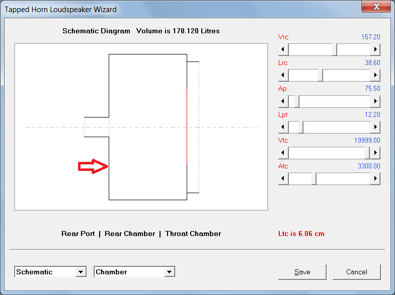

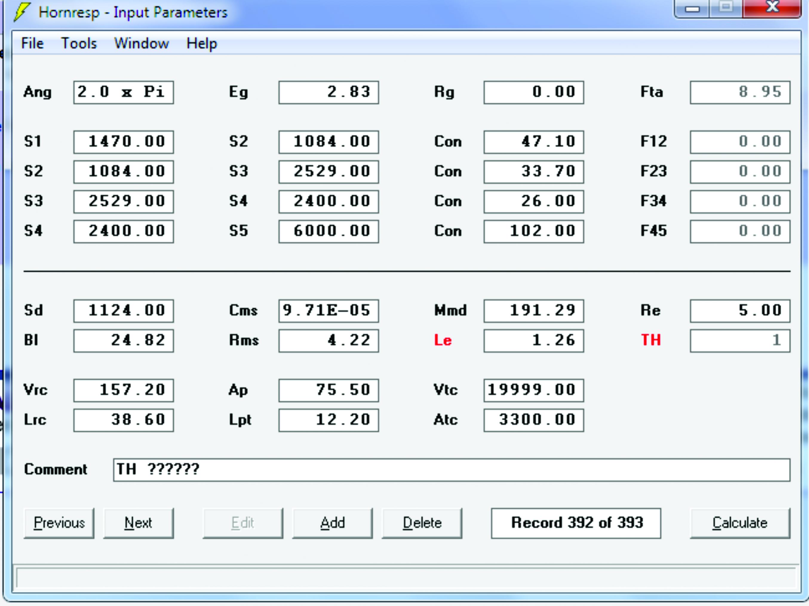

Hi, can you please help me identify the error with my Hornresp moves
as you can see it shows a very weird spl graph when there is power applied to it and also it indicates insane diaphragm movement, what am I doing wrong?
This is Xoc designed TH18 so the design should be ok.
The driver is 18 sound 18lw1400
