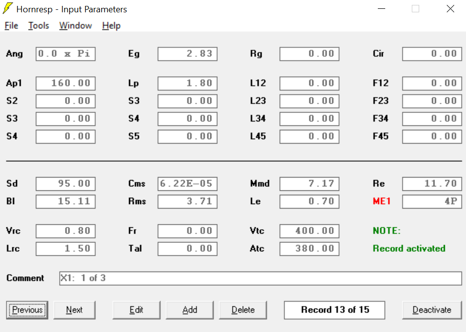

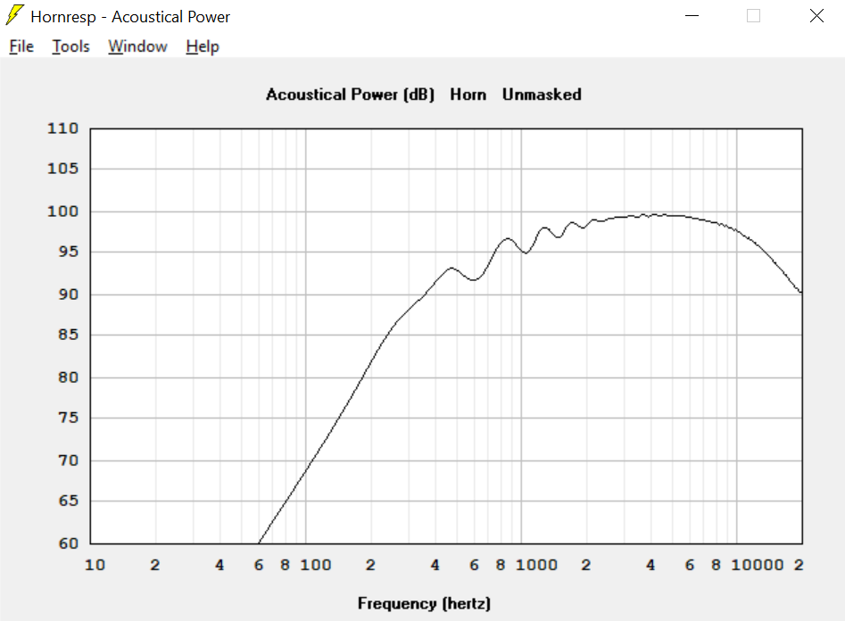

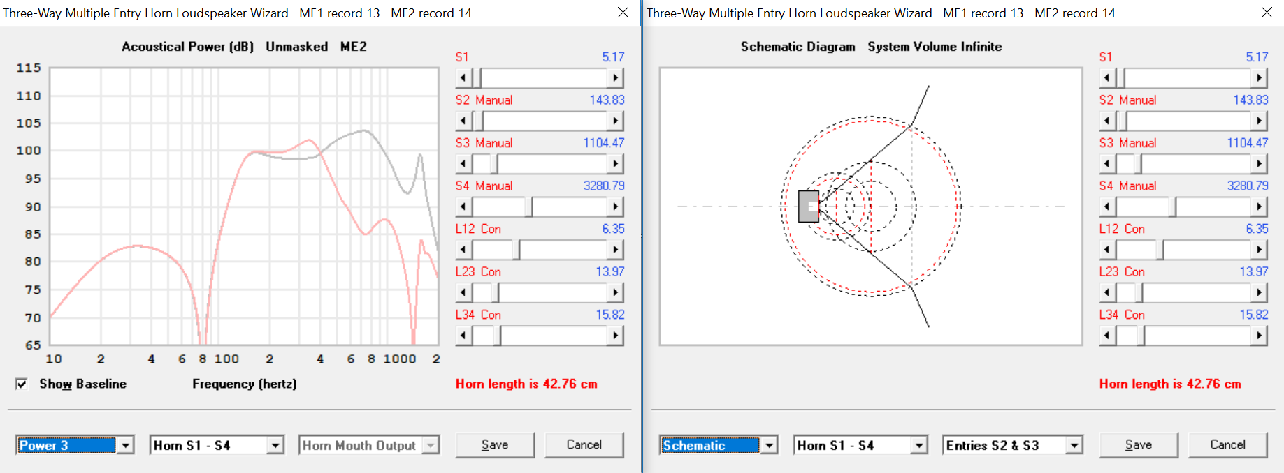

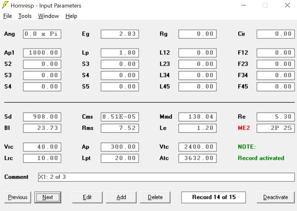

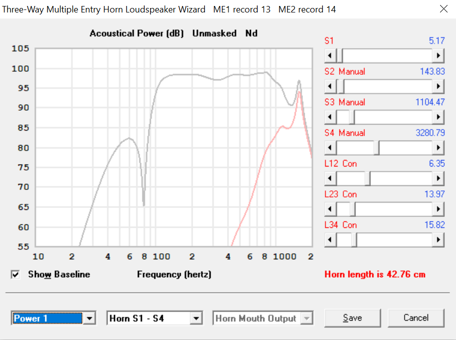

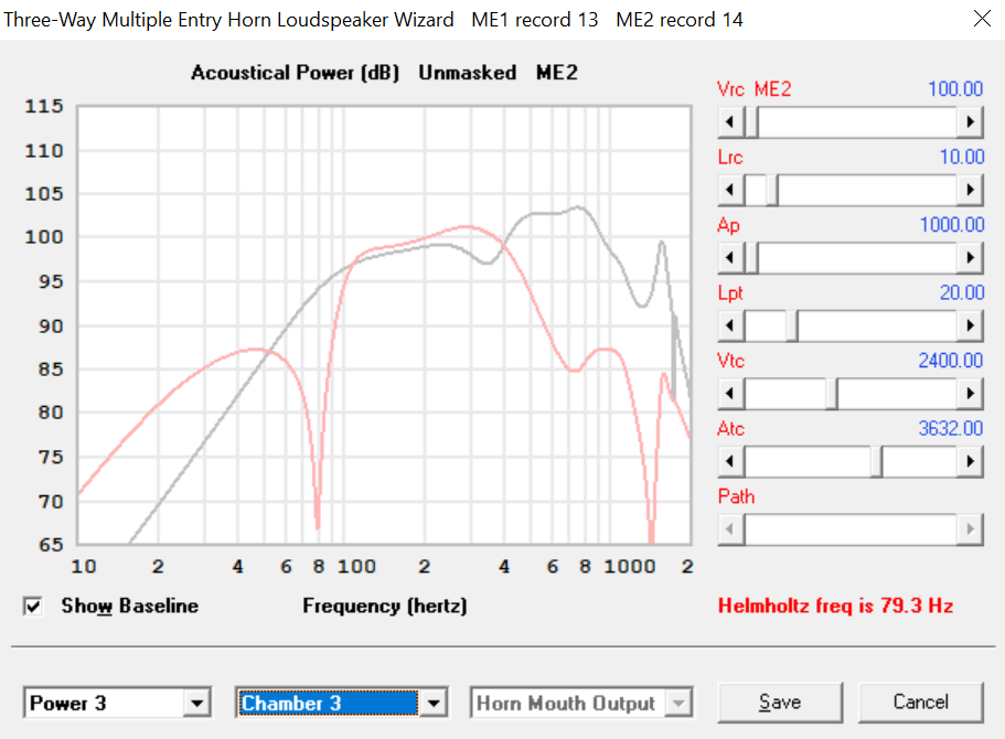

I'm back at it here, this time trying to model a Synergy-type horn, mostly to continue getting the hang of the software.
I've entered all the relevant driver parameters in ME1 and ME2, then activated both records and opened the Multiple Entry Horn Wizard from the 3rd record.
When I model each of ME1 and ME2 individually (as separate stand-alone records), I get approximately the results I seek, but the Wizard nevertheless seems to give me a big mess.
Attached are screenshots of each individual record, plus two screenshots of the Wizard (schematic and power views).
Any idea what I'm doing wrong?
Thanks again 🙂

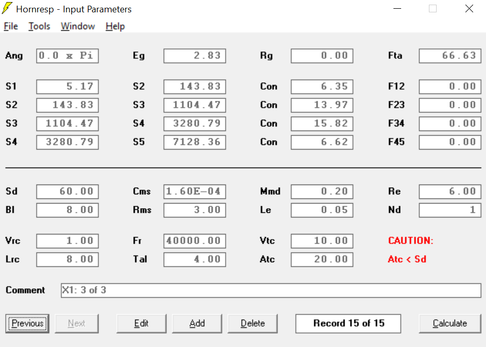

Hi Andreas,
In your Nd record (3 of 3) you have specified an infinite length horn. Change Ang to 2.0 x Pi or 4.0 x Pi.
In the wizard you are looking at the horn-side power response of ME2 only. Select Total Power and Combined Output to see the overall system performance.

Thanks again 🙂
I've now changed Ang in my ND record to 4Pi. It remains zero in both ME records though - is that as it should be?

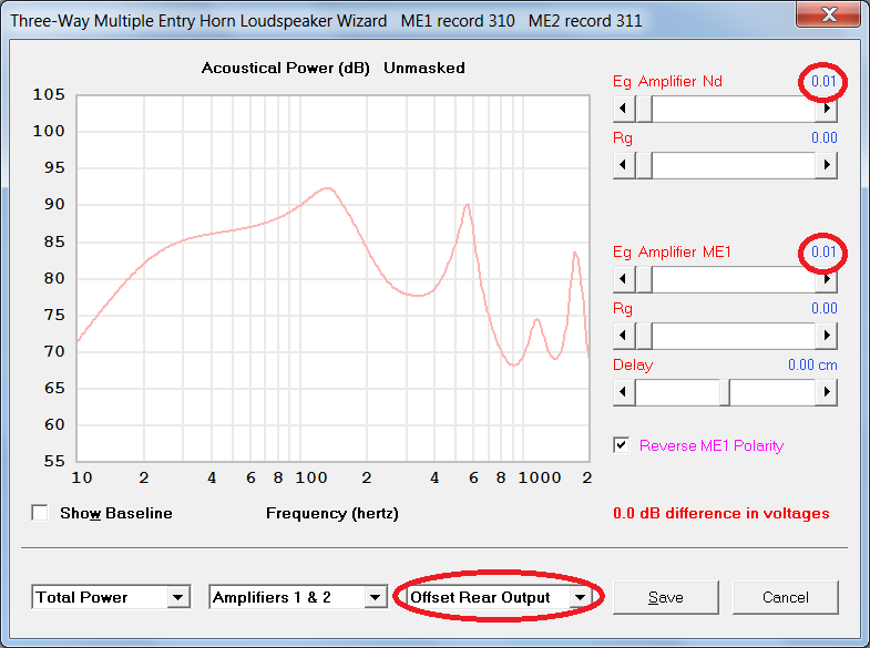

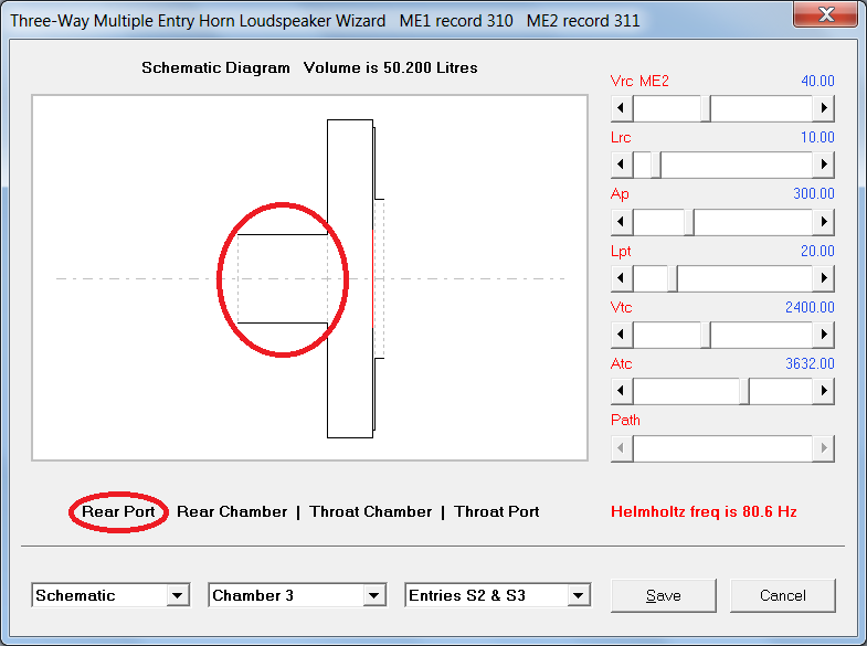

Back in the Multiple Entry Horn Wizard now, I'm trying to experiment with adding bass reflex ports to the bass woofers.
Am I going about it right? I can see a null in the woofer output at the tuning frequency in the frequency response, but I'm not sure how to see the output from the port or the combined output from the port and the woofers. Is there some way to do this?

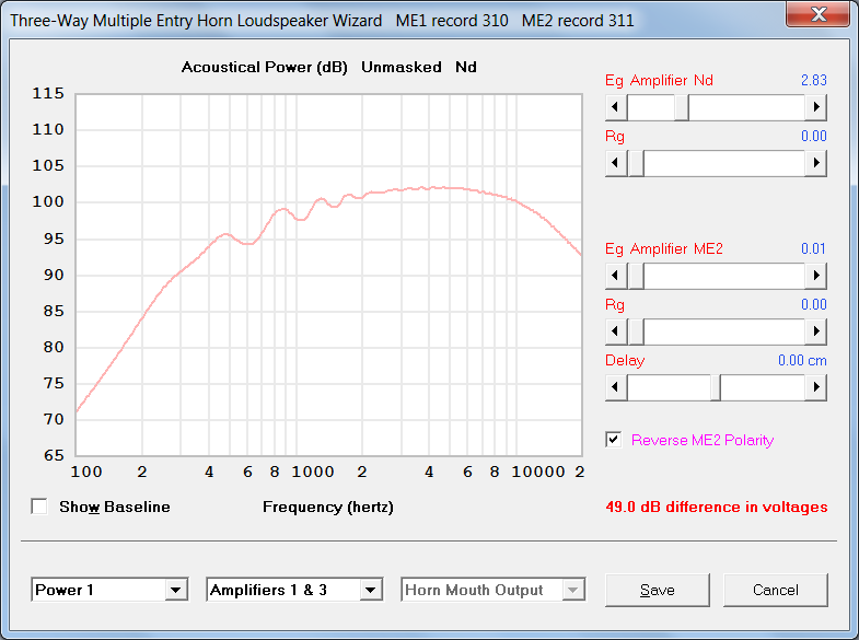

Hi Andreas,
The Ang parameter is not applicable to ME records, which is why it is set to zero and cannot be changed by the user.
1. Mask the outputs from the Nd compression driver and ME1 drivers as follows:
1.1. Set the Nd and ME1 Eg values to 0.01 (when the Eg slider has the focus, key in 0.01 and press Enter to set the slider value) - see Attachment 1.
1.2. Set ME1 Ap1 and Lp values to 0.01 - see Attachment 2.
2. To see the output from the port, select Total Power and Offset Rear Output - see Attachment 1.
3. To see the combined output from the port and woofers, select Total Power and Combined Output - see Attachment 2.

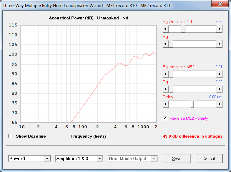

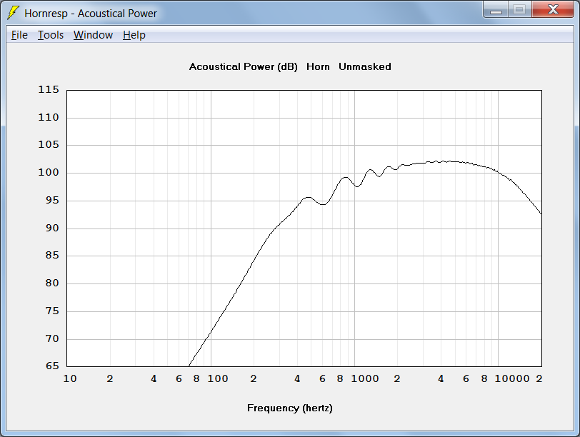

And regarding the compression driver output, what would the reason be for the massive difference between the modelled outputs in the Wizard and when calculated?
Hi Andreas,
You need to remove the effect of the ME1 and ME2 drivers and associated chambers by setting the ME1 and ME2 Eg and Ap1 values to 0.01.
As you have discovered, the interactions between the drivers in a Synergy-type loudspeaker system are extremely complex 🙂.
Kind regards,
David

Thanks again David. I do realise that the interactions are very complex, but what the sim seems to be doing is modelling the ME1 and ME2 ports as two single large ports (not 8+ small corner ports), which would result in the gross modelled interference - or so I hope! Is that a correct assumption?

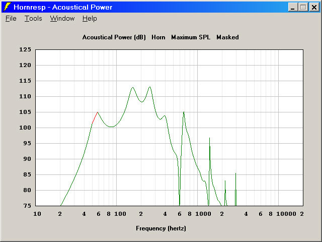

Maybe the answer to this is buried somewhere in the previous 800+ pages of this and I missed it... but, here goes....
I'm having one of those moments where the thought of common sense real-world application, & simulation results are causing the misfiring of too many synapses to ignore.
Then again, maybe I just don't have a deep enough understanding of the physics involved & this is actually true. Wouldn't be the 1st time for that either. 😀
In a nutshell, the basic question is.... Does location in space (half, quarter, eighth, etc) actually effect the physical action/loading of the driver in the box?
If I take a box, that's performing perfectly (physically & electrically speaking - ignoring frequency response for the moment) while sitting in a corner of a room (0.5xPI), would that change (and if so, why) if I did nothing else but took that box out of the corner & hung it in the middle of space (4.0xPI)?

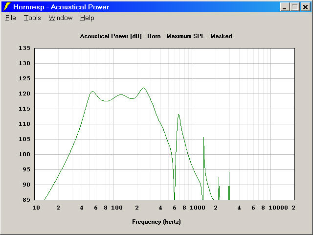

While messing with simulations on various drivers as replacements for an old bass guitar horn-type cab, I was well into trying various drivers when I noticed that I had forgotten to change Ang from the default 0.5 to 2.0. After making that change, I noticed that for the same wattage input the driver now hit it's X-max limit 5Hz higher in half-space than it had in eighth-space. (60Hz vs 55Hz)
Does that happen in the real-world?
Maybe I'm splitting hairs here. 5Hz in the grand scheme of things as far as this particular situation goes isn't a huge deal. & maybe this is just one of those situations where a simulation & real-world application are going to differ without the sim getting overly complex in its calculations. But, it stuck my curiosity nerve too much to ignore, so I have to ask.
As an illustration.... in the two attached screen-shots, both are the same driver, same box, both being fed the same power... only difference is that one is in eighth-space (0.5xPI) while the other is in free-space (4.0xPI). Notice that the one in free-space is hitting its X-max between 50 & 60Hz.
Nothing changed, just the box moved from a corner to being hung in the middle of space.
Hi Andreas,
As the schematic diagrams show, the multiple components of ME1 are modelled as a single composite driver / chamber / port assembly. ME2 is treated the same way. This can be done because a plane wavefront one-dimensional simulation model is being used for the analysis. As far as the model is concerned, it makes no difference if one large port, or multiple ports with the same total cross-sectional area, are specified.
The predicted results for the overall system should be reasonably close to the measured performance. You would need a very sophisticated finite-element analysis program that could take into account the precise locations of the port entries into the horn, to do much better.
Hornresp assumes an axisymmetric horn, so there are no corners in which to position the simulated ports anyway 🙂.

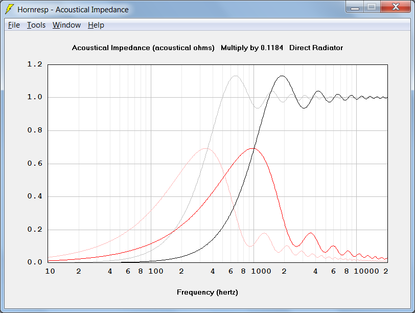

Hi Dix0,
Yes it does.
As can be seen from the Hornresp acoustical impedance chart, the acoustical impedance loading the driver diaphragm is dependent upon the solid angle into which the loudspeaker radiates. The legendary Klipschorn corner-horn system uses this principle to very good effect.
Kind regards,
David
Yes, position matters, because the acoustic load changes. This is due to reflection, which effectively increases the pressure on the radiator (diaphragm, horn mouth etc).
You can view it this way: the acoustic load on, say, a diaphragm, is the ratio of pressure on the diaphragm to the velocity of the diaphragm. If you place the diaphragm near a wall, some of the pressure radiated from the diaphragm is reflected back by the wall, increasing the pressure on the diaphragm. That means the acoustic load increases. If you move the diaphragm away from the wall, the reflected pressure decreases, and so does the load.
There is some discussion of what happens when you place a horn close to a wall in Chapter 7 of my thesis:
Thesis
Yes, see the experimental verification in Chapter 9, in particular 9.4.
