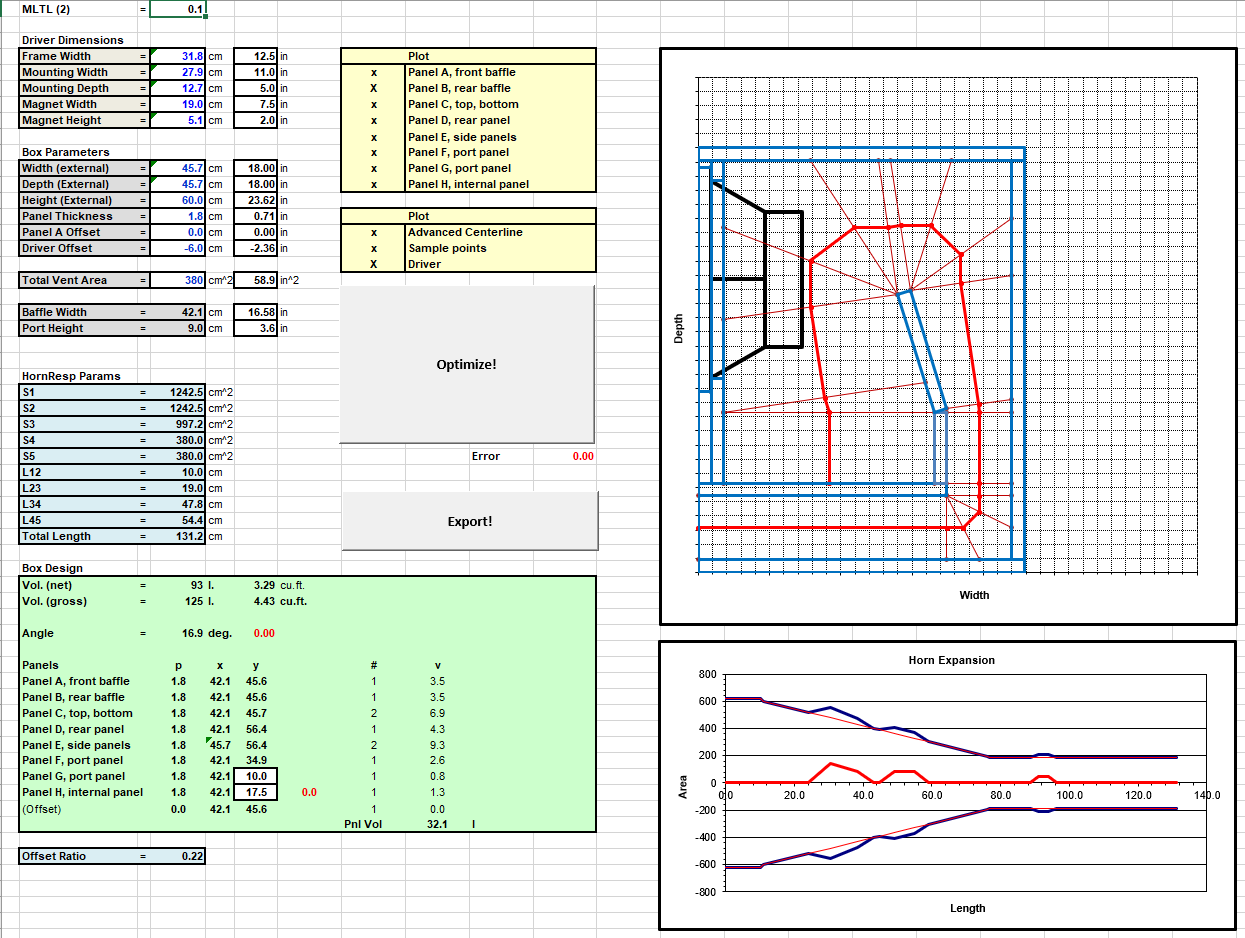

Hi David, what's the possibility of having an option for the OD type sim(say, "OD1") that has the driver positioned at S3 instead of S2?
I'm trying to model the layout shown in the diagram, which requires the driver be positioned at S3 in an offset-driver sim in Hornresp.
If it's TOO much trouble, don't worry about it.

That's great news, thanks. I was thinking that perhaps moving the driver position to another segment of the horn might not be that difficult to do, as it was done with the newly-added "CH1" option 🙂.
With this particular fold, I'm trying to address one of the shortcomings, i.e. the driver ended up being in the wrong position for a perfect offset. By putting the driver at S3 and modifying the expansion/shape of S1-S2, it might be possible to address this. Being able to sim it will show if that's really possible.

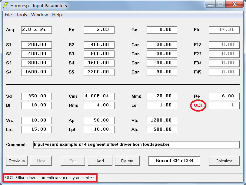

Offset driver horns can now have the driver offset point at either S2 (using the OD option) or at S3 (using the OD1 option). Attachments 1 and 2 refer.

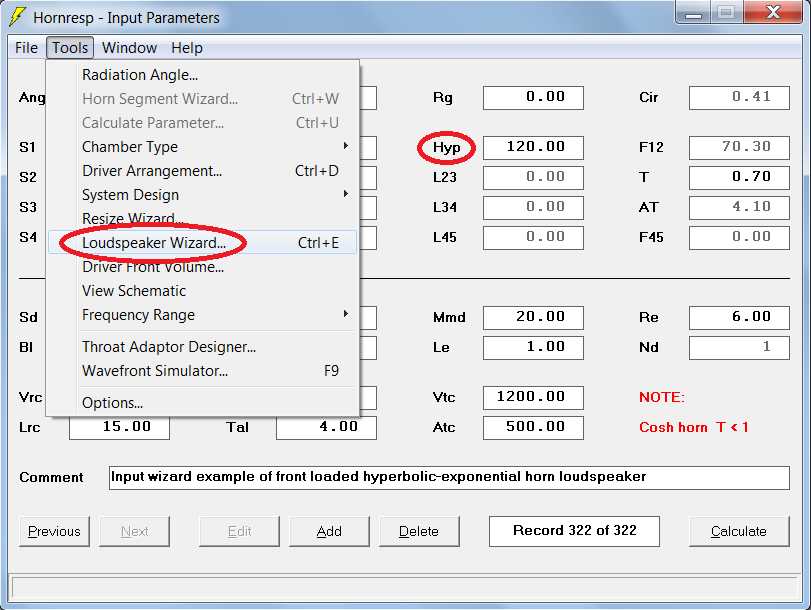

Under certain conditions the Loudspeaker Wizard was not being disabled for Hyp, Lec, Obl, Rad, Sph and Tra horns. Attachment 4 refers.

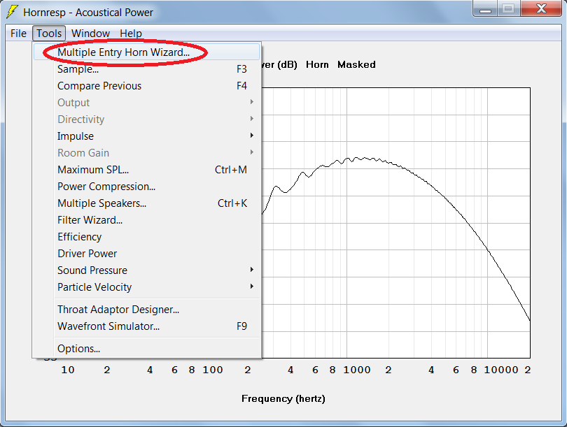

Under certain conditions the Multiple Entry Horn Wizard could be accessed from other than the Input Parameters window. Attachment 5 refers.

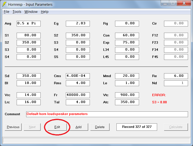

The Edit button was not being disabled when the Add button was used to copy an existing invalid record. The Edit button was enabled even though the added record was already in edit mode. Attachment 6 refers.

**Only** 141 different parts? Not that difficult then 🙂. Thanks! I'm going to resume work on that OD1 workbook today, and perhaps spend some time on the W-bin one if I get the chance.
