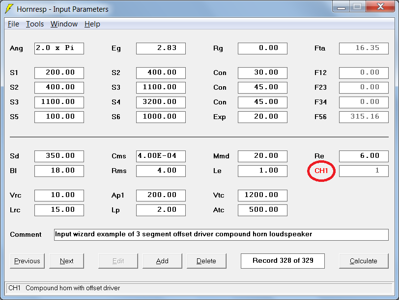

Hornresp Update 4400-180503

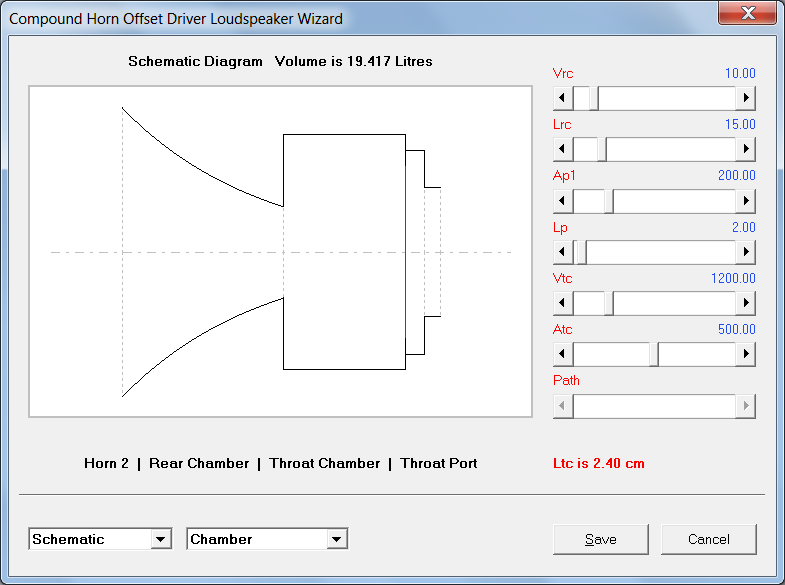

Hi Everyone,
CHANGE 1

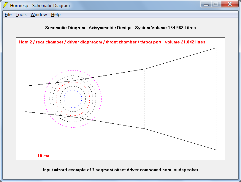

A compound horn system can now have the driver offset in Horn 1.
Attachments 1 to 3 refer.

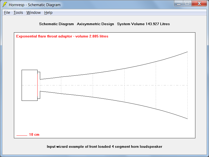

CHANGE 2
The throat adaptor can now have a conical, exponential or parabolic flare. Previously the flare was fixed at conical. Front loaded horns, back loaded horns and normal compound horns can now in effect have up to five segments.
Attachment 4 refers.

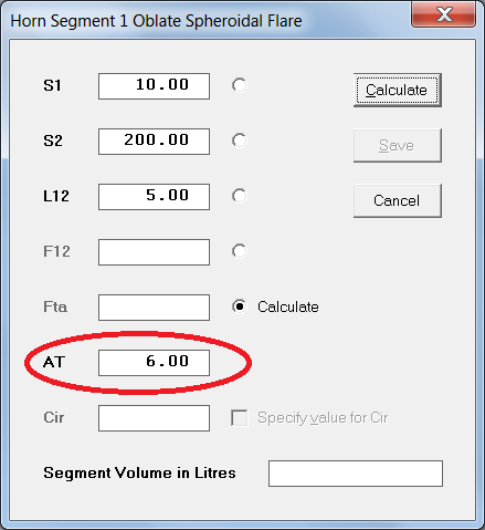

with a conical throat adapter can we have an OS first segment that starts out tangent to that conical throat adapter and then continue with the existing definitions for the remaining segments?
Hi Jack,
The Horn Segment Wizard can be used to match the throat entry half-angle (AT) of an OS waveguide to the mouth flare tangent angle (Fta) of a conical throat adaptor.
The attached example assumes that the conical throat adaptor has an Fta of 6 degrees, and that the OSW has a throat area of 10 cm^2, a mouth area of 200 cm^2 and an axial length of 5 cm. The Wizard will calculate the OSW flare having an AT of 6 degrees, exactly matching the 6 degree conical throat adaptor Fta.
Segments 2, 3 and 4 cannot be used when an Obl flare is specified.

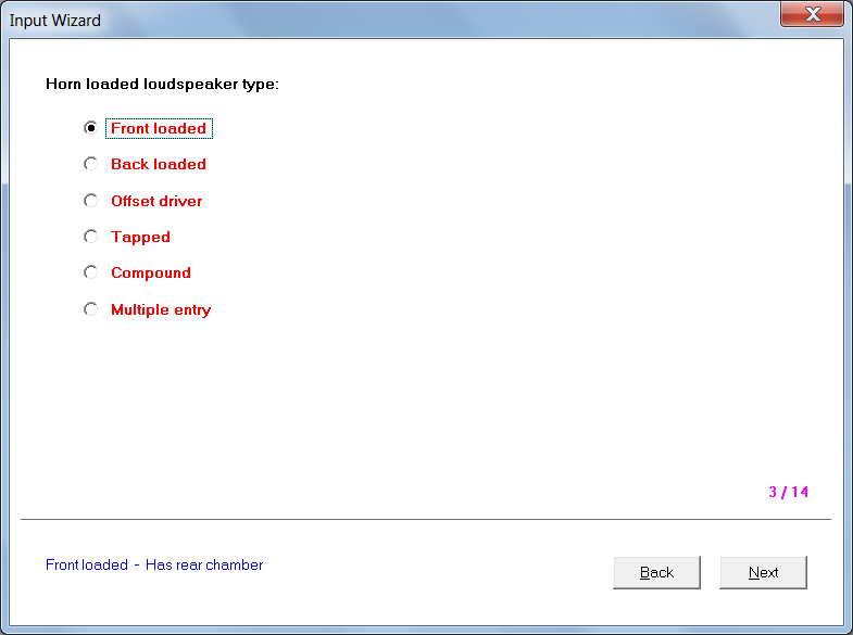

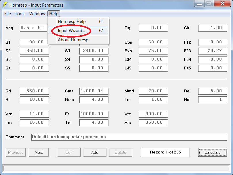

i just searched TH tutorial

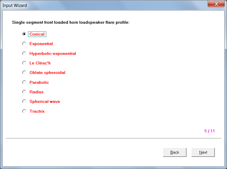

Hi Etocynned,
Suggest you search using the keywords 'Hornresp tutorial' instead.
The Input Wizard accessed from under the Hornresp Help menu will allow you to quickly generate an indicative design of the system you have in mind, step by step. You can then adjust the parameter values as required for your specific project.
Kind regards,
David

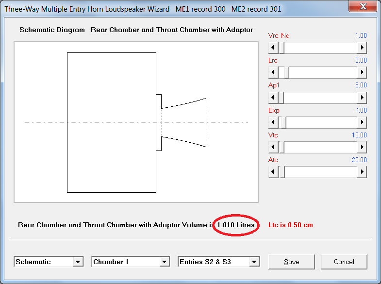

Hornresp Update 4400-180512

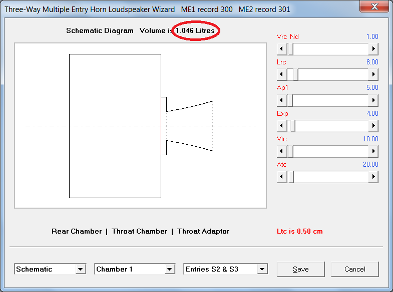

Hi Everyone,
BUG FIX
Throat adaptor volume was not being included in the multiple entry horn volume calculations when the Chamber 1 view was shown - see Attachment 1.
This has now been fixed - see Attachment 2.
Kind regards,
David

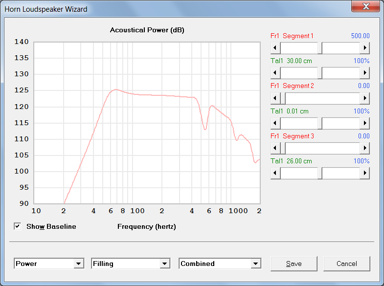

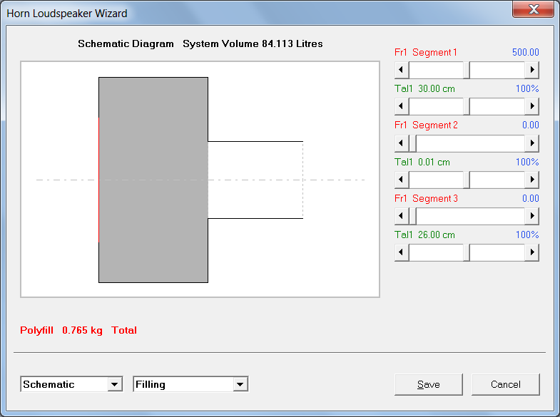

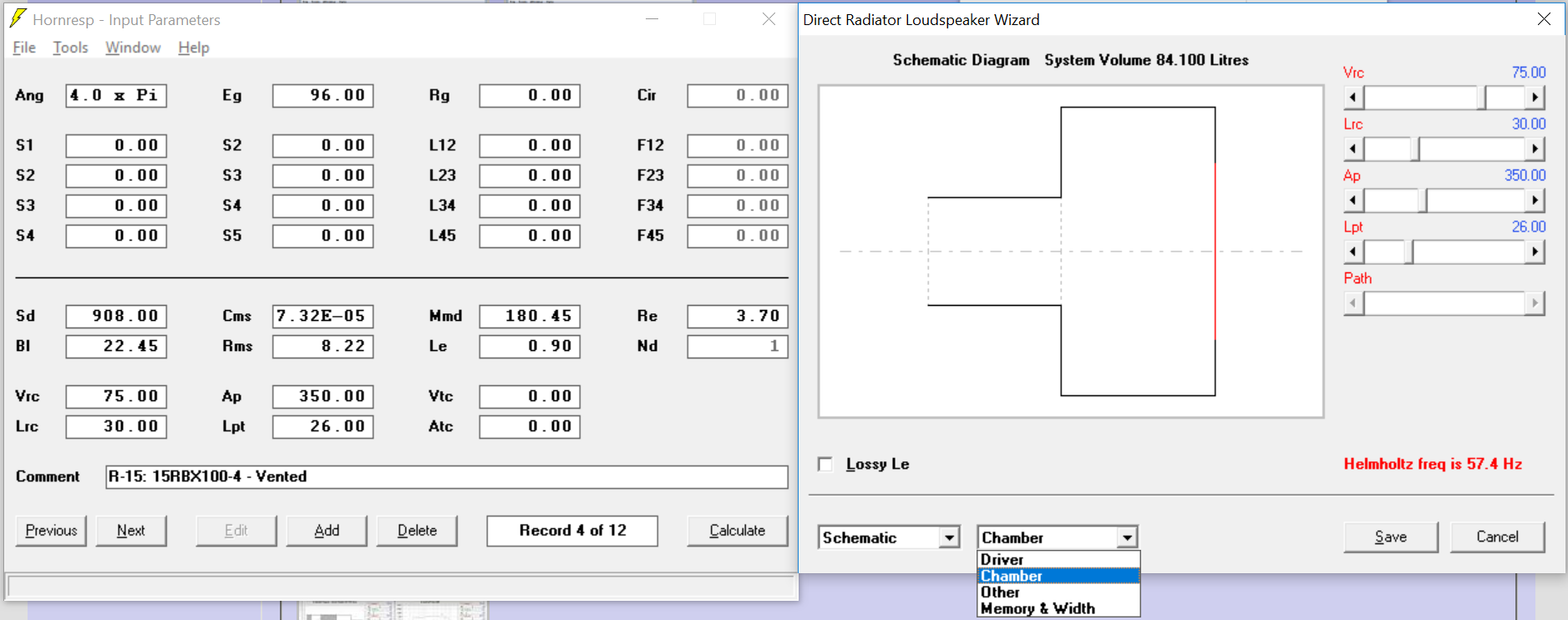

Hi again David 🙂

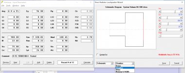

I'm trying here to work out how to model a humble vented box with acoustic lining. I've seen you post elsewhere (I think) that this is possible via the loudspeaker wizard. However, I don't seem to be having much luck...
Any ideas? Thanks.
Hi Andreas,
It is possible to specify acoustical lining in a closed rear chamber using Fr and Tal, or to specify a port tube in a vented rear chamber using using Ap and Lpt, but it is not possible to specify both together. Selecting the 'resonances masked' option will however remove the higher frequency standing-wave box resonances from the predicted response.
It is possible to include absorbent filling material in a vented chamber as shown in the attachments. It is not quite the same as adding a layer of acoustical lining to just the cabinet walls, but it will give you an indication of the effect you are likely to see.
Kind regards,
David
