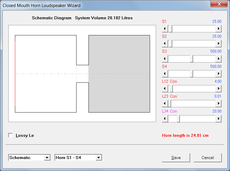

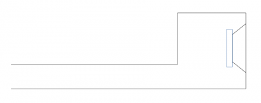

S1 and S2 will have the same value
S3 and S4 will have the same value
Make L12 the depth of the chamber
Make L23 .01
Make L34 the port/line length
Make L23 .01

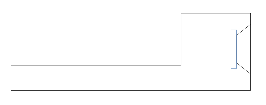

I know that I once saw a DIY done like this for sofa side but I can't seem to find it now. Anyone seen such lately?

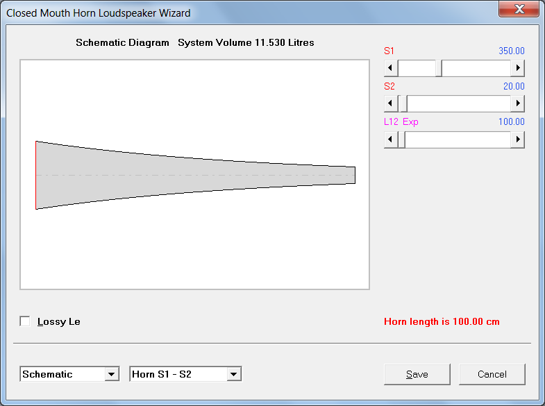

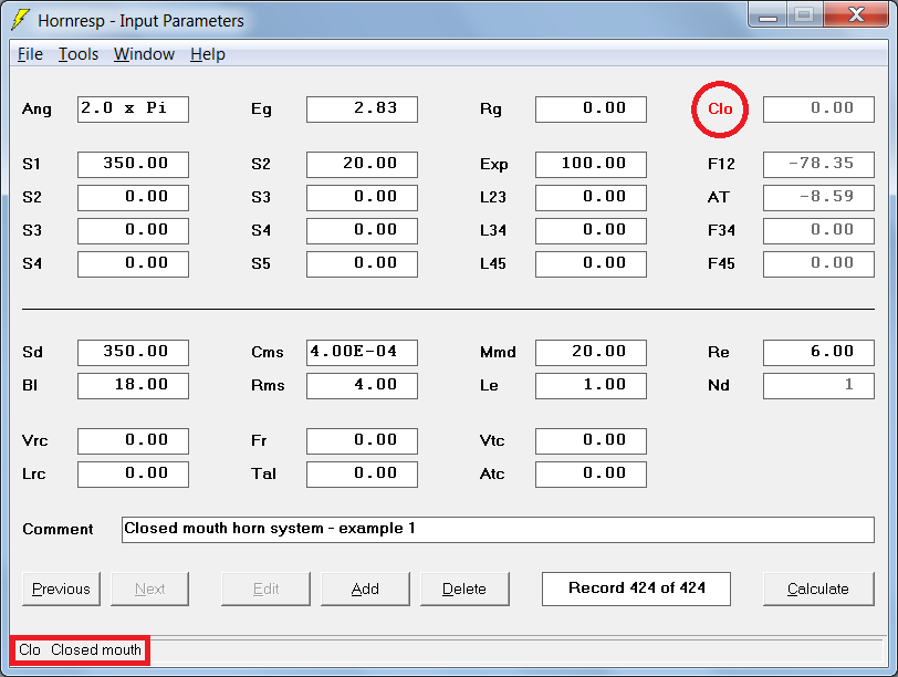

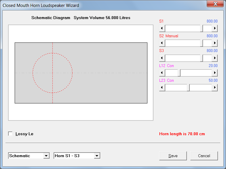

Hornresp Update 4600-180705
Hi Everyone,
CHANGE 1
The loudspeaker and filter wizard group delay chart limit guidelines are now removed by pressing the Esc key rather than by double-clicking on the Y-axis vertical scale. This makes removal of chart guidelines and markers consistent across the program.
CHANGE 2
Double-clicking on the Cir or Fta label in edit mode now specifies a closed mouth horn. Attached are three examples of closed mouth horn systems.
Kind regards,
David
Hi Everyone,
CHANGE 1
CHANGE 2
Kind regards,
David

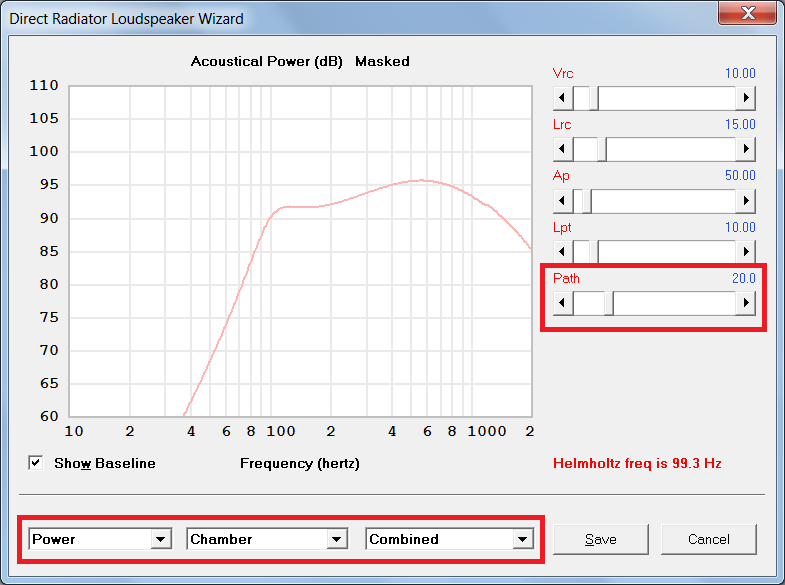

David, could you add "Acoustic path length between outputs" parameter to "Loudspeaker wizard" mode? Thank you.
Hi Orion33,
It's already there 🙂.
Display the Path slider by selecting the Chamber input option.
Enable the Path slider by selecting the Power and Combined output options.
Kind regards,
David

Thank you, David. I did not guess how to activate it 🙄Hi Orion33,
Kind regards,
David
