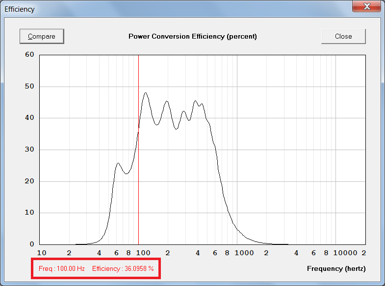

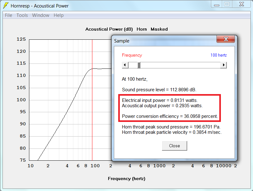

By definition, the Hornresp power conversion efficiency chart applies to the loudspeaker or multiple loudspeaker array only (perhaps I should have made this more clear in the Help file). The chart shows the acoustical output power divided by the electrical input power to the loudspeaker(s), expressed as a percentage. This is why it does not change when a filter assembly is included.
Sanity check:
Attachment 1 shows the default record power response chart with resonances masked. At 100 hertz the electrical input power is 0.8131 watts, the acoustical output power is 0.2935 watts and the power conversion efficiency is 36.0958 percent.
Attachment 2 shows the power conversion efficiency chart. At 100 hertz the power conversion efficiency is 36.0958 percent (the same as in Attachment 1).

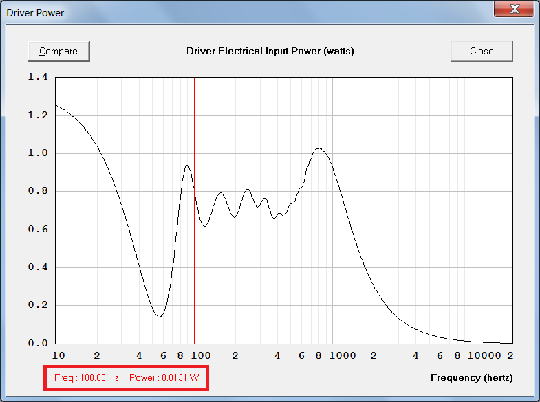

Attachment 3 shows the driver electrical input power chart. At 100 hertz the electrical input power is 0.8131 watts (the same as in Attachment 1).
