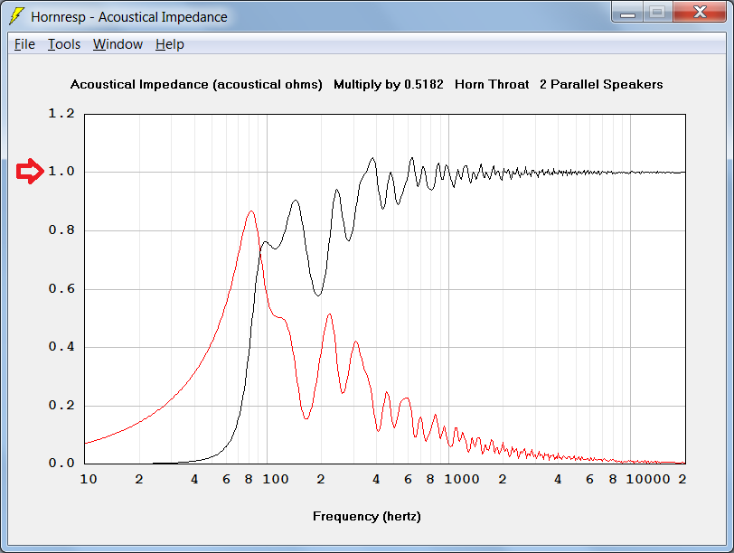

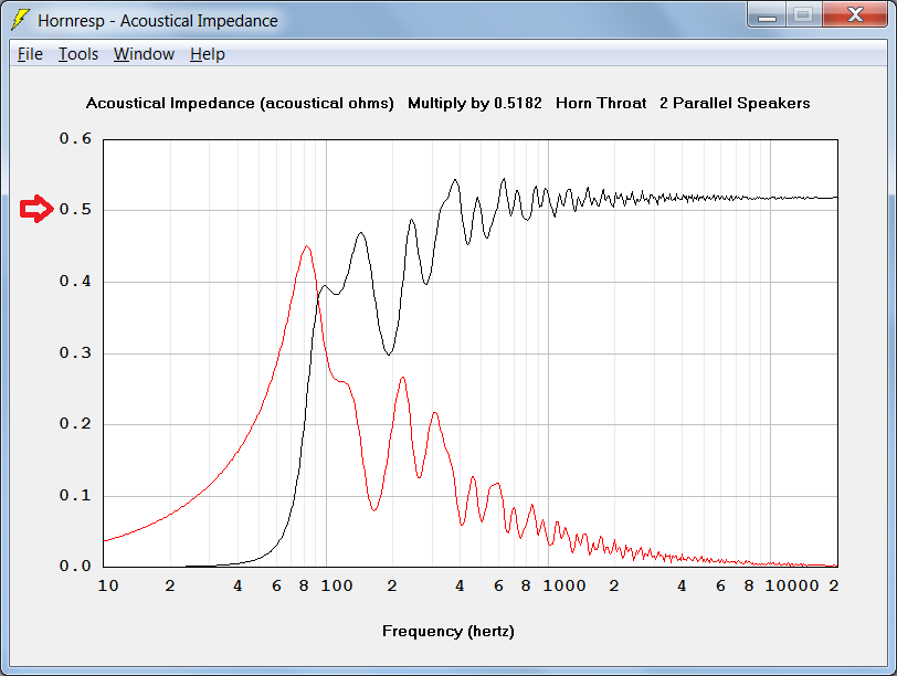

The throat acoustical impedance chart for multiple speakers (not including tapped horns), was displaying actual rather than normalised values. This has now been fixed.
Attachment 1 shows the incorrect values and Attachment 2 shows the correct values for the default record, assuming two speakers connected in parallel.

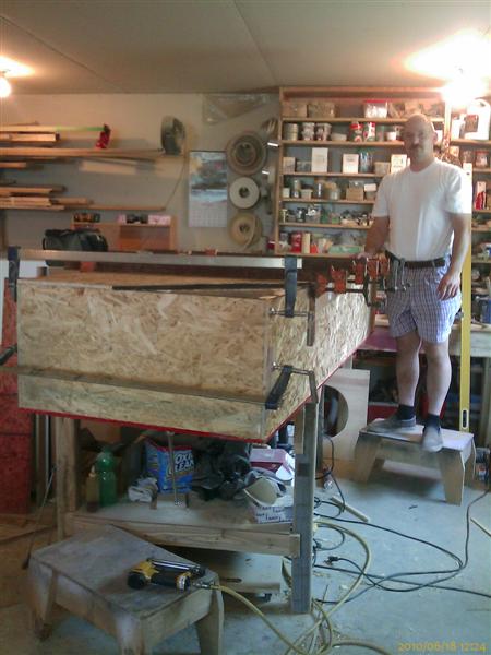

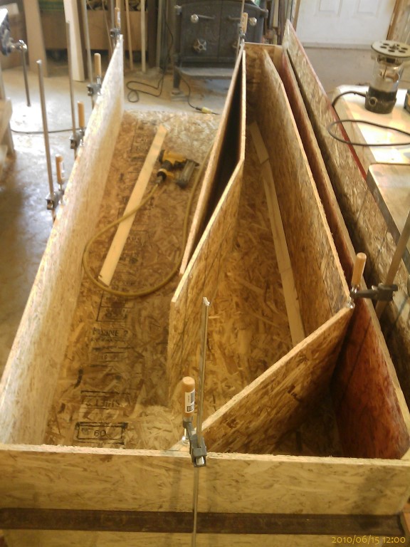

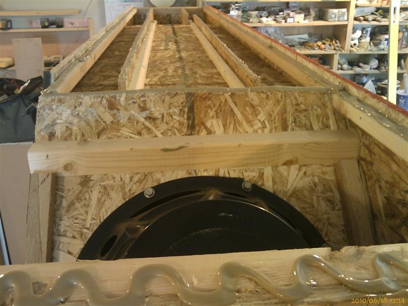

And which client had you design a tapped horn sub so large that it had to lifted into his attic with a front end loader through a hole cut in the eaves 🙂
First off it's a front loaded horn. Tapped horns are not my cup of tea. They colour the sound way to much. Second that is a set of plans that I make available for a modest fee. I should really put them up on my website. It's a 14 hertz F3 20 plus foot long front loaded horn that rocks the worlds of quite a few people. I really had fun demonstrating that!

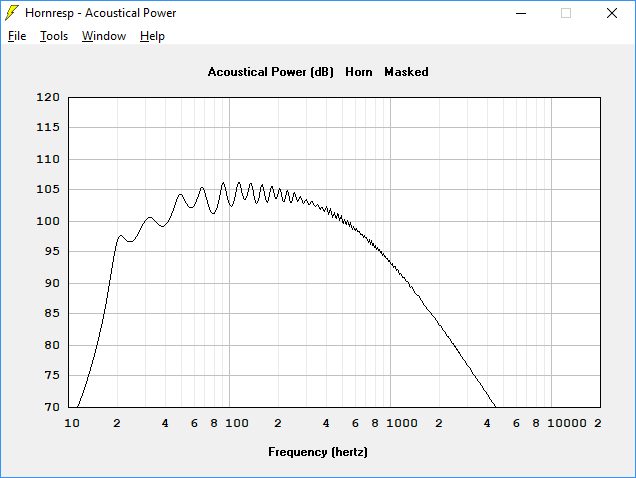

Dayton Audio PA310-8 12" Pro Woofer
This one is just fine and will knock the socks off of most subwoofers with only a few watts input.
One watt with 2 Pi loading.
60 watts achievable with 18 hertz highpass.

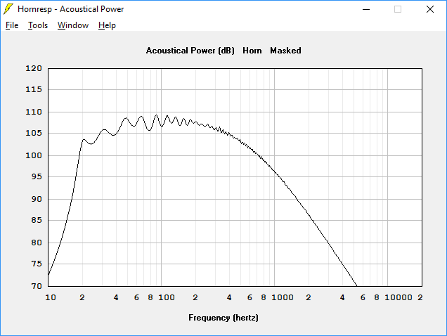

And One watt 1 Pi if you are in a basement.
