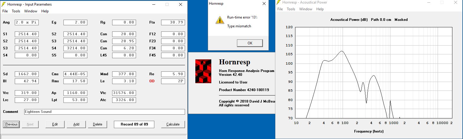

Hi David
Was trying to run a filter wizard from the acoustical power window and HR crashed
Made a screen shot of all the parameters in use. I have not managed to find what it does not like yet. Some OD types worked, others did not, and crashed.:(
Put a fresh copy of HR on the desktop imported the record and it crashed again so attached that file as well.

Hi David
Regards
Martin
Hi Martin,
Many thanks for providing such comprehensive information, it makes it much easier for me to track down these sorts of problems.

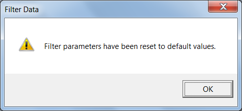

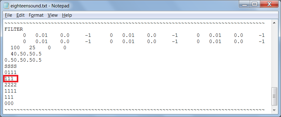

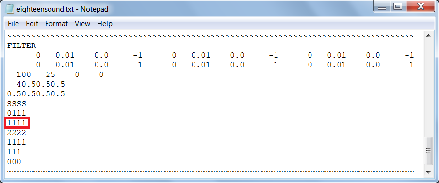

By way of explanation, there were some issues with filter data not being saved correctly when created using older versions of Hornresp. Your test record has the filter data shown in Attachment 1. Notice how there are only three characters in the string enclosed by the red box (there should be four).
The easiest way to fix the problem is simply to press the F8 function key when the corrupted record is in Edit mode. This will reset the filter parameters to their default values and you should see the confirmation message shown in Attachment 2. The filter data in the record will then be as shown in Attachment 3, and the Filter Wizard tool should now work correctly.
The F8 feature was added some time ago when the problem of filter data corruption became a growing concern.
