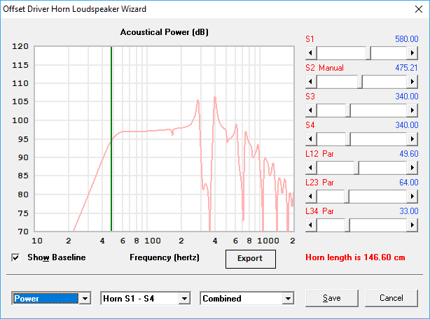

Ok, this should be a simple one, but I'm not seeing the answer - how do I export the sim'd FR for a stuffed horn? I can export the sim'd FR for an unstuffed one, but the export option only appears after I select "Calculate", and it looks like the only place that the sim'd FR for the stuffed horn is available is under the "Loudspeaker Wizard".
Hi Brian,
It can't be done.
Correct. The way that Hornresp has evolved it would require just too much work to now include the absorbent filling feature as part of the main calculations. Exporting the response direct from the Loudspeaker Wizard could be a possible alternative, but that would also require significant effort to implement.

Sigh - I figured as much. I wanted to compare the measured FR of my POC6 MLTL (which uses some stuffing at S1) to the Hornresp sim, and then realized there was no easy way to compare it. There's no top menu in the Loudspeaker Wizard, much less an option in the menu to export the data...

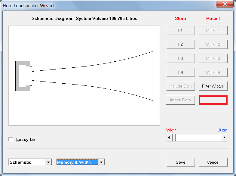

Maybe the export routine can be called by an additional button inserted as per the attached example? 🙂
Hi Brian,
I had a closer look at the code last night - exporting direct from the Loudspeaker Wizard appears to be a "doable" project. The Export button would be located on the 'Memory & Width' window, most likely in the position indicated by the red rectangle in the attached screenprint (the F9 shortcut key could also be pressed from any window, rather than having to actually click the Export button).
If all goes according to plan it should be possible to export the values of frequency, acoustical power, electrical impedance, diaphragm displacement and standard wrapped phase.
I will see what can be done for the next release...
EDIT -
I see that Mark mentions .frd files. I had intended just providing .txt and .csv options as is currently done - would this be okay?

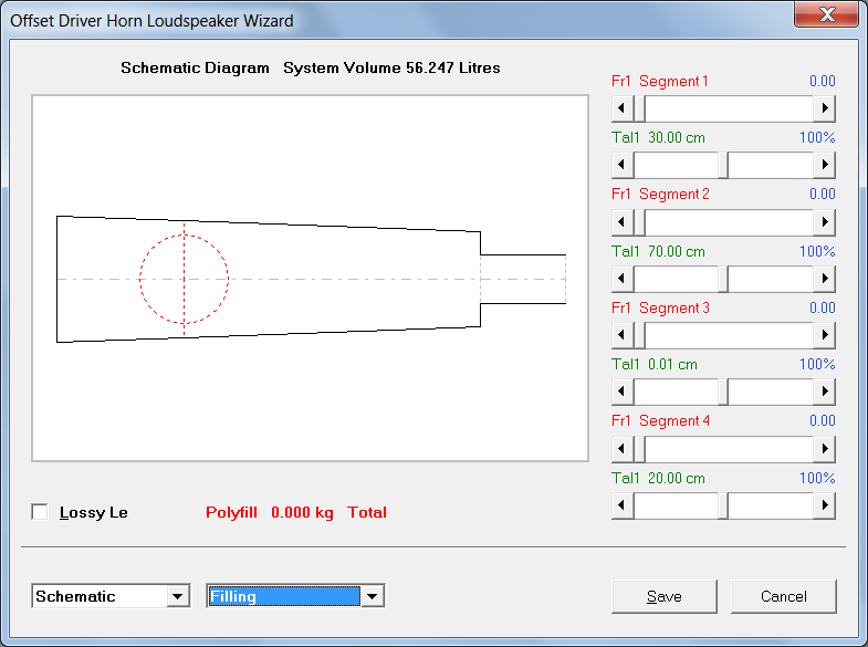

The Input Wizard under the Hornresp Help menu can be used to generate an illustrative example of a mass loaded transmission line design that can then be modified as required. The Loudspeaker Wizard tool can be used to add absorbent filling material to the design.

Thank you David. Tried Google, couldn't find any on MLTL . There were a few on other versions of horns. However, the pictures for them are gone.
I was concerned because when it comes to simulation it is pretty much garbage in = garbage out. And you are none the wiser.😱 So I am just being extra careful that I key in the parameters properly and I understand what the parameters are that I am keying in.
I was trying out based on the tutorial on the tap horn, then I realised that tap horns are quite different animal and I had probably screwed up. So I just want to be doubly sure that I am doing it properly.
I will try the wizard out.
Is there any worked out example out there that I could sort of verify to know that I had actually done the procedure correctly? Sometimes the stupidest mistakes happen. wrong units, diameter for area etc.
