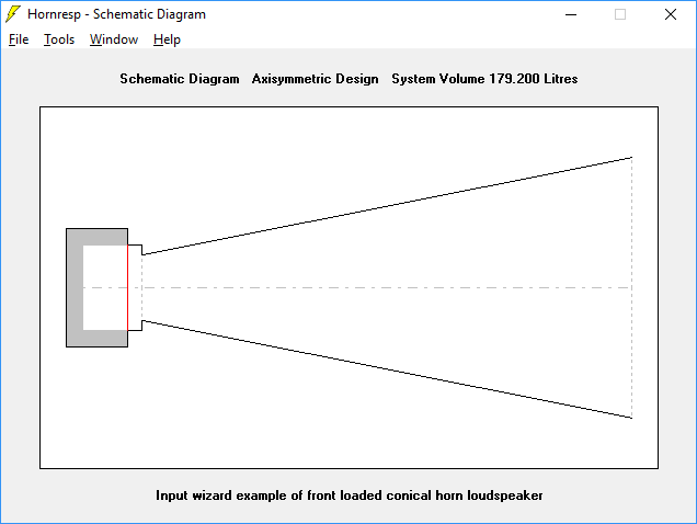

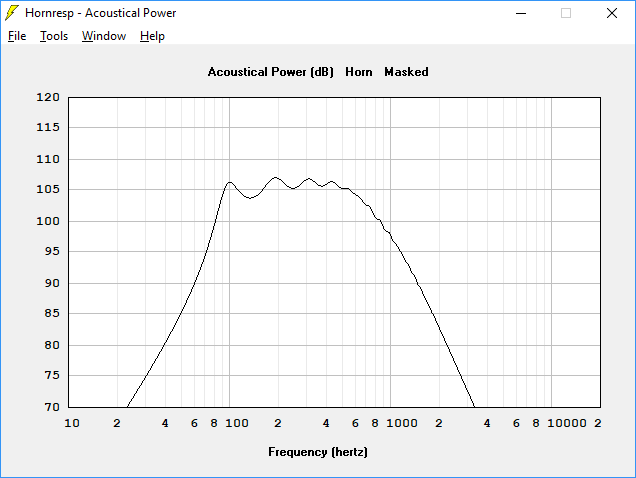

There are differences:
Conical horn is first:
Shape of the horn.
Frequency response.

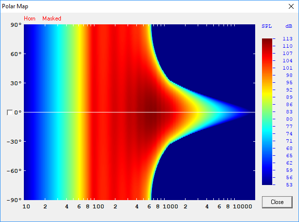

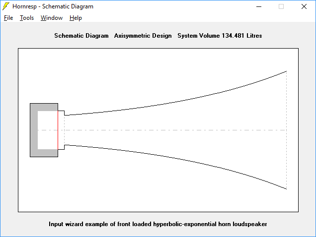

Hypex horn:
Shape.
Frequency response.
Polar pattern.

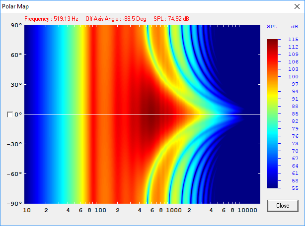

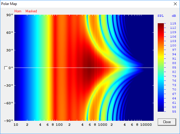

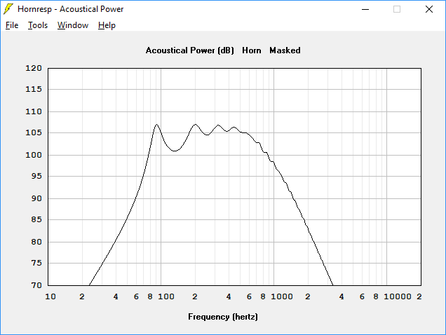

If you generate the polar pattern in Hornresp you will see that at the areas where there is a severe null. Over 20 db actually. And these nulls are at octave intervals. The first one from the left is at 519 hertz and next one is at 1049 hertz. You can't EQ these out effectively.
And there are some simple facts in music. The greatest amount of musical information is below 1000 hertz. The rest is of our hearing range is useful and required to generate spatial information about where objects are. And there is the required harmonics information above this frequency area. But the business of making music resides mostly below one kilohertz.
Those nulls are the biggest reason why a conic is not that great compared to other horn shapes.
Within hornresp one does not see a compelling reason to NOT use the conical flare in the 90 to 500 Hz range. All of the "windows" look about the same for both hypex and conical. Of course, I know there is more magic involved in making a good horn than getting a nice response curve with hornresp. But it does point you in the right direction!
Does a stepped conical to approximate hyp also have null issues?
Less.
Sometimes none. It depends on the number of steps and their location in the horn path length.
I have to point out that I took the test file included in Hornresp, pressed the Help button and auto generated a conical and hypex horn from the original data. It could have been optimized a bit more either way. But the nulls are always present in a straight conical horn.
To see the fancy colour chart you can go from the Acoustical Power page press tools, directivity, polar map. The map starts to make sense when you study it a bit. And you can move your cursor over the chart and see the spl response. On the right hand side there is a vertical colour versus SPL chart that shows what the colours mean. Blue is the lowest SPL red is the highest.
adding termination, e.g. roundovers or a secondary flare, to a conical may be an easier way to improved polars than a stepwise approx to a hypex.
