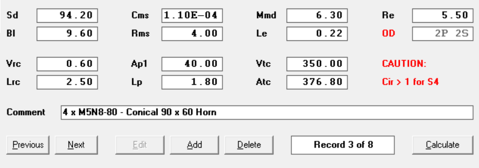

Hi all,
I’d like to clarify something about modelling multiple drivers in Hornresp.
In the attached screenshot, all the entered chamber parameters result in optimal modelled performance (e.g. frequency response, phase response, driver displacement, etc.) for the project I’m working on, which is a midrange multiple entry horn.
What I’m not sure about, however, is whether the chamber parameters are correct for each of the 4 drivers, or whether they are correct for a hypothetical driver with 4 times the Sd of a single driver.
In other words, when building the design, do I want to build (for example) a rear chamber of 0.6 litres for each driver, or a rear chamber of 0.15 litres for each driver? Should (for example) the average throat chamber area be 376.8cm2 or 94.2cm2 per driver? I presume the latter is correct in both cases, but I’m not sure.
And ofc I have the same question in respect of all the chamber parameters, i.e. Vrc, Lrc, Ap1, Lp, Vtc, Atc.
Many thanks for your help 🙂
Cheers
Andreas

Sorry, I should have said multiple driver horn - not multiple entry horn (the horn uses four identical drivers which enter at the same axial point along the horn, although ofc at different points around this axis; think of something like just the midrange section on a synergy horn).
EDIT: could I also take this moment to thank David for his incredible piece of software 🙂

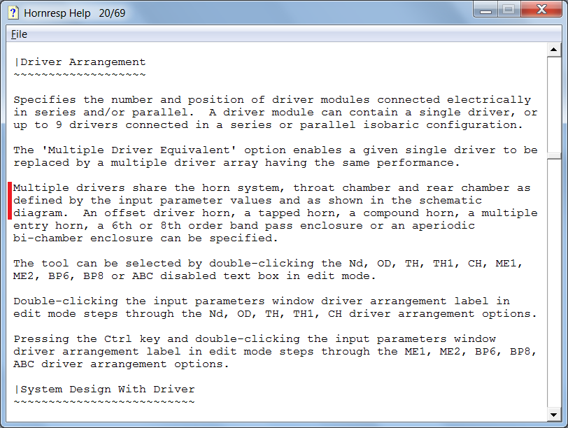

Hi Andreas,
The answer is in the Hornresp Help file 🙂.
"Multiple drivers share the horn system, throat chamber and rear chamber as defined by the input parameter values and as shown in the schematic diagram."
The built rear chamber volume should be 0.15 litres for each driver.
The built average throat chamber area should be 94.2 cm2 for each driver (* Note that the throat chamber length remains constant at 0.93 cm).
Nothing changes, the principle remains the same. Hornresp chamber volumes and areas (Vrc, Ap1, Vtc, Atc) are total system values, shared across the multiple drivers. Hornresp chamber lengths (Lrc and Lp) remain constant, not affected by the number of drivers *.
Built values:
Vrc(B) = 0.60 / 4 = 0.15 litres
Lrc(B) = 2.50 cm *
Ap1(B) = 40.00 / 4 = 10.00 cm2
Lp(B) = 1.80 cm *
Vtc(B) = 350.00 / 4 = 87.50 cm3
Atc(B) = 376.80 / 4 = 94.20 cm2
Ltc = 350.00 / 376.80 = 0.93 cm
Ltc(B) = 87.50 / 94.20 = 0.93 cm (no change) *
To summarise - when building the system simply divide the Hornresp chamber volumes and areas by the number of drivers and leave the lengths unchanged.
Kind regards,
David

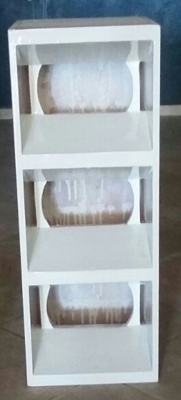

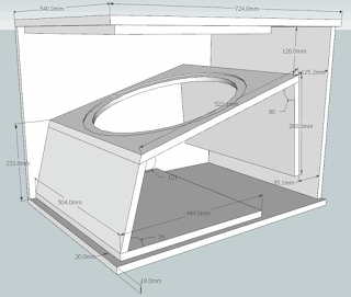

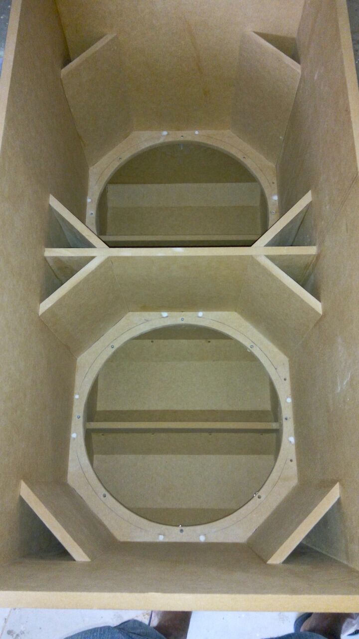

Hello David, how are you? I hope so.
First of all, I want to say First of all, that it is a great pleasure to have met you here, always clarifying as many doubts as possible about this incredible soft.
I always come across with some doubt and today was about this third option of rear camera. I would like to know if it is suitable for these enclosures I attached. If not, let me know how to do it, if possible. Thanks!

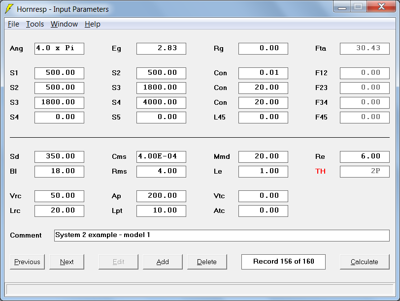

Hi M1 Audio,
The systems shown in your Attachments 1 and 4 could perhaps be modelled as tapped horns with large throat chambers (see my attachment below).
The systems shown in your Attachments 2 and 3 would probably need to be modelled using AkAbak.
Kind regards,
David

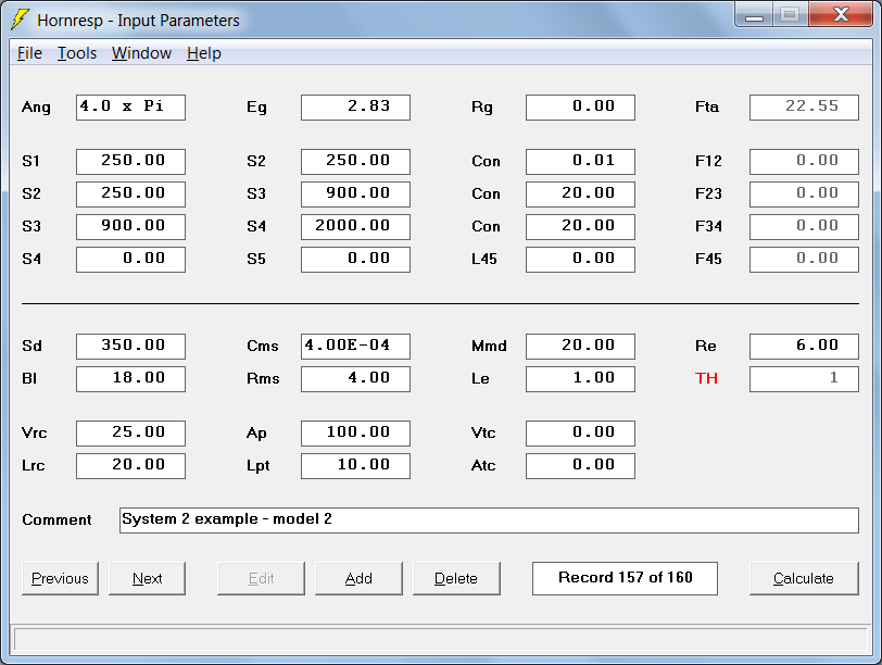

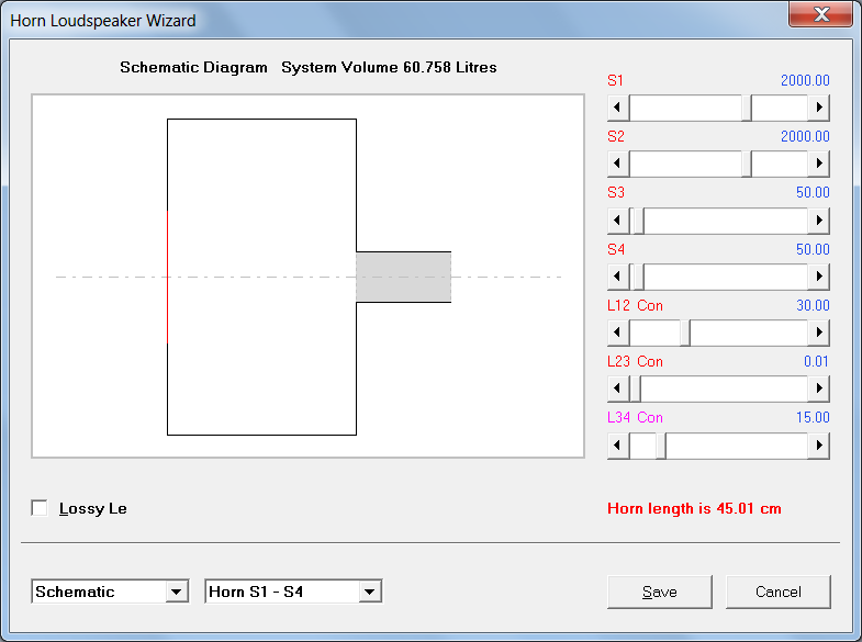

Hi M1 Audio,

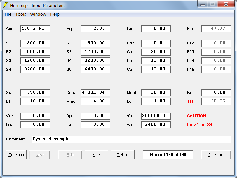

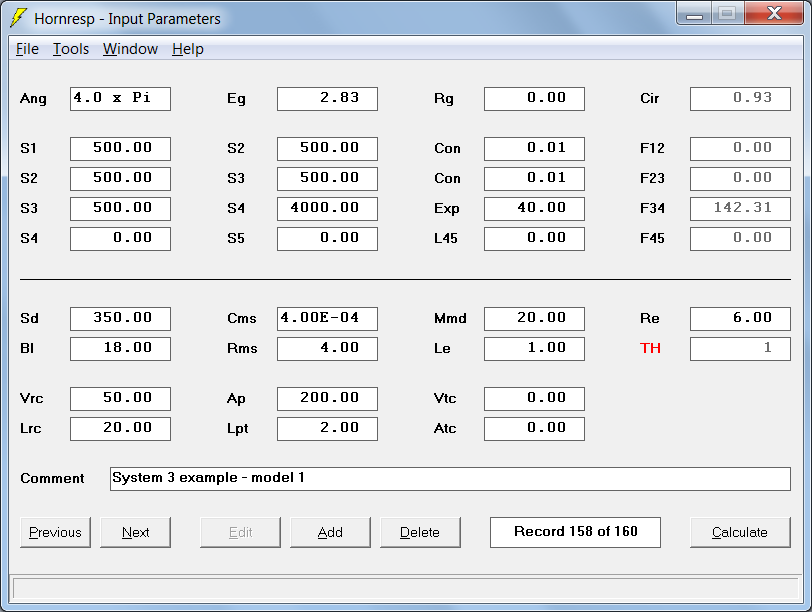

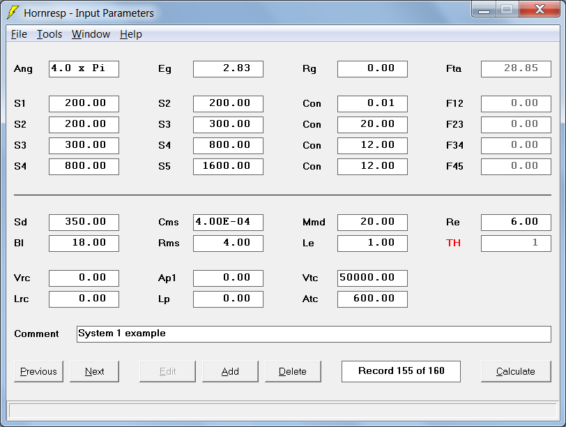

After having another look at the loudspeaker systems shown in your Post #7936, if I am interpreting the designs correctly, it appears that it may be possible to simulate all four in Hornresp as different variants of tapped horns.
SYSTEM 1 - Simulate as shown in Attachment 1.
(Values for Ap1 and Lp can also be specified, if so desired).
SYSTEM 2 - Simulate as shown in Attachment 2 or in Attachment 3.
If simulated as shown in Attachment 3 (Model 2 considers half the total system and one driver) use the Multiple Speakers tool to specify the complete system as 2 speakers in parallel.
SYSTEM 3 - Simulate one of the 3 horn cabinets as shown in Attachment 4 or in Attachment 5.
Use the Multiple Speakers tool to specify the 3 cabinets making up the complete system.
SYSTEM 4 - Simulate as shown in Attachment 6 or in Attachment 1.
If simulated as shown in Attachment 1 use the Multiple Speakers tool to specify the complete system as 2 speakers in series together with 2 speakers in parallel.
Kind regards,
David
