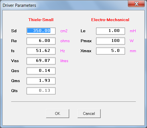

Hornresp will calculate it for you. Double click the Rms input box and a wizard will help you, allowing you to enter Fa and Qms instead of Rms and Hornresp will sort out the rest.
Most of the input boxes have wizards to help you and there's always handy info about the input box at the bottom of the Hornresp window if you hover your mouse over the box.
Alternatively, double-click on the Sd input box in Edit mode to enter all the driver parameters in the one operation, using Thiele-Small values.

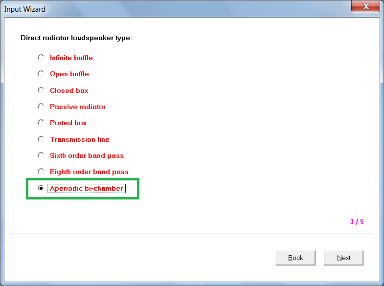

I should have also mentioned that another way to specify an ABC system is simply to create a new record using the Input Wizard tool, located under the Help menu.

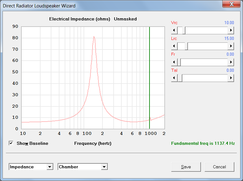

When simulating a direct radiator in a closed-box enclosure with the 'resonances not masked' option selected, the fundamental resonance frequency marker line in the Loudspeaker Wizard was not being shown in the correct position (see Attachment 1).
This has now been fixed (see Attachment 2).
