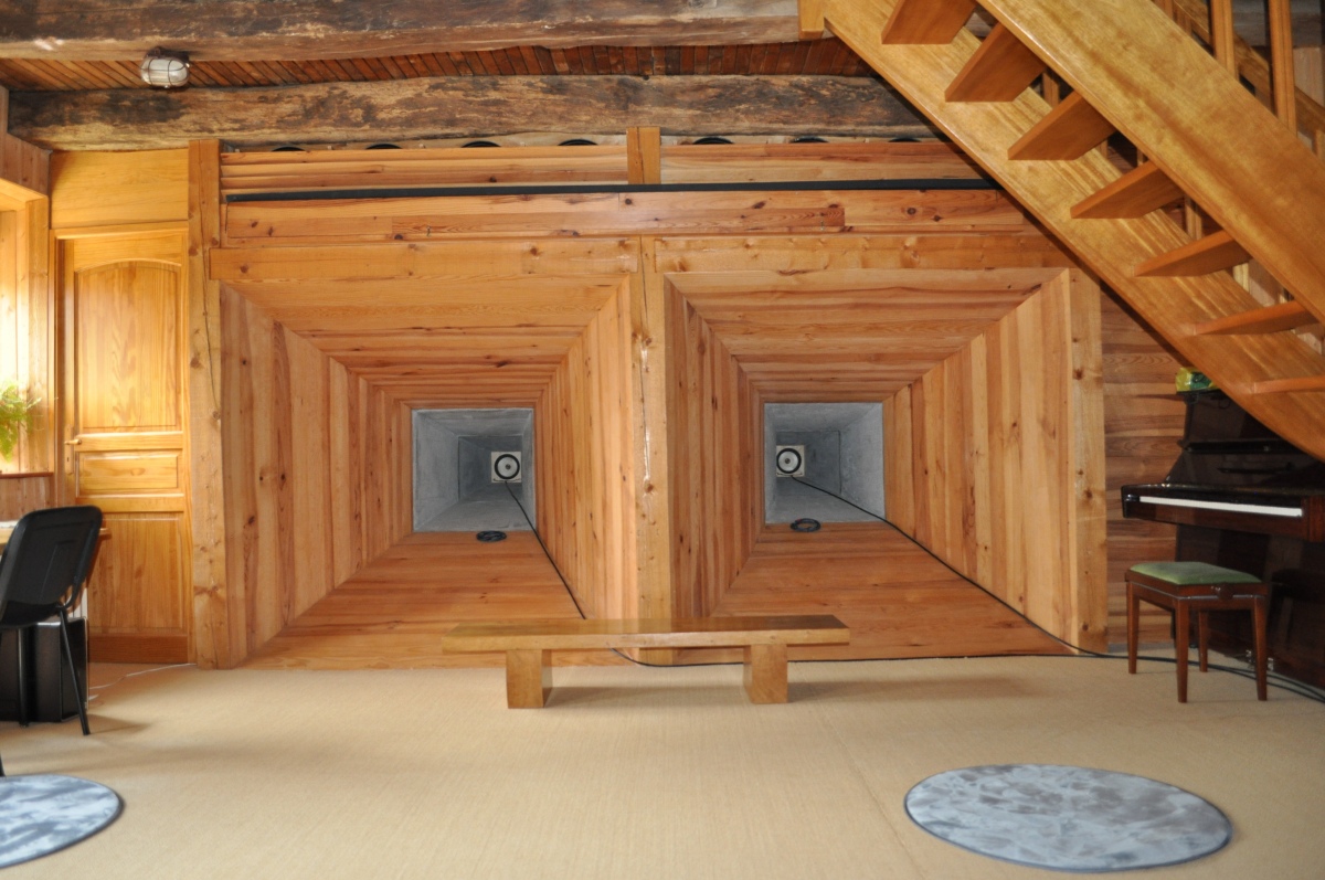

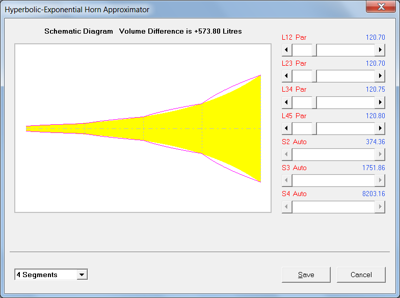

These are examples of exponential subwoofer horns. If you are not building something similar, then you need to be modeling a parabolic enclosure.
The second example appears to be a tractrix or spherical wave horn - the mouth flare tangent angle is close to 90 degrees.
Just to clarify, the above statement only applies to horns with two parallel sides - in which case the system needs to be modelled using multiple parabolic segments to approximate the desired overall exponential profile (see attachment). A single-segment parabolic horn would not be a good design choice for a bass system 🙂.
The pic was to show that all sides expand in an exponential horn whether round or square. Here is a better example for a round exponential horn.
Kinda looks like a conical horn there buddy
More like a conical megaphone - complete with handle. A bit small to be used as a subwoofer, though 🙂.

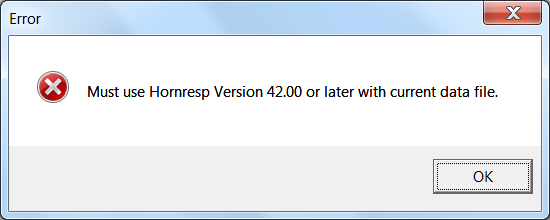

Hello David
I updated last But why does not it go back? V.40 Now i use V.42
Hi Piyapong38,
I assume you are seeing the attached message.
The format of the data file was changed when Version 42.00 was released. Modifications made to the Maximum SPL tool as part of the update meant that additional information (maximum amplifier output power, voltage and current) needed to be permanently saved to the data file.
Your existing Hornresp.dat file was automatically updated to the new format.
Your old Version 40.00 can detect that the data file has changed but it has no way of knowing what the changes are, so to prevent errors and possible file corruption it displays the message below and will not open the file. I strongly recommend that you delete any earlier versions of Hornresp that you may have, and only use the current release Version 42.30. Significant improvements have been made since Version 40.00 was released.
